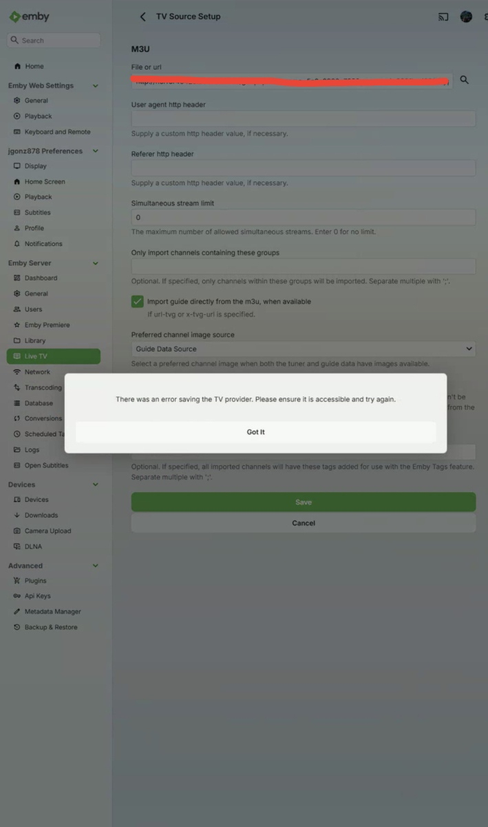

jgonz878 4 Posted September 28, 2025 Posted September 28, 2025 (edited) I previously had two M3U URLs set up in Emby and removed them, but now Emby won’t accept any of my M3U links. I know the URLs themselves are working because they load fine in other apps. Is anyone else running into this issue? Any ideas on what the fix might be? Edited September 28, 2025 by GrimReaper URL masked
jgonz878 4 Posted September 28, 2025 Author Posted September 28, 2025 (edited) I previously had two M3U URLs set up in Emby and removed them, but now Emby won’t accept any of my M3U links. I know the URLs are working because they load fine in other apps like VLC and several other IPTV players. I also manage an IPTV panel, so I can create M3U Xtream accounts and check for blocks and my account isn’t blocked. Now Emby won’t allow me to put any m3u. Is anyone else running into this issue? Any ideas on what the fix might be? Edited September 28, 2025 by GrimReaper URL masked

Happy2Play 9811 Posted September 28, 2025 Posted September 28, 2025 Dev will have to comment further as I don't know the error. 2025-09-28 16:02:53.805 Error Server: Error processing request *** Error Report *** Version: 4.8.11.0 Command line: C:\Users\jgonz\AppData\Roaming\Emby-Server\system\EmbyServer.dll -noautorunwebapp Operating system: Microsoft Windows 10.0.22631 Framework: .NET 6.0.36 OS/Process: x64/x64 Runtime: C:/Users/jgonz/AppData/Roaming/Emby-Server/system/System.Private.CoreLib.dll Processor count: 4 Data path: C:\Users\jgonz\AppData\Roaming\Emby-Server\programdata Application path: C:\Users\jgonz\AppData\Roaming\Emby-Server\system MediaBrowser.Model.Net.HttpException: MediaBrowser.Model.Net.HttpException: 884 at Emby.Server.Implementations.HttpClientManager.CoreHttpClientManager.SendAsyncInternal(HttpRequestOptions options, String httpMethod) at Emby.Server.Implementations.HttpClientManager.CoreHttpClientManager.SendAsync(HttpRequestOptions options, String httpMethod) at Emby.M3UTuner.M3UTunerHost.ValdidateOptions(TunerHostInfo tuner, CancellationToken cancellationToken) at Emby.LiveTV.LiveTvManager.SaveTunerHost(TunerHostInfo info, CancellationToken cancellationToken) at Emby.LiveTV.Api.LiveTvService.Post(AddTunerHost request) at Emby.Server.Implementations.Services.ServiceController.GetTaskResult(Task task) at Emby.Server.Implementations.Services.ServiceHandler.ProcessRequestAsync(HttpListenerHost httpHost, IServerApplicationHost appHost, IRequest httpReq, IResponse httpRes, IStreamHelper streamHelper, RestPath restPath, String responseContentType, CancellationToken cancellationToken) at Emby.Server.Implementations.HttpServer.HttpListenerHost.RequestHandler(IRequest httpReq, ReadOnlyMemory`1 urlString, ReadOnlyMemory`1 localPath, CancellationToken cancellationToken) Source: Emby.Server.Implementations TargetSite: Void MoveNext()

Luke 42239 Posted September 30, 2025 Posted September 30, 2025 HI, your provider is sending back an 884 response code when trying to access the url. Can you ask them why?
jgonz878 4 Posted September 30, 2025 Author Posted September 30, 2025 Hi Luke, I manage the IPTV panel myself and can block or unblock access to any URL. I’m not blocking myself; everything works fine with VLC and many other IPTV apps. I’ve tried five or more different IPTV providers, and the same issue persists. I believe there’s something wrong with my Emby account; something internally is blocking me.
Luke 42239 Posted September 30, 2025 Posted September 30, 2025 OK, so why is the content server sending back an 884 error response? We need to know the answer to that in order to figure out how to proceed.
Luke 42239 Posted September 30, 2025 Posted September 30, 2025 3 minutes ago, jgonz878 said: I believe there’s something wrong with my Emby account; something internally is blocking me. It is nothing related to an Emby account. You can see it plain as day in the server log. Server sends request to the m3u url, then gets back an error response: 2025-09-28 10:34:42.384 Info HttpClient: GET http://horror45423.cdn-akm.me/x_path1_x?username=x_secret5_x&password=x_secret6_x&type=m3u_plus&output=ts 2025-09-28 10:34:42.765 Error Server: Error processing request *** Error Report *** Version: 4.8.11.0 Command line: C:\Users\jgonz\AppData\Roaming\Emby-Server\system\EmbyServer.dll -noautorunwebapp Operating system: Microsoft Windows 10.0.22631 Framework: .NET 6.0.36 OS/Process: x64/x64 Runtime: C:/Users/jgonz/AppData/Roaming/Emby-Server/system/System.Private.CoreLib.dll Processor count: 4 Data path: C:\Users\jgonz\AppData\Roaming\Emby-Server\programdata Application path: C:\Users\jgonz\AppData\Roaming\Emby-Server\system MediaBrowser.Model.Net.HttpException: MediaBrowser.Model.Net.HttpException: 884 at Emby.Server.Implementations.HttpClientManager.CoreHttpClientManager.SendAsyncInternal(HttpRequestOptions options, String httpMethod)

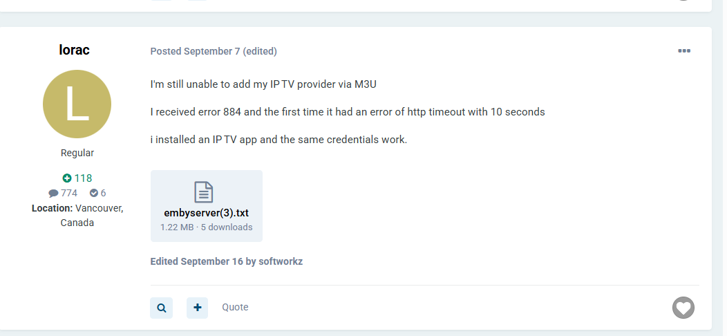

jgonz878 4 Posted September 30, 2025 Author Posted September 30, 2025 Believe me, I've used my server for over a year and have semi mastered it until this. I cant figure it out and to delete and start over with all my libraries and users, would suck. I also saw on one of your recent post regarding using the latest version of 4.9 plus and using webpluggins tried that same error 884 with no. There's another user having the same issue as me, I reached out to him and he hasn't had luck either.
