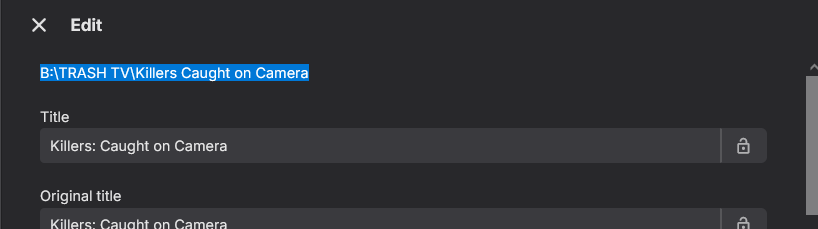

beefsnack 17 Posted September 25, 2025 Posted September 25, 2025 So The Nightmare is real, Lost another HD, and I'm working on the dreaded replacement files (no I'm not working with a Raid) so I'm replacing the files but I'm not deleting the old Folder because I like the way EMBY keeps the old images blank showing me whats missing (hoping this isn't my biggest problem), so my issue is that now that I've created the new location and replaced the files Emby wont update it's location and change, it still reads it as it's old location even after I've done a replace metadata and search missing and done full scans, but it will show new episodes in that new folder, but not the old redirected ones, anything I can do to change the folder directory without removing the entire folder from the lists? TIA..
GrimReaper 4926 Posted September 25, 2025 Posted September 25, 2025 Are those items being multi-versioned maybe? Do you see a version dropdown in any item detail view?
beefsnack 17 Posted September 25, 2025 Author Posted September 25, 2025 (edited) @GrimReaperThat would be a Negative, It still shows the old location when I bring up edit metadata, and of course the image is still blank and I still get the playback error but I know for a fact that the folder is in the list and its been scanned and verified as well. Edited September 25, 2025 by beefsnack
beefsnack 17 Posted September 25, 2025 Author Posted September 25, 2025 this is where it was, and I moved it to a completely different HD I was hoping EMBY was going to just redirect the folder because it's already in the system, I know if I remove the folder altogether my problem will solve itself, but I can't ATM, Any ideas on how I might go about doing this without deleting the folder ?

Luke 42289 Posted September 25, 2025 Posted September 25, 2025 Hi, what you need to do is remove the old location from emby library setup and then add the new one. There is currently no way to remap an existing library to a new folder, although that is on our to do list.
