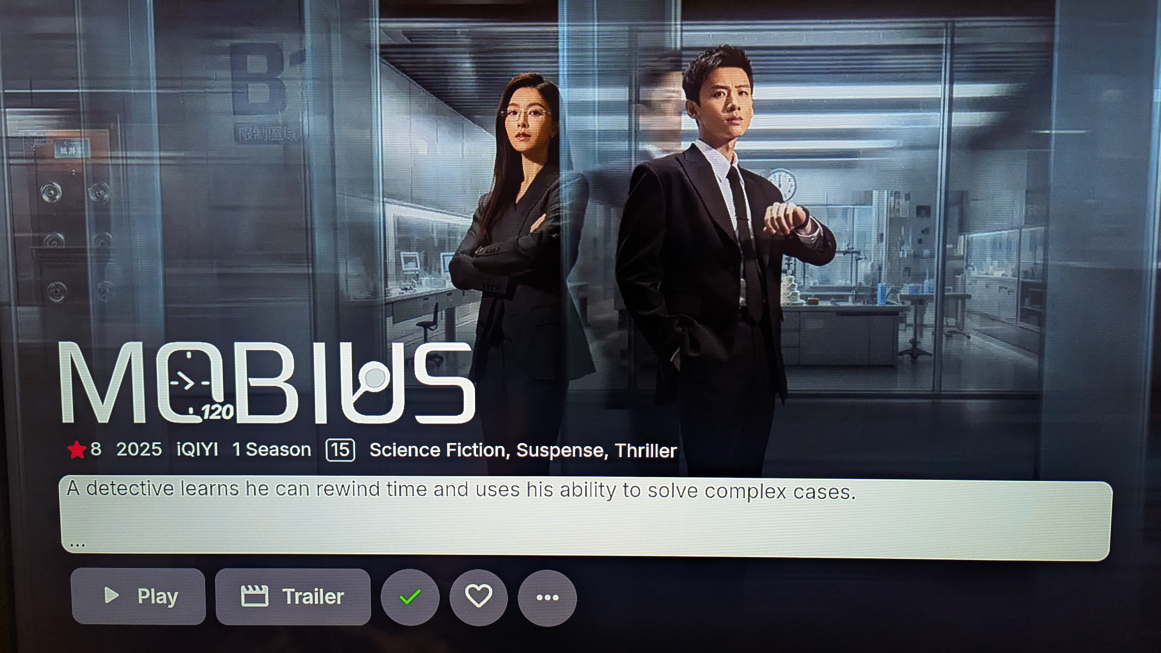

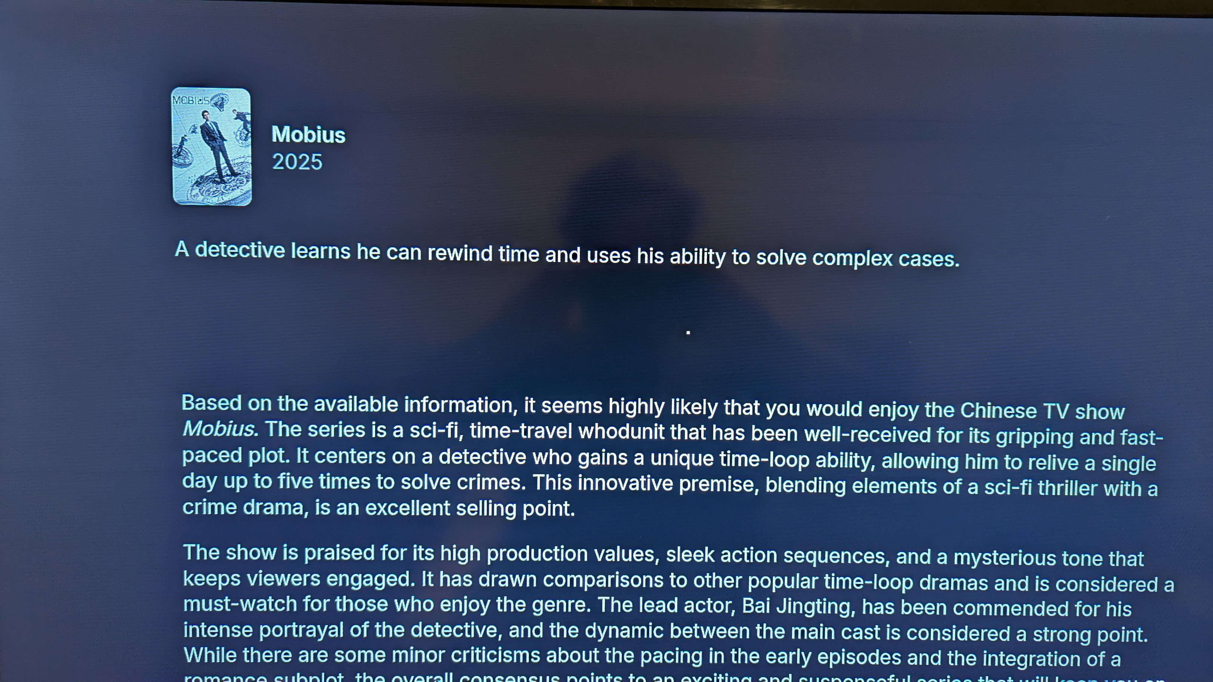

tOLJY 52 Posted September 26, 2025 Author Posted September 26, 2025 Basically, I'm trying to set up a python script which looks at my library and watchlist and makes reccoemndations by adding stub files to a Reccoemndations library I've made up. I pretty much want the series screen to look like normal with the outline/plot, but then on the expanded view include some text on why I might like it, based off how it was found/what AI thinks. Pictures for reference. 1
