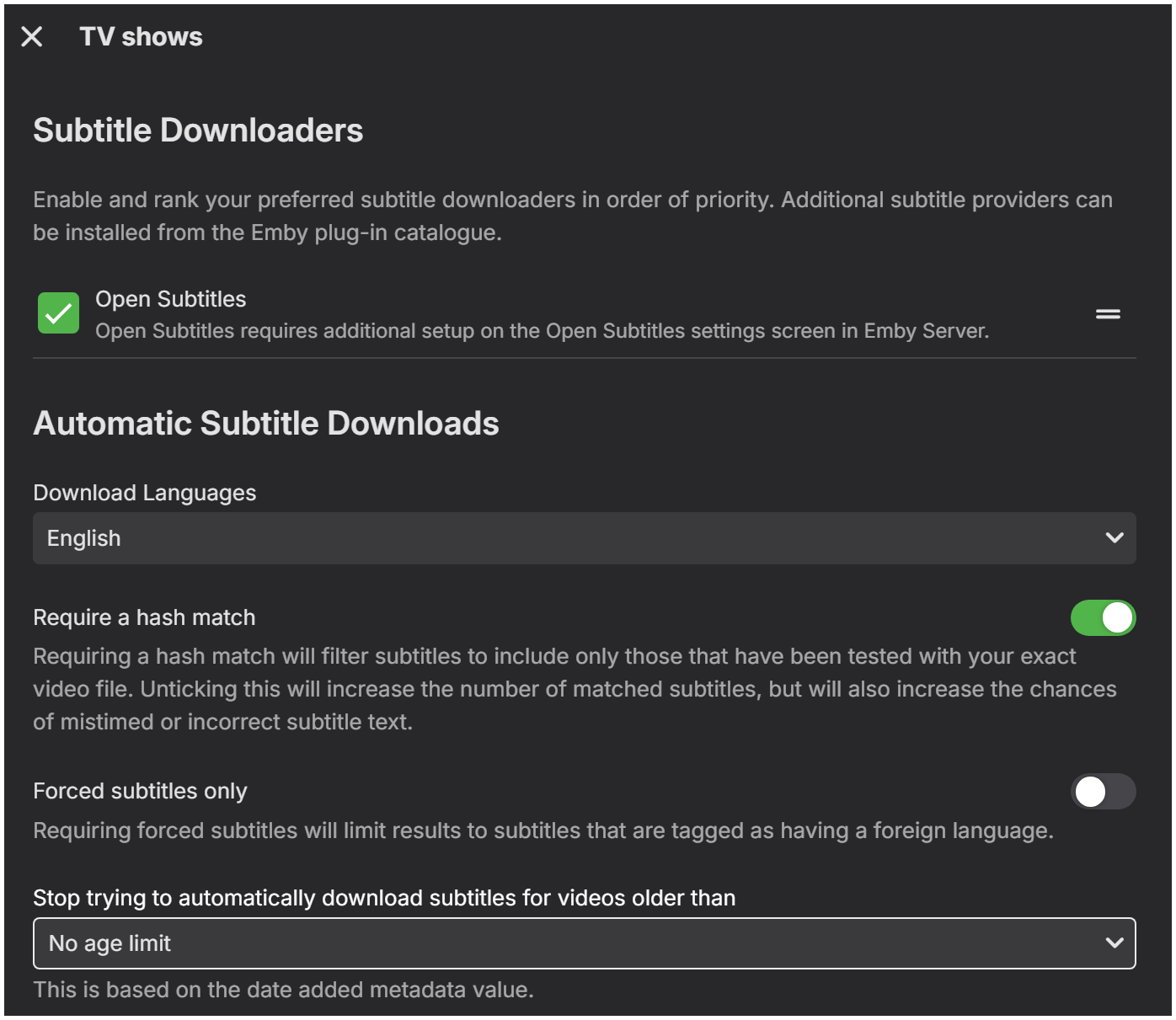

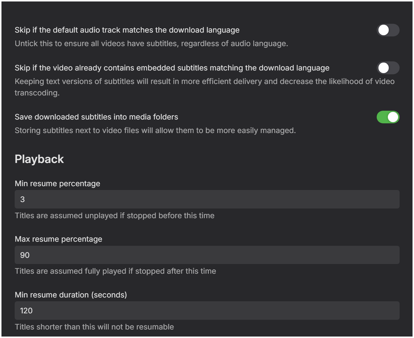

bobaldis 24 Posted September 22, 2025 Posted September 22, 2025 Hi, I've got a Subtitle issue, but just may be my (mis)understanding of how it all works under Emby, so at this point just after a little better understanding. Background: Subtitles appear to be working OK generally, have Open Subtitles set-up to automatically download them, but have a series I'm watching Invasion S01, where I'm having to manually download them for each episode, there is nothing on the episode main screen regarding subtiles, where as on other series I see either the Subtitle to play or actually "Off" (not sure why it is off but it does show it), but there is literally no "subtitle" text or info at all on the invasion episodes! Surmising/Thoughts: So with the Open Subtitles Task running in the logs I see GETs answered with 200 responses so believe everything that side is working well, but when I look in the folders for some series that show they have subtitles there are no SRT files: Is this because they are embeded and Emby recognises that so doesn't need to download them? Invasion does not follow the system settings and download subtites automatically, although there when I manually search What is likely to cause this behaviour? (I noticed it had a Subs subfolder which I've deleted in case it affected it, I've rescanned and refreshed metadata but no change.) How do I change this for the series so don't have to manually download them? Any help/Clarification on the process would be apprecited, I have tried searching and AI neither shed much light unfortuately. Thanks in anticipation Bob
Luke 42239 Posted September 22, 2025 Posted September 22, 2025 Quote Is this because they are embeded and Emby recognises that so doesn't need to download them? It could be. But it also could be due to the configured location for the subtitle downloads. How did you configure the automatic downloading?
bobaldis 24 Posted September 23, 2025 Author Posted September 23, 2025 7 hours ago, Luke said: It could be. But it also could be due to the configured location for the subtitle downloads. How did you configure the automatic downloading? Hi Luke, Thanks, please see my subtitle settings below, but would ask if possible to answer my questions above to help give me a little better understanding of the overall process

Luke 42239 Posted September 24, 2025 Posted September 24, 2025 HI, you have the hash match option enabled, so the automatic download is probably just not finding any matches.
bobaldis 24 Posted September 25, 2025 Author Posted September 25, 2025 On 24/09/2025 at 21:38, Luke said: HI, you have the hash match option enabled, so the automatic download is probably just not finding any matches. Hi Luke, Thanks, I don't think that's the issue, I turned off Hash match and it made no difference, it seemed to be disabled for this seasons downloads and not even looking for subtitles, that's why I'm trying to understand the process and what could cause that. As mentioned it initially it had a folder called Subs and within that folders with the same name as the episode filenames and within them multiple SRT files named with the languages EN, FR etc. but also as I mentioned I deleted these, but is it possible although Emby couldn't use them it set a flag or something that it had subtitles and therefore not to download any, again my lack of understanding of how it all hangs together is frustrating when trying to understand remedy the situation. I've finished watching that season now but had to manually download them each time, I'm hoping you/someone can shed some light so if this happens again I'll know what to do Thanks, Bob
