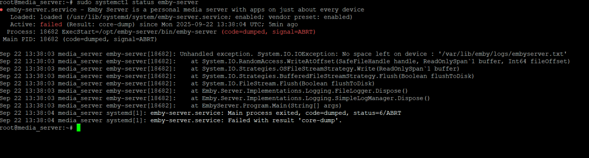

Sanbd 0 Posted September 22, 2025 Posted September 22, 2025 my emby server not working and its not start. this error show ● emby-server.service - Emby Server is a personal media server with apps on just about every device Loaded: loaded (/usr/lib/systemd/system/emby-server.service; enabled; vendor preset: enabled) Active: failed (Result: core-dump) since Mon 2025-09-22 13:38:04 UTC; 3s ago Process: 18682 ExecStart=/opt/emby-server/bin/emby-server (code=dumped, signal=ABRT) Main PID: 18682 (code=dumped, signal=ABRT) Sep 22 13:38:03 media_server emby-server[18682]: Unhandled exception. System.IO.IOException: No space left on device : '/var/lib/emby/logs/embyserver.txt' Sep 22 13:38:03 media_server emby-server[18682]: at System.IO.RandomAccess.WriteAtOffset(SafeFileHandle handle, ReadOnlySpan`1 buffer, Int64 fileOffset) Sep 22 13:38:03 media_server emby-server[18682]: at System.IO.Strategies.OSFileStreamStrategy.Write(ReadOnlySpan`1 buffer) Sep 22 13:38:03 media_server emby-server[18682]: at System.IO.Strategies.BufferedFileStreamStrategy.Flush(Boolean flushToDisk) Sep 22 13:38:03 media_server emby-server[18682]: at System.IO.FileStream.Flush(Boolean flushToDisk) Sep 22 13:38:03 media_server emby-server[18682]: at Emby.Server.Implementations.Logging.FileLogger.Dispose() Sep 22 13:38:03 media_server emby-server[18682]: at Emby.Server.Implementations.Logging.SimpleLogManager.Dispose() Sep 22 13:38:03 media_server emby-server[18682]: at EmbyServer.Program.Main(String[] args) Sep 22 13:38:04 media_server systemd[1]: emby-server.service: Main process exited, code=dumped, status=6/ABRT Sep 22 13:38:04 media_server systemd[1]: emby-server.service: Failed with result 'core-dump'. nginx also working . please help
Happy2Play 9811 Posted September 22, 2025 Posted September 22, 2025 To me it looks like you are out of hd space. No space left on device

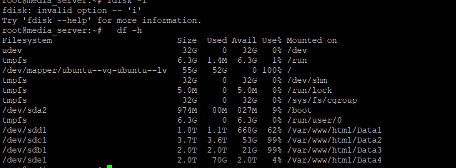

Lessaj 484 Posted September 22, 2025 Posted September 22, 2025 df -h /var/lib/emby/logs would show the mount the path is a part of but yea it's probably your root drive because that's 100% full which is really bad.
