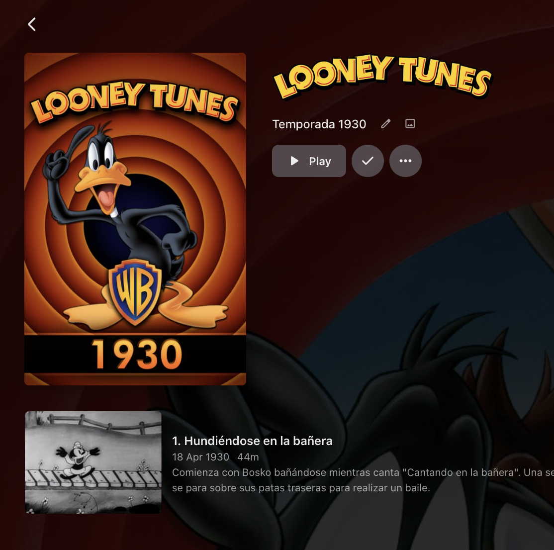

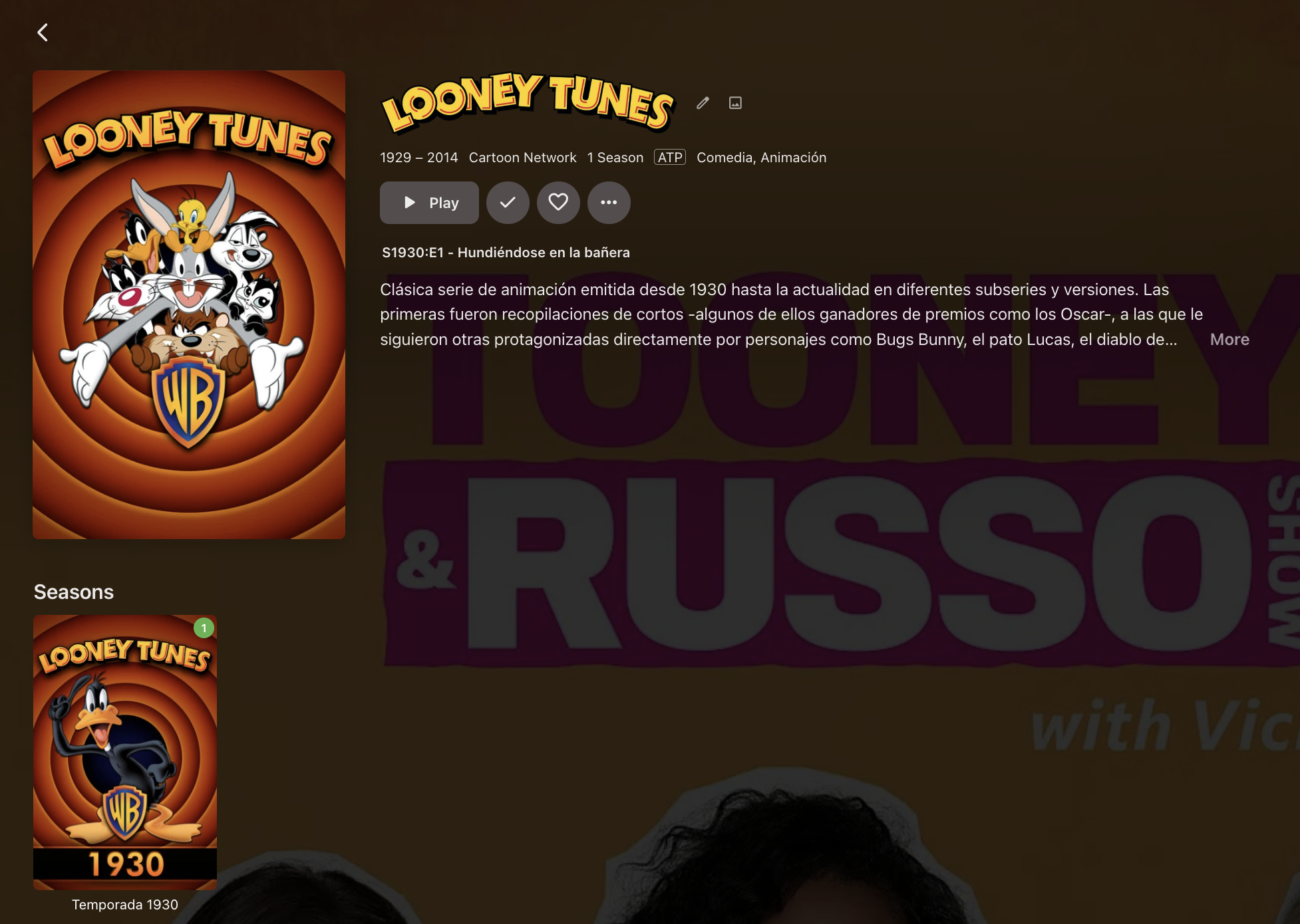

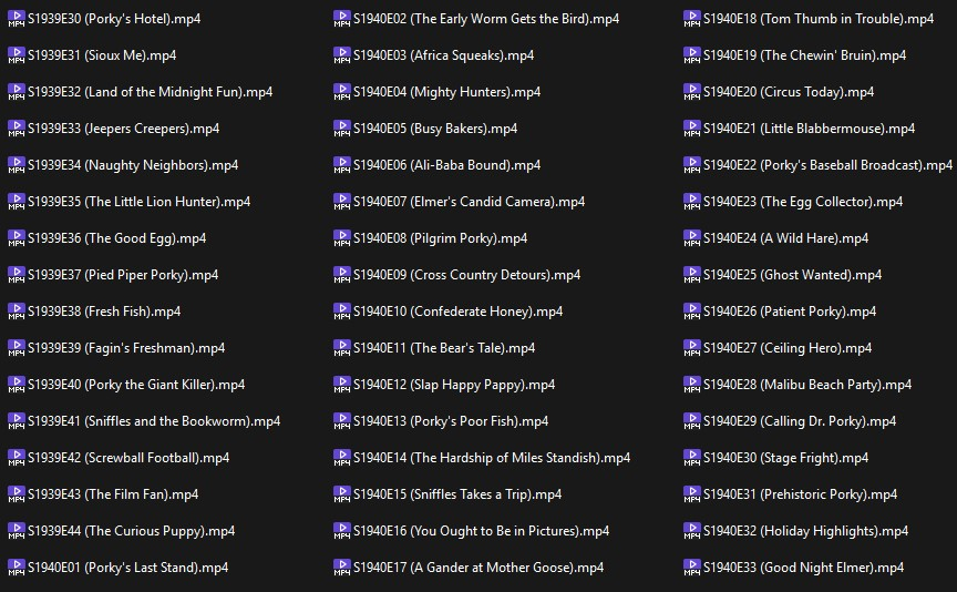

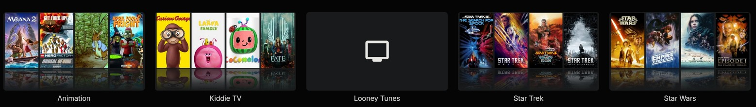

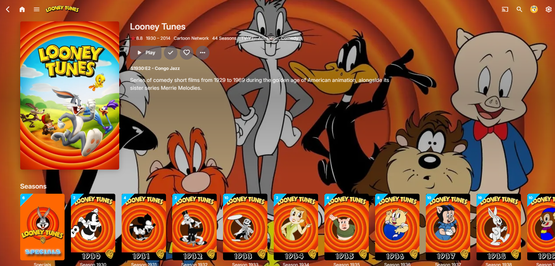

Starkraven420 3 Posted September 20, 2025 Posted September 20, 2025 (edited) Hello. Currently changing over from PLEX to Emby. First off, I did look at the format allowed for TV shows. The only TV files that traditionally have this naming are old cartoons....ie...Looney Tunes....and others. I know I may be screwed...lol. Took me about 3+ years to get this down the way I wanted that will work to look appealing....yes i'm slow....work too much to have time to play on pc. Second off, Is there anyway to implement this format style without renaming 1000 files? I know it's a longshot, but i've tried all formats that work and this here is the only one that looks best in server. Regards. Edited September 20, 2025 by Starkraven420 Typo
Abobader 3491 Posted September 20, 2025 Posted September 20, 2025 Hello Starkraven420, ** This is an auto reply ** Please wait for someone from staff support or our members to reply to you. It's recommended to provide more info, as it explain in this thread: Thank you. Emby Team
Luke 42289 Posted September 20, 2025 Posted September 20, 2025 HI, what is the problem? Those file names look OK to me. It just means you'll have season numbers of 1939 and 1940.
Starkraven420 3 Posted September 20, 2025 Author Posted September 20, 2025 I figured it doesnt work because Emby doesnt find my files
Starkraven420 3 Posted September 20, 2025 Author Posted September 20, 2025 Sorry, to clarify OP, those images are from PLEX

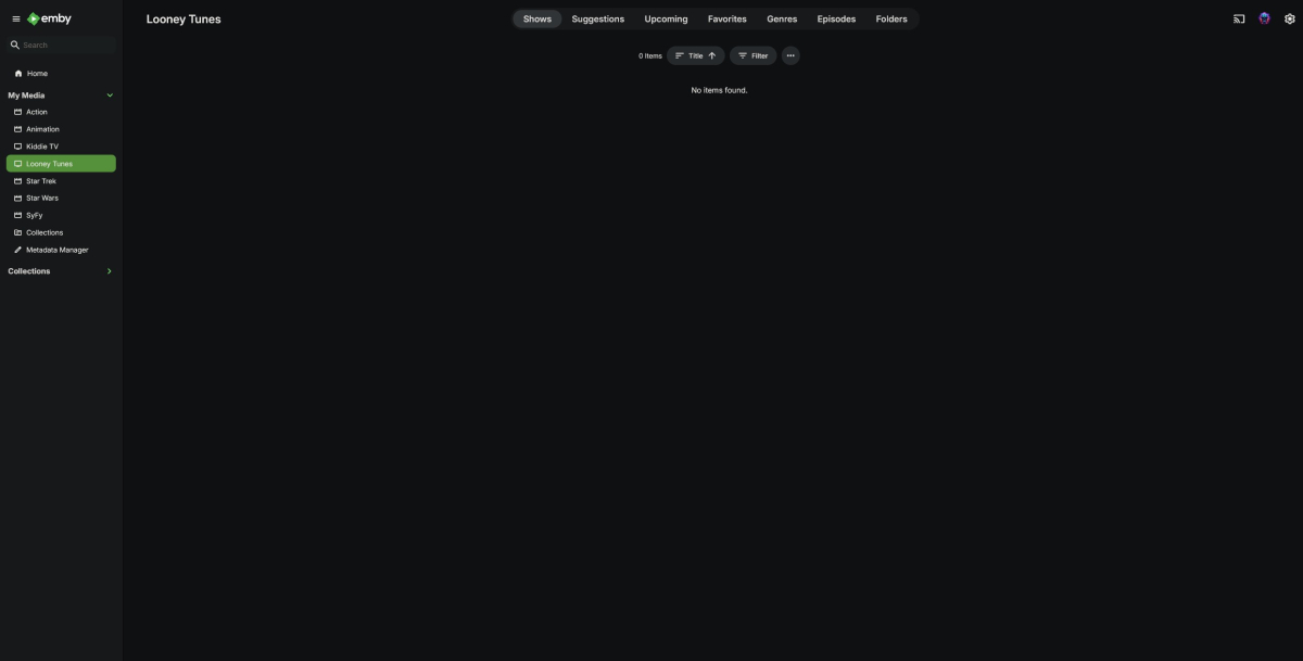

Starkraven420 3 Posted September 20, 2025 Author Posted September 20, 2025 I only have one folder named Looney Tunes "O:\Looney Tunes" with all media in that...no sub-folders. My log says it's working fine fetching everything. Creating as a stand alone library. But nothing shows up in my library. Weird. No worries as other TV shows and movies work. Just figured the formatting was wrong. Just weird that everything is fetching but nothing there. 2025-09-19 23:29:00.945 Info MediaProbeManager: ProcessRun 'ffprobe' Execute: C:\Users\strik\AppData\Roaming\Emby-Server\system\ffprobe.exe -i file:"O:\Looney Tunes\S1951E27 (Big Top Bunny).mp4" -threads 0 -v info -print_format json -show_streams -show_chapters -show_format -show_data 2025-09-19 23:29:01.017 Info MediaProbeManager: ProcessRun 'ffprobe' Process exited with code 0 - Succeeded 2025-09-19 23:29:01.018 Info QuickSingleImageExtractor: ProcessRun 'quick-extract-image' Execute: C:\Users\strik\AppData\Roaming\Emby-Server\system\ffmpeg.exe -f mp4 -threads 1 -i file:"O:\Looney Tunes\S1951E27 (Big Top Bunny).mp4" -map 0:2 -update 1 -vf "thumbnail=24" -vsync 0 -f image2 "C:\Users\strik\AppData\Roaming\Emby-Server\programdata\cache\temp\49f652b2-4ad0-496a-b037-1ed4b620447e.jpg" 2025-09-19 23:29:01.078 Info QuickSingleImageExtractor: ProcessRun 'quick-extract-image' Process exited with code 0 - Succeeded 2025-09-19 23:29:01.534 Info MediaProbeManager: ProcessRun 'ffprobe' Execute: C:\Users\strik\AppData\Roaming\Emby-Server\system\ffprobe.exe -i file:"O:\Looney Tunes\S1951E28 (Tweet Tweet Tweety).mp4" -threads 0 -v info -print_format json -show_streams -show_chapters -show_format -show_data 2025-09-19 23:29:01.608 Info MediaProbeManager: ProcessRun 'ffprobe' Process exited with code 0 - Succeeded 2025-09-19 23:29:01.609 Info QuickSingleImageExtractor: ProcessRun 'quick-extract-image' Execute: C:\Users\strik\AppData\Roaming\Emby-Server\system\ffmpeg.exe -f mp4 -threads 1 -i file:"O:\Looney Tunes\S1951E28 (Tweet Tweet Tweety).mp4" -map 0:2 -update 1 -vf "thumbnail=24" -vsync 0 -f image2 "C:\Users\strik\AppData\Roaming\Emby-Server\programdata\cache\temp\659c3564-258d-4681-b34c-ad44f187261d.jpg" 2025-09-19 23:29:01.670 Info QuickSingleImageExtractor: ProcessRun 'quick-extract-image' Process exited with code 0 - Succeeded 2025-09-19 23:29:02.130 Info MediaProbeManager: ProcessRun 'ffprobe' Execute: C:\Users\strik\AppData\Roaming\Emby-Server\system\ffprobe.exe -i file:"O:\Looney Tunes\S1951E29 (The Prize Pest).mp4" -threads 0 -v info -print_format json -show_streams -show_chapters -show_format -show_data 2025-09-19 23:29:02.196 Info MediaProbeManager: ProcessRun 'ffprobe' Process exited with code 0 - Succeeded 2025-09-19 23:29:02.197 Info QuickSingleImageExtractor: ProcessRun 'quick-extract-image' Execute: C:\Users\strik\AppData\Roaming\Emby-Server\system\ffmpeg.exe -f mp4 -threads 1 -i file:"O:\Looney Tunes\S1951E29 (The Prize Pest).mp4" -map 0:2 -update 1 -vf "thumbnail=24" -vsync 0 -f image2 "C:\Users\strik\AppData\Roaming\Emby-Server\programdata\cache\temp\d27ac5a6-f07b-423f-9721-8970afdb6e46.jpg" 2025-09-19 23:29:02.257 Info QuickSingleImageExtractor: ProcessRun 'quick-extract-image' Process exited with code 0 - Succeeded
Luke 42289 Posted September 20, 2025 Posted September 20, 2025 Shows currently require a series folder, and at this time it can't be the top level folder. I think an easy fix would be to just make one extra folder level so that you can add the parent folder to the library.

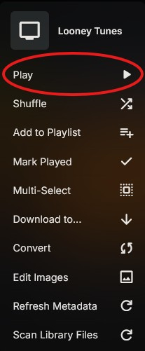

Starkraven420 3 Posted September 20, 2025 Author Posted September 20, 2025 OK....maybe this needs moved to bug section...idk. 3 dot dropdown I can click play button and media plays...but nothing showing in library. Rebooted server twice, still same...nothing in there...lol. I even re-made library, same result. Adding more TV and movie libraries are no problem. Just this. And all my media in windows is coordinated the same as the looney tunes....so yea, odd.
Luke 42289 Posted September 20, 2025 Posted September 20, 2025 No, not a bug, because folder view and the episodes tab are still going to be populated. It's just that if you want Shows, then you need a folder for each show.

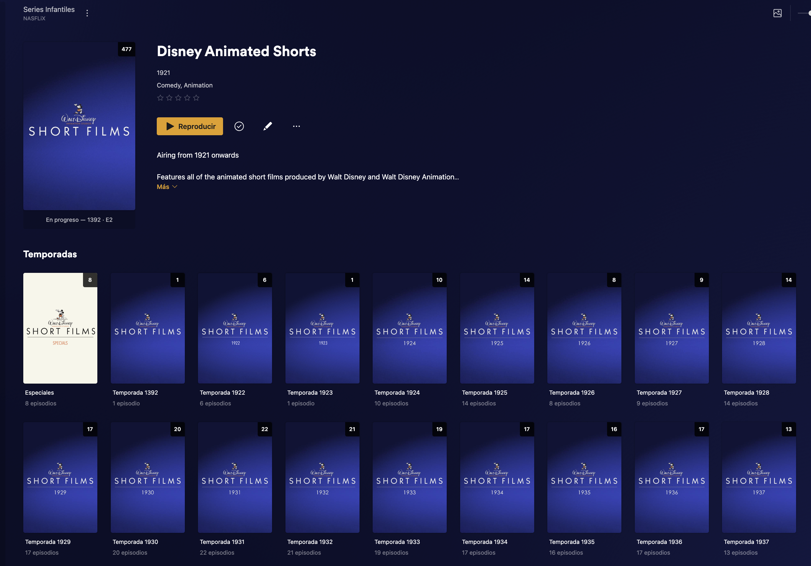

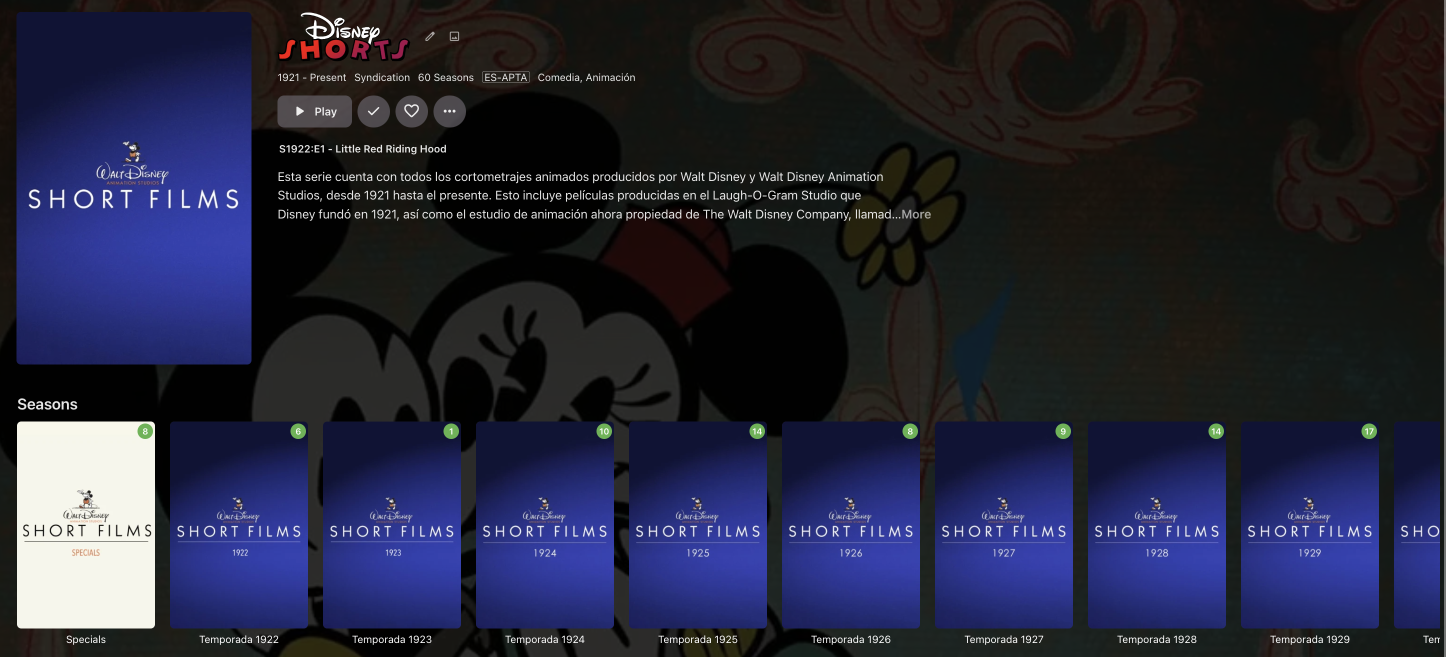

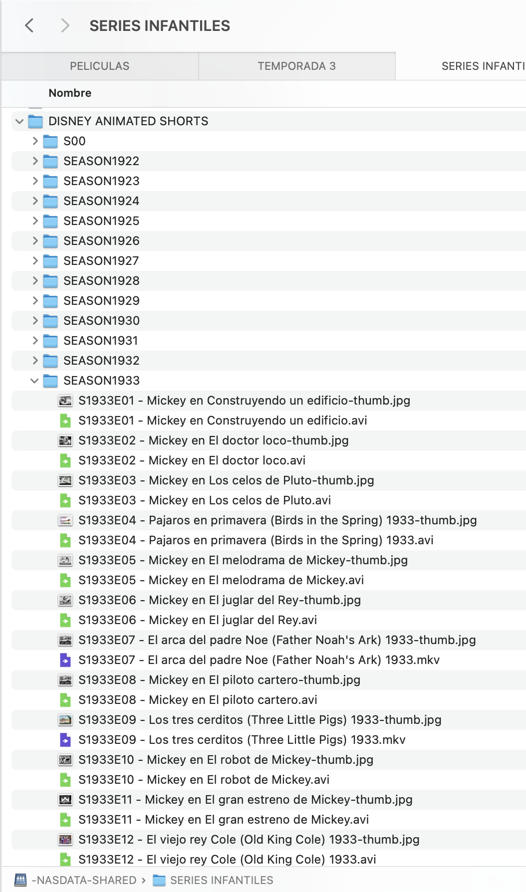

DarkStar1977 122 Posted September 20, 2025 Posted September 20, 2025 (edited) In. case this helps, this is my folder structure for Disney Animated Shorts (Same scenario as Looney Toons): ROOT\KIDS SHOWS\DISNEY ANIMATED SHORTS\SEASONYEAR\SEASONYEARNUMBER - Title.extension And it's working with Emby and Plex: Hope this helps. Edited September 20, 2025 by DarkStar1977

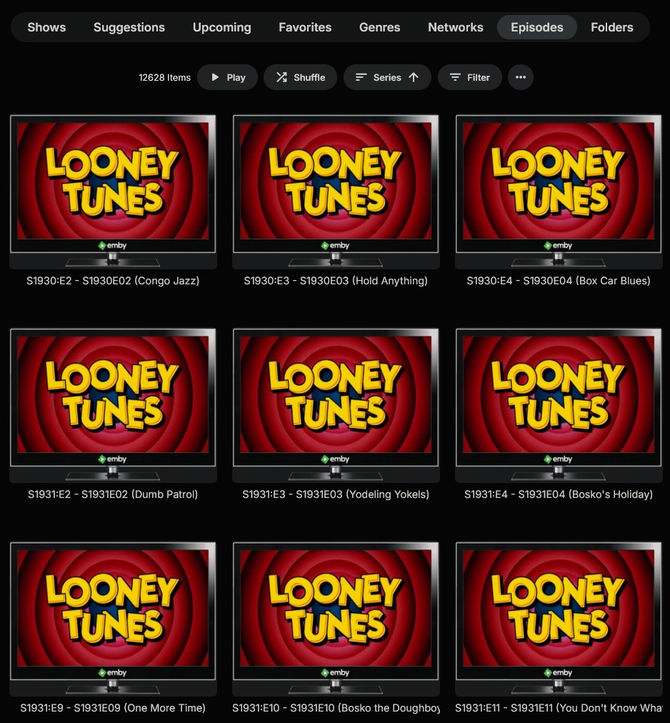

Starkraven420 3 Posted September 20, 2025 Author Posted September 20, 2025 1 hour ago, Luke said: No, not a bug, because folder view and the episodes tab are still going to be populated. It's just that if you want Shows, then you need a folder for each show. Not sure what you're saying. I have a folder for each show. Like I stated, all my TV shows are the same structure...all episodes in a folder of show name. Only a few have separate season folders "inside" TV Show parent folder. Season folders or not, it works both ways. Every other TV show works visually except for looney tunes. The ONLY difference is the naming format ...IE...S01E01 as opposed to S1930E01 that looney tunes uses. And yes I see all of you have this ... S1930E02 ...same as me. Only other guessed idea is that you all have had Emby for a while and older versions get populated together as I have only the latest version and maybe it's bugged(??). I'm just guessing because my LT structure is basically the same as you guys....other than a separate folder for seasons. Update question as I'm typing this. ...OK - Looney Tunes library is just ONE show. It shows the episodes and screens in "episode" tab, but does NOT show up in "show" tab (as viewed above). Is that because it only has ONE show in library?? I can't think this would be the reason as it should still have show on that "show" tab. Then to click on it, then to show season list.
Starkraven420 3 Posted September 20, 2025 Author Posted September 20, 2025 Going to delete looney tunes library and add to already existing library. If it shows up normally, then the problem is having only one show in a library.

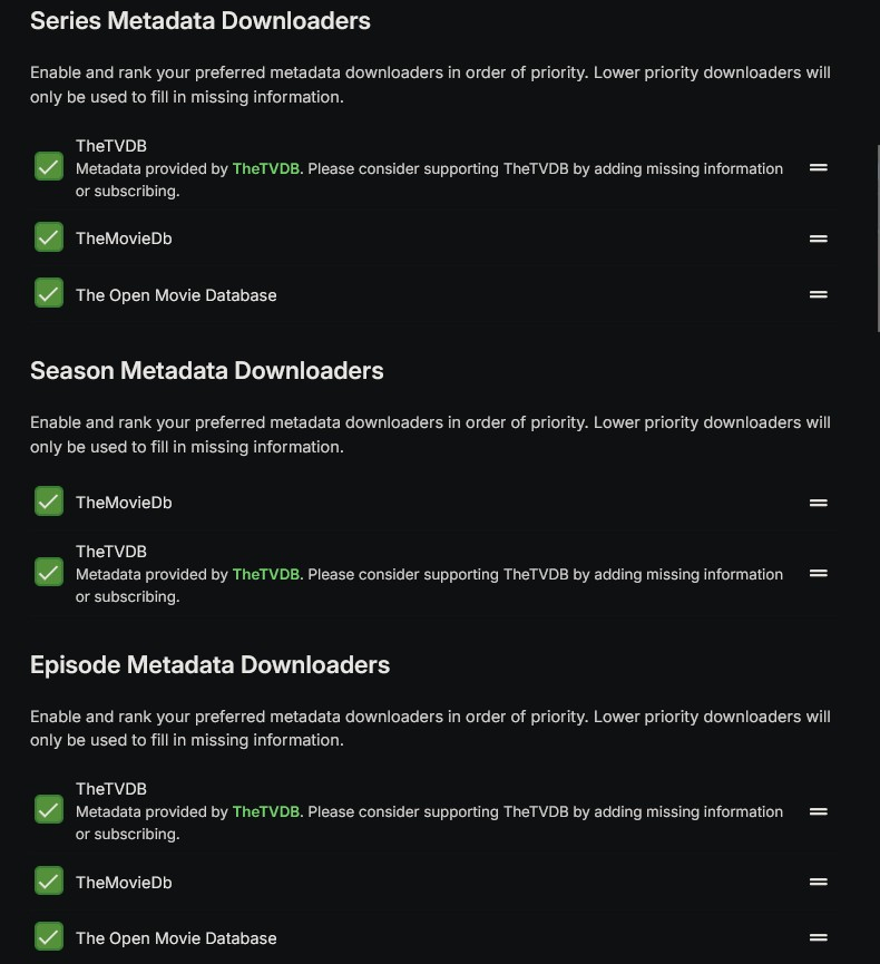

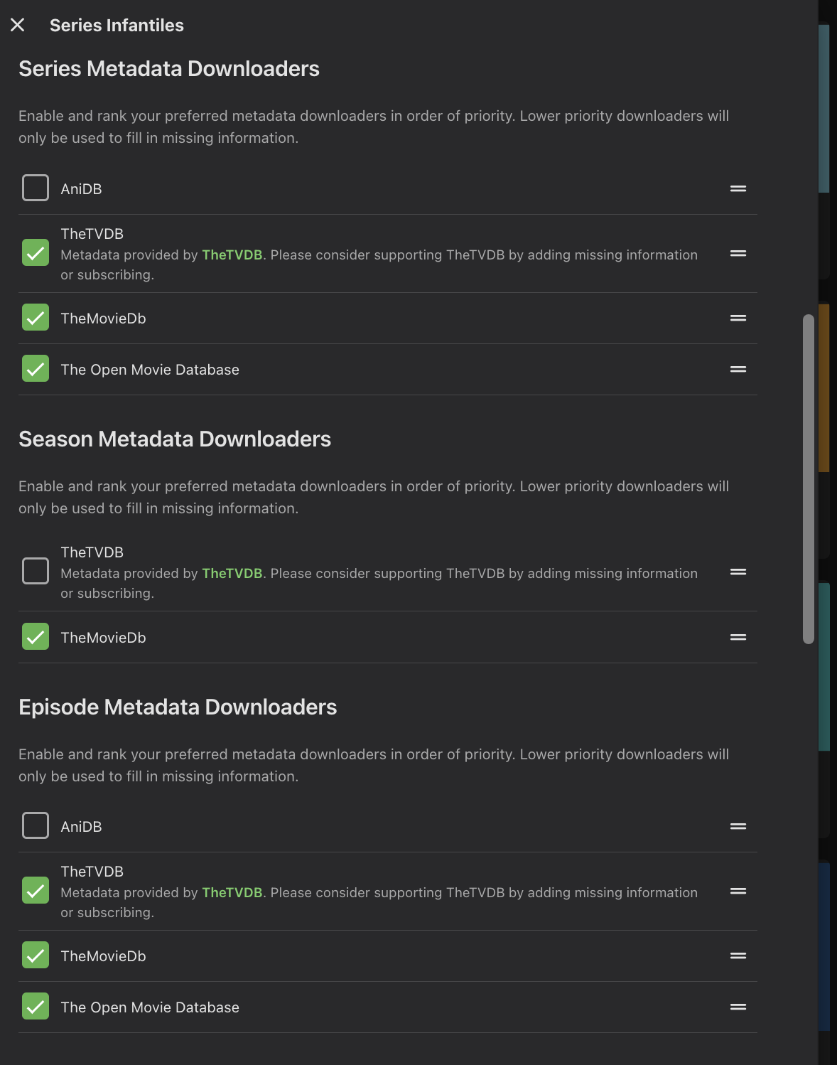

DarkStar1977 122 Posted September 20, 2025 Posted September 20, 2025 Question: Do you have metadata fetcher setup for this library ? This particular shows named SyearExx are so special, did not worked for me until I've setup to fetch metadata exactly as above, with this config Emby will download the show info from TheTVDB but seasoning will come from TheMovie DB. Not sure if it's the case. In any case you're right, I have this show and emby setup 4 years ago, 5 versions ago. I don't know if there's a bug with the last version ...
Starkraven420 3 Posted September 20, 2025 Author Posted September 20, 2025 Yea I have it all marked. So I added to already existing library....same thing. Shows up in "episodes" tab, but not the "show" tab. I've narrowed it down to being named (example) S1930E01 instead of S01E01.

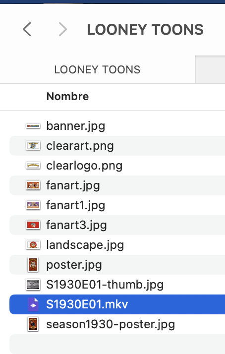

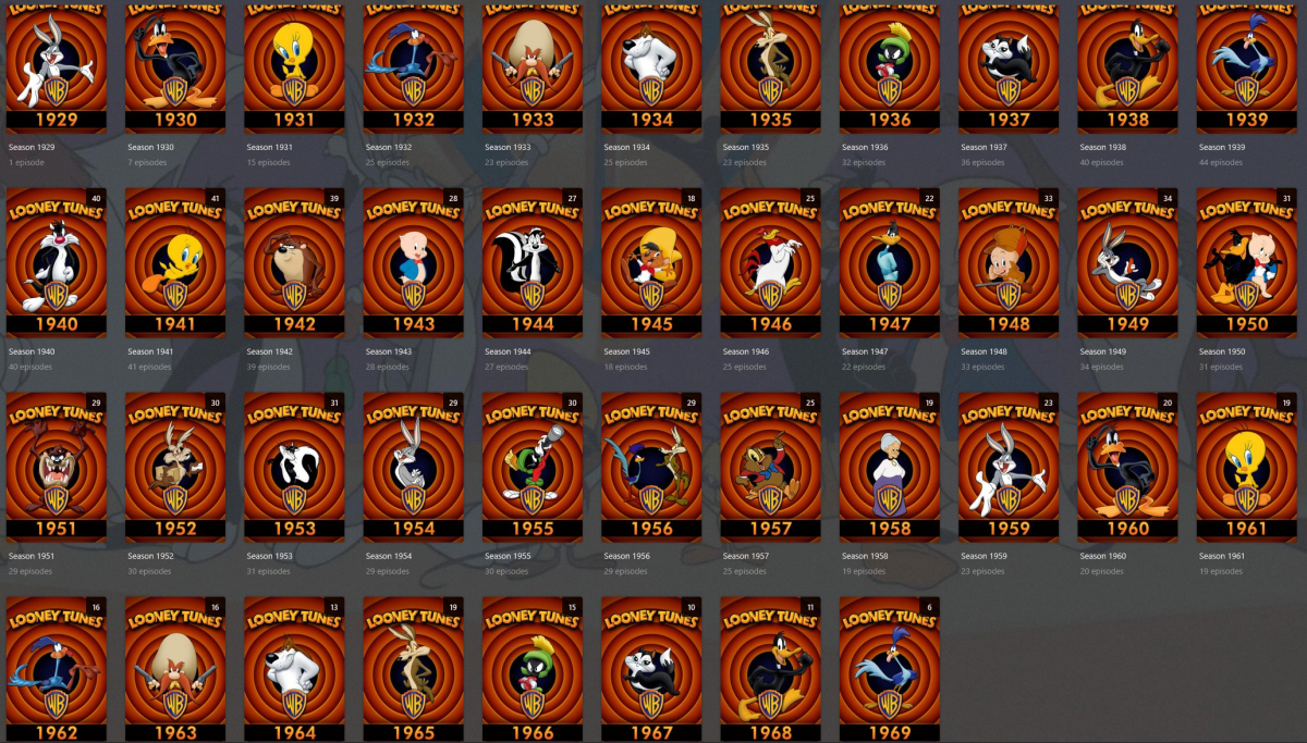

DarkStar1977 122 Posted September 20, 2025 Posted September 20, 2025 I don't understand it, I've done exactly as you, creating a folder for the show and putting just one episode inside, no folders, nothing else: (Please note all the other files are added by Emby once identified because my config is setup to save metadata images on show folder) And it's identified, and shown with the season: And inside the season: My version of emby is 4.8.11.00 (last stable), are you in the same version ??

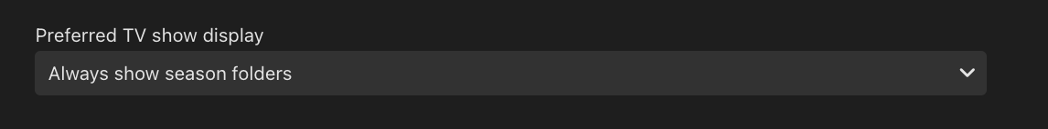

DarkStar1977 122 Posted September 20, 2025 Posted September 20, 2025 (edited) I don''t think can be this, but please, go into server config, your user, display settings: And check if this is setup as mine: As I said I don't think will be this, but it's the only thing that comes to my mind can be related ... BTW, can u paste a screenshot of your folders tab ? Edited September 20, 2025 by DarkStar1977

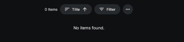

Neminem 1630 Posted September 20, 2025 Posted September 20, 2025 What do you see under shows ? In this screen shot you are looking at episodes.

GrimReaper 4926 Posted September 20, 2025 Posted September 20, 2025 (edited) I suspect this is a paths/structure issue. Could you show your TV shows library paths (and Looney Tunes library path, if still existing)? Edit: If Looney Toons library doesn't exist, could you tell which path you've added for its library folder? Edited September 20, 2025 by GrimReaper Append
Starkraven420 3 Posted September 20, 2025 Author Posted September 20, 2025 under "shows" tab I see all other shows except looney tunes. If I have looney tunes as only show in library I get the blank "show" tab posted above. And no worries. Thanks for trying
