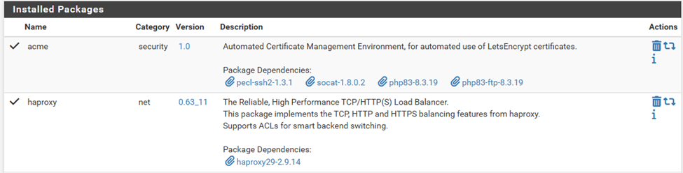

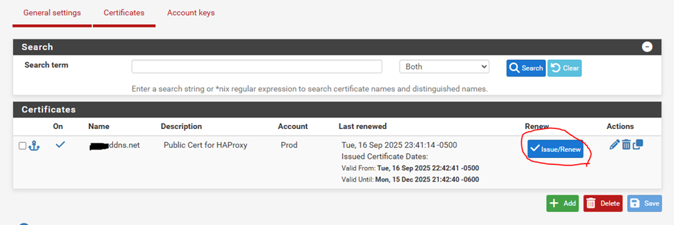

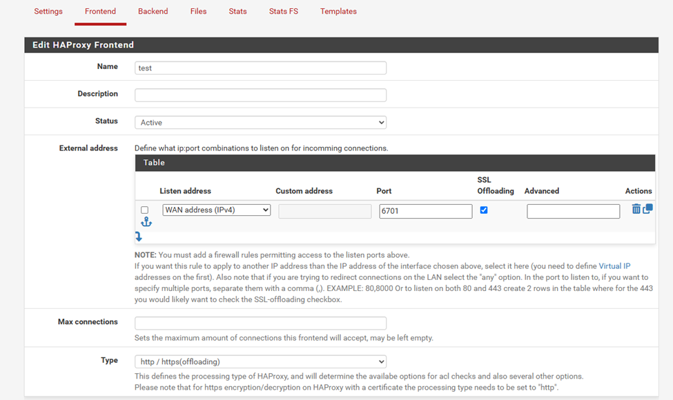

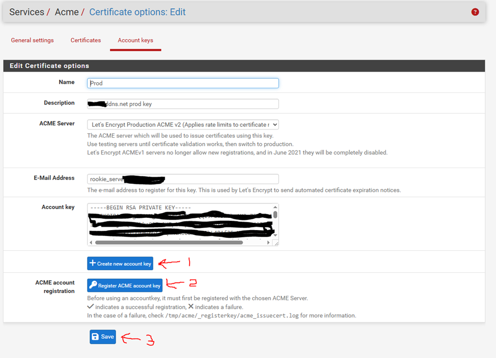

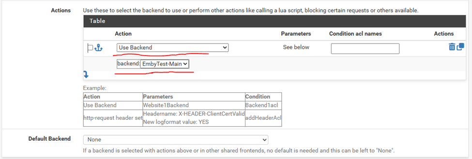

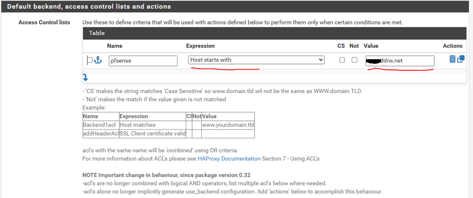

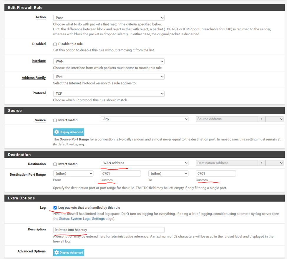

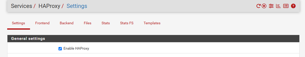

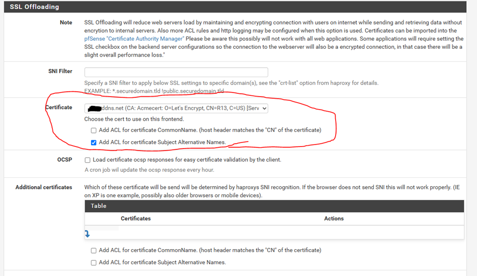

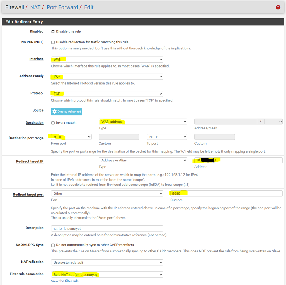

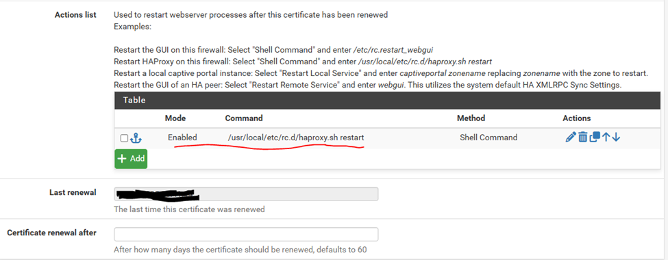

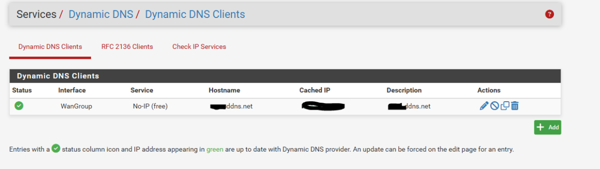

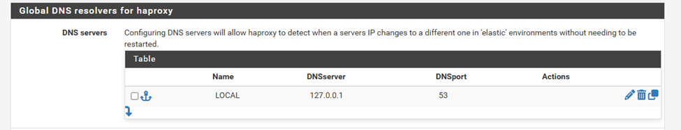

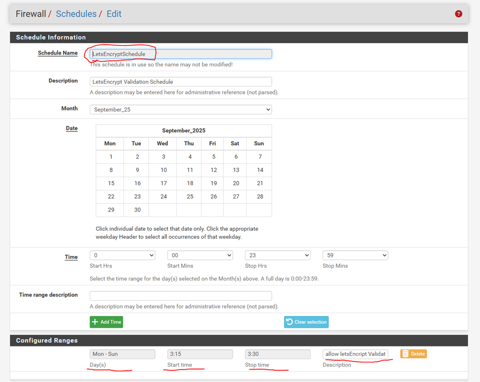

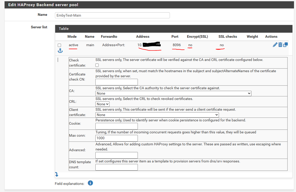

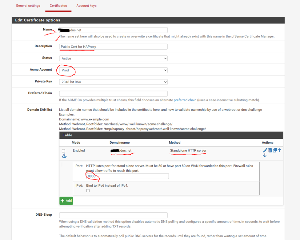

rookies 12 Posted September 19, 2025 Posted September 19, 2025 (edited) I am currently just starting out with Emby, but this is my initial solution for setting up external SSL at low or no cost and no domain ownership required. The only cost to this solution would be hardware to run PFSense on if you don't already have something. It's 10 "easy" steps, so lets get started. PFSENSE: (highly recommended) PFSense is a Commercial grade firewall with all the features and capabilities you would expect. It is a free network firewall distribution, based on the FreeBSD operating system with a custom kernel and including third party free software packages for additional functionality. PFSense is a Software firewall that can be deployed on a wide range of hardware solutions. You can buy an appliance directly from netgate https://pfsense.org/products/ (I run a NetGate 4200+) or you can build your own firewall utilizing hardware you have laying around or purchase: https://pfsense.org/products/#requirements Please familiarize yourself with the setup of your Firewall and validate that the configuration is secure. Don’t assume, PFSense will allow you to do things that typical residential firewall will not. If you are not familiar with setting up a firewall, I would recommend you get PFSense running and build out a configuration that works for you base needs prior to doing a full switch over. This will give you some time to learn how things work and get comfortable with the interface. PFSense has an awesome community should you need help with this step. Prerequisites: 1) A working PFSense Firewall configuration. note: You should either replace your ISP’s Router with PFSENSE or put the ISP’s Router in bridge mode to pass all traffic directly to PFSense. (this will eliminates double NAT configuration bs) 2) A DDNS account. (this can be any free DDNS service) 3) A DDNS domain name. I use (xyz.DDNS.NET free domain currently) The setup for Emby Hosting: Step 0: setup dyndns go to Services -> Dynamic DNS Step 1: go to Firewall -> NAT -> Port Forwarding and Add a new rule. To forward port 8080 to your internal network firewall Address. Step 2: go to System -> Package Manager and install 2 package “acme” and “haproxy Step 3: go to Services -> Acme Certificates first “Create a new Account Key” then “Register ACME account key” then click save. go to certificates tab For domain name put in your domain name ex xyz.ddns.net For method use “Standalone HTTP Server” the set port to 8080. For action set it to restart haproxy on cert renewal. Then save. Step 4: issue a cert You can verify your cert by going to System -> Certificates. You should see the root cert: And the certificate: Step 5: re-secure port 80 since it points back into your farwall. Go to Firewall -> Schedules and create a schedule for mon-sun 3:15-3:30 Go to Firewall -> Rules -> wan Find the rule created when you made the NAT rule and apply the Schedule to that rule in advanced options. (note: with this schedule applied the cert can only be renewed between 3:15am and 3:30 am when the auto renew job goes off. If you attempt to renew outside that time the firewall blocks the validation requests from letsencrypt) Step 6: go to Services -> haproxy -> settings Enable haproxy Make sure dns is set further down: Step 7: go to Backend and add an entry Set to address and port of your internal Emby server. Save Step 8: go to frontend and add an entry Port should be the external port you want to use for emby access. I used 6701 Set type to http/https offloading Set the host expression to starts with and the value to your dns name xyz.ddns.net For action set it to use backend and pick the backend you created in the previous step Further down in the ssl offloading section pick the certificate you created earlier Step 9 go to Firewall -> Rules -> Wan Add a rule to allow traffic to the haproxy front end I used port 6701 for access. Step 10 open a browser on a device not connected to your network and go to: https://xyz.ddns.net:6700 (replace xyz.ddns.net with your domain name.) You should get the Emby login page via a SSL connection. I am sure there are additional step you can perform to increase security on this. but the goal is a working configuration. done go watch a movie! Edited September 19, 2025 by rookies remove attachments again 1

Clackdor 110 Posted September 20, 2025 Posted September 20, 2025 (edited) @rookiesI also use HAProxy on PFSense as my first reverse proxy (although I have a dedicated VM setup for it and it's only acting as a HAProxy appliance) I do have a couple of extra tips that I didn't see mentioned in your write-up though. 1. In the frontend configuration for HAProxy you'll want to make sure you check the box for "Use "forwardfor" option". This will add the X-Forwarded-For header to packets before sending them to emby. This makes it so that Emby will see the real client IP that is making the connection rather than the IP of PFSense/HAProxy. This is needed if you expect bandwidth limits and whatnot to work for remote connections. 2. Also in the frontend configuration you can add the following in the field next to the "Advanced certificate specific ssl options": alpn h2,http/1.1 This will enable HTTP/2 on the frontend, so all connections should use HTTP/2 between the client and HAProxy. It will fall back to http/1.1 if for whatever reason HTTP/2 isn't supported by the client. Also worth noting that if you enabled HTTPS within emby as well, the HAProxy backend can communicate with emby via HTTP/2 so the connection will be HTTP/2 throughout. Most other reverse proxies only support http/1.1 when making backend connections to servers. Edited September 20, 2025 by Clackdor
rookies 12 Posted September 21, 2025 Author Posted September 21, 2025 57 minutes ago, Clackdor said: @rookiesI also use HAProxy on PFSense as my first reverse proxy (although I have a dedicated VM setup for it and it's only acting as a HAProxy appliance) I do have a couple of extra tips that I didn't see mentioned in your write-up though. 1. In the frontend configuration for HAProxy you'll want to make sure you check the box for "Use "forwardfor" option". This will add the X-Forwarded-For header to packets before sending them to emby. This makes it so that Emby will see the real client IP that is making the connection rather than the IP of PFSense/HAProxy. This is needed if you expect bandwidth limits and whatnot to work for remote connections. 2. Also in the frontend configuration you can add the following in the field next to the "Advanced certificate specific ssl options": alpn h2,http/1.1 This will enable HTTP/2 on the frontend, so all connections should use HTTP/2 between the client and HAProxy. It will fall back to http/1.1 if for whatever reason HTTP/2 isn't supported by the client. Also worth noting that if you enabled HTTPS within emby as well, the HAProxy backend can communicate with emby via HTTP/2 so the connection will be HTTP/2 throughout. Most other reverse proxies only support http/1.1 when making backend connections to servers. That is awesome, thanks for the heads up. I haven't actually put this into use in any real way. would have definitely hit the x-forward snag and had to figure it out and fix it.
Clackdor 110 Posted September 21, 2025 Posted September 21, 2025 12 minutes ago, rookies said: That is awesome, thanks for the heads up. I haven't actually put this into use in any real way. would have definitely hit the x-forward snag and had to figure it out and fix it. Glad to help. HAProxy is very powerful and kind of pupose-built for proxying and load balancing. I've been using PFSense for over 15 years on and off at this point. Even though I'm currently using Sophos instead of PFSense as my main router/firewall I opted to setup the PFSense VM just for HAProxy since I was already comfortable with it. As far as I'm aware the HAProxy package in PFsense (maybe OPNSense too?) is the only way to get a webgui for HAProxy configuration that isn't tied to some expensive enterprise tool.
