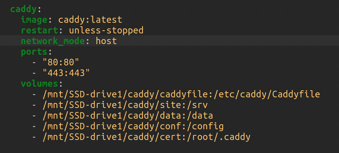

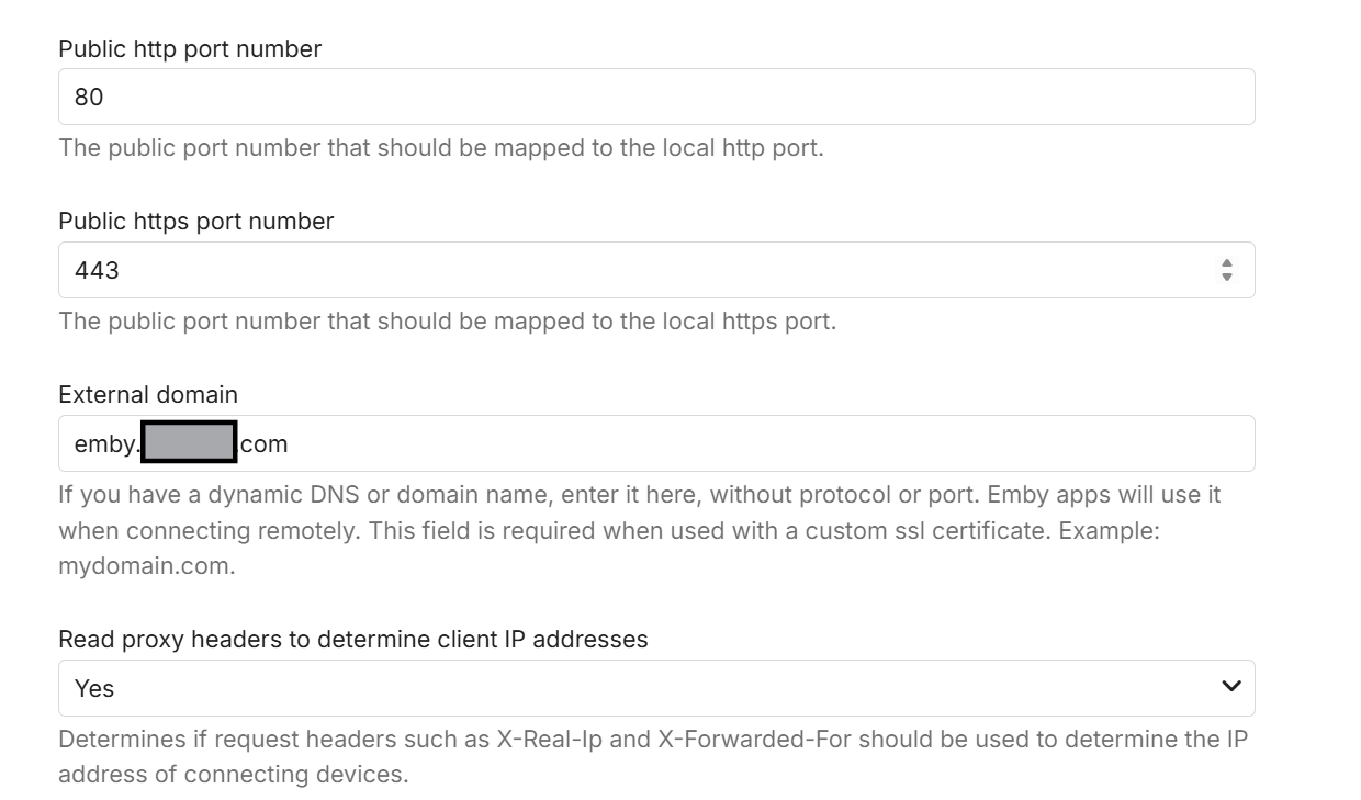

Lazarus_Long 81 Posted September 19, 2025 Author Posted September 19, 2025 I found some more info and have a lot of it setup, but can't seem to connect. I have confirmed that I can ping my domain and it resolves to my public IP. I have Caddyfile setup as the following: emby.xxxx.com { reverse_proxy / 10.0.0.187:8096 } And looking at the docker logs for the container, I can see that it appears to have downloaded a certificate... {"level":"info","ts":1758319306.5644734,"msg":"successfully downloaded available certificate chains","count":2,"first_url":"https://acme-v02.api.letsencrypt.org I don't have any port forwarding setup on the router and changed my Emby network settings as shown below. However, when trying to connect to it via an app (off network), or just the website within my network, it won't connect properly.

Lazarus_Long 81 Posted September 19, 2025 Author Posted September 19, 2025 Yeah I have that setup in my Docker compose for Caddy, but wondering if I also need to port forward on the router? Trying with DNSChecker.org and it can't connect on 443 or 80
Lazarus_Long 81 Posted September 19, 2025 Author Posted September 19, 2025 OK, making further progress...I opened port 443 on my router and now I can confirm I can hit it outside my network. Still having issues getting Emby to connect up though.
Lazarus_Long 81 Posted September 19, 2025 Author Posted September 19, 2025 So I got it to work by temporarily running Caddy on my Windows server and pointing to the Ubuntu server. Must be something wrong with my config in Docker compose so will need to dig into that a bit more.
