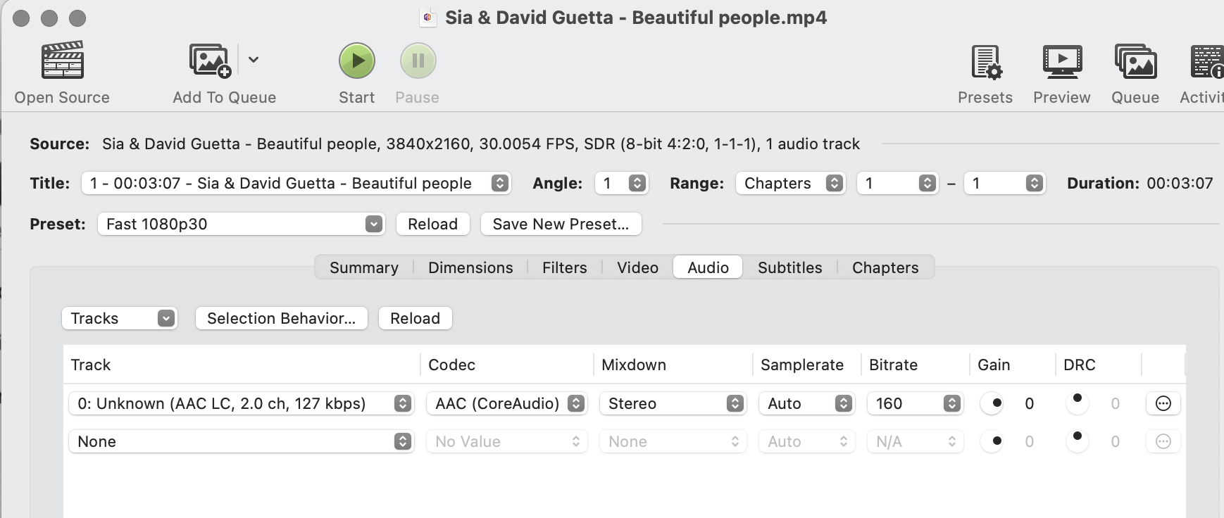

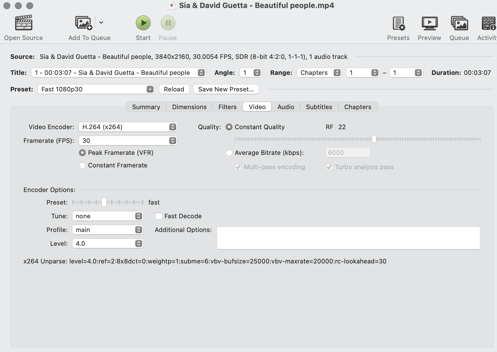

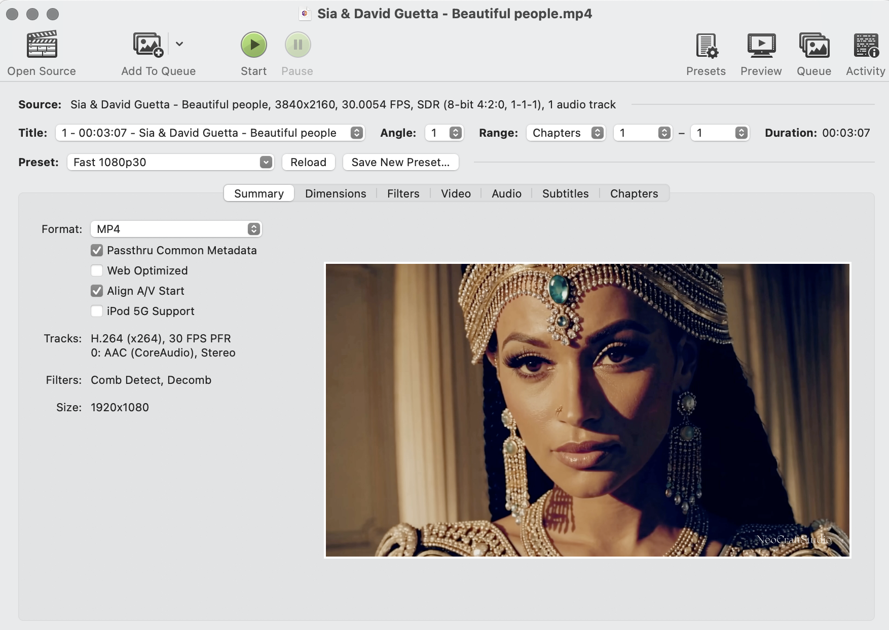

xbmcgotham 35 Posted September 26, 2025 Author Posted September 26, 2025 Hi @NeminemI am familiar with Handbrake. What settings do you want me to change to as I am not sure what you are referring to in the for last post. Normally I would do a full conversion in handbrake.
Neminem 1630 Posted September 26, 2025 Posted September 26, 2025 As I said I use Tdarr to do this on auto pilot. But from you screen shot it look like you are rencoding it. This is what I use in Tdarr. if (file.ffProbeData.streams[0].codec_type != "video") { response.infoLog += "Video is not in the first stream"; response.preset = ",-map 0:v? -map 0:a? -map 0:s? -map 0:d? -map 0:t? -c copy"; response.reQueueAfter = true; response.processFile = true; ffmpeg does this to the media to remap video first, as just a remux. -map 0:v? -map 0:a? -map 0:s? -map 0:d? -map 0:t? -c copy

pwhodges 2039 Posted September 26, 2025 Posted September 26, 2025 1 hour ago, Neminem said: Handbreak might do it for you. Handbrake doesn't have a video passthrough - it always transcodes. Remuxing in MKVToolNix is the obvious way to reorder the streams, but of course you end up with an MKV file instead of the current MP4. Paul
