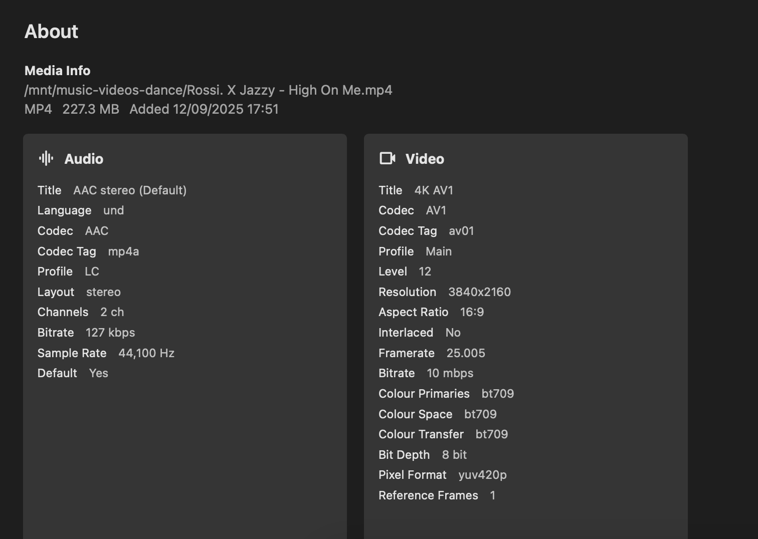

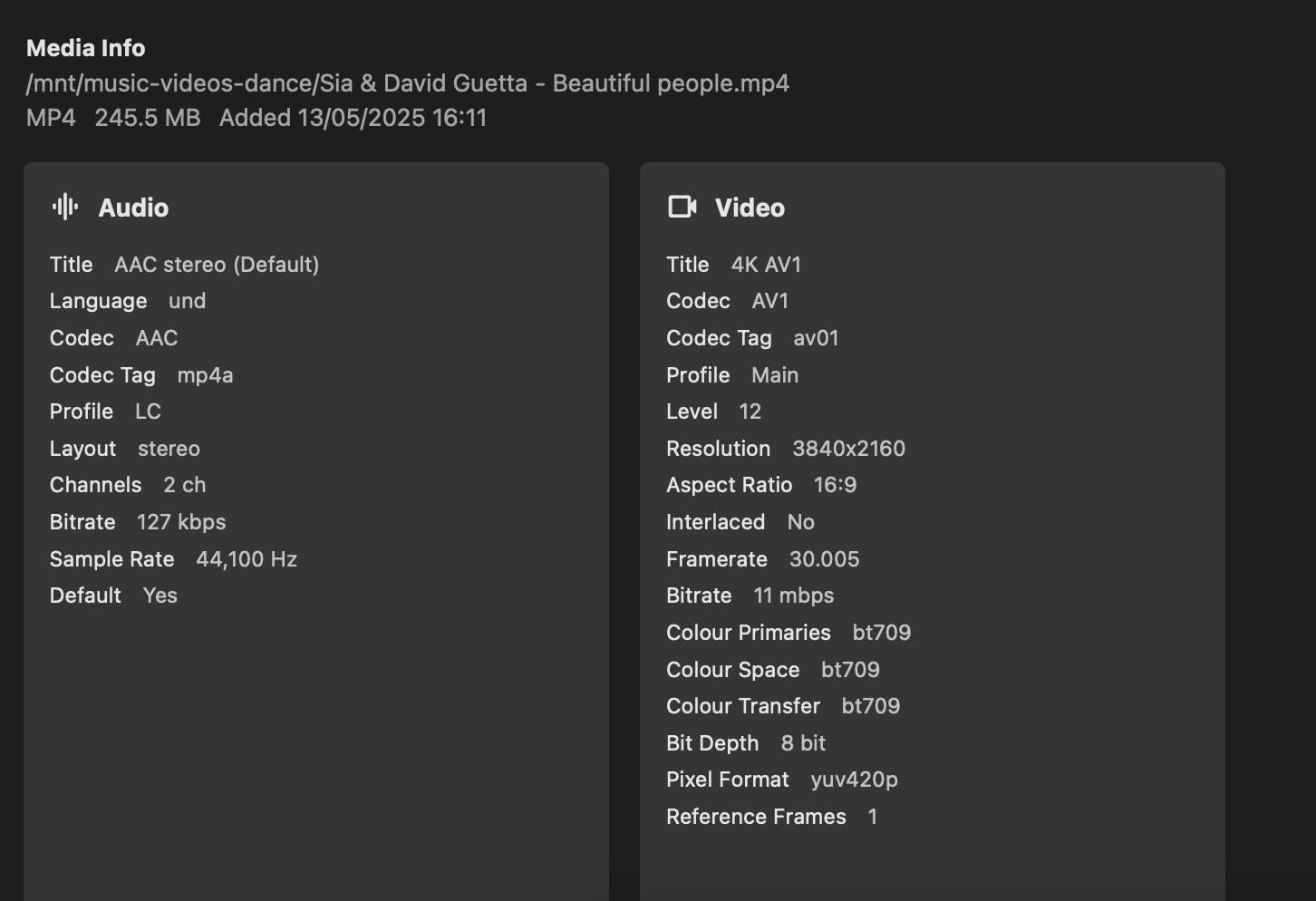

xbmcgotham 35 Posted September 26, 2025 Author Posted September 26, 2025 8 hours ago, Luke said: OK I don't really see an obvious cause. Are you able to update to Emby Server 4.8.11 ? Hi @Luke I have updated to 4.8.11, however no change in performance. 3 hours ago, brothom said: No log indicates that no transcoding has occurred. If the video stutters, but no transcoding is happening the video is probably "too heavy" for the device to handle, even if it should be able to play the codec. An easy way to reproduce stutter on Windows is by having an older laptop (2014-ish) and playing 4K (h264) videos. The browser can and will play it but most older Windows devices will just stutter beyond believe. Can you share the specifications of the file and on what device are you trying to play the AV1 file? This information can be found at the bottom in Emby on the media's detail page, for example: Hi @brothom Please find below the details of the example files. As you can see they are small files and should not have any issue with the hardware both on a iMac 27-inch 2020 and a Nvidea Shield 2019. Also, as I can play these files without any issue directly on the mac using Emby web browser and VLC. So I do think there is something wrong with the AV1 codec in Emby app. Can one of the engineers dig into this as it effects all the AV1 videos I have. Have a nice weekend.
