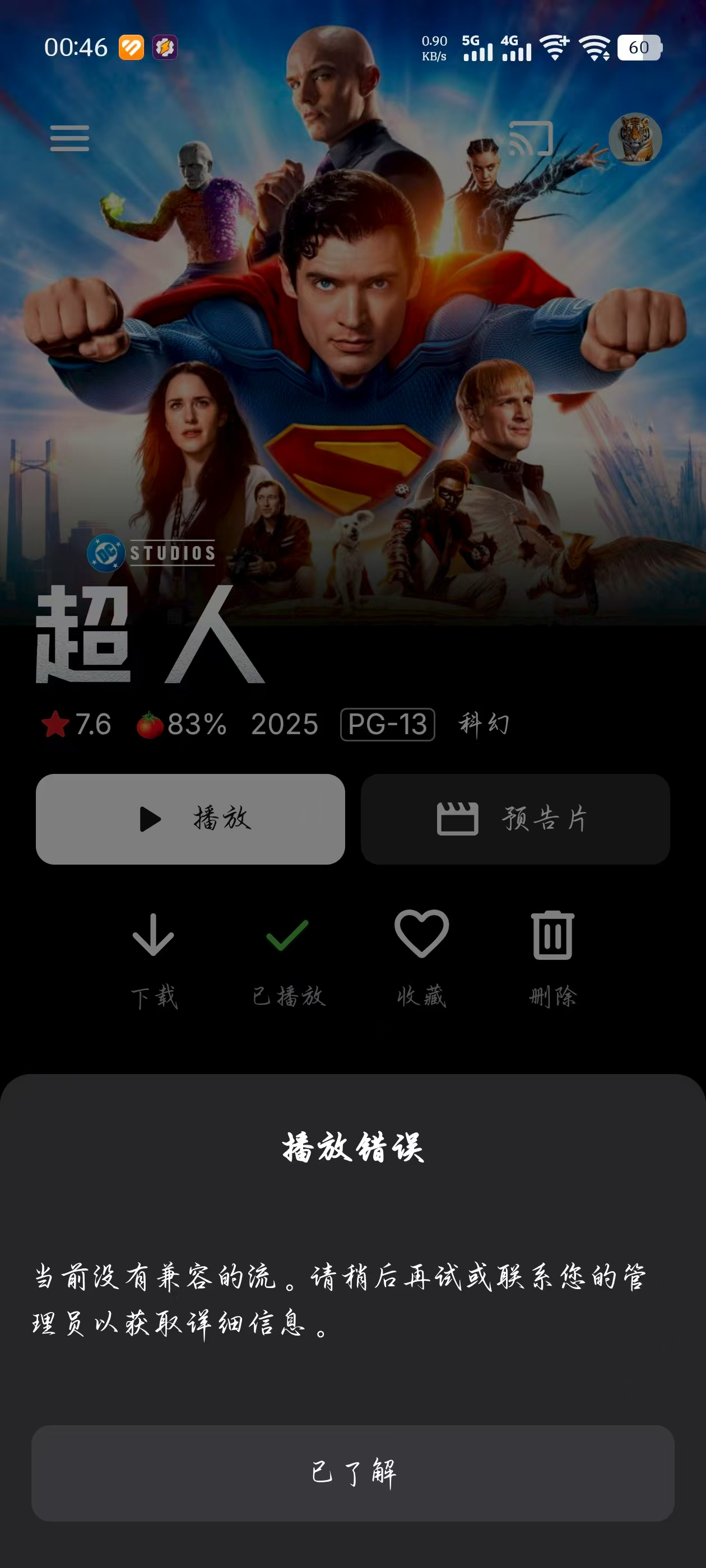

moneycwq 2 Posted September 18, 2025 Posted September 18, 2025 I am currently using a Debian variant system to install the emby version. I have given the necessary permissions to the directory permissions as described in the community posts. Now I find that many MKV media cannot be played. The emby player on the mobile phone or computer displays "Currently no compatible stream", while the same media files play normally on the emby on the Windows server side. I have just switched from Windows Server to Debian on Linux and don't know how to solve this problem? My ID is moneycwq@126.com, and I am a lifetime member of emby. Currently, the debian is running on a virtual machine under esxi7.03, with 12cpu and 24g memory. Could you please ask emby technical staff to answer this question? Thank you! My English is not very good, and I am currently using Google Translate. I don't know if there are any errors in the translation.
Luke 42242 Posted September 18, 2025 Posted September 18, 2025 Hi there, let's look at an example. Please attach the information requested in how to report a media playback issue. Thanks!
moneycwq 2 Posted September 18, 2025 Author Posted September 18, 2025 I tried to play the following files ”Superman.2025.2160p.iTunes.WEB-DL.DDP.5.1.Atmos.H.265-CHDWEB.mkv“ and ”Transformers.The.Last.Knight.2017.2160p.IMAX.UHD.Blu-ray.REMUX.DoVi.HDR10.HEVC.Atmos.TrueHD.7.1-HDH.mkv“ and the error "No compatible streams are currently available" appeared. The latest log file is attached. I logged in using the account name emby, which is my system administrator account. I sent this log file at 9:55 AM Pacific Time on September 18th.thank you! emby_android_1758214292539(1).txt

Happy2Play 9811 Posted September 18, 2025 Posted September 18, 2025 Emby has not probed this content so it has no idea how to play it as there is no media info. Quote {"Protocol":"File","Id":"316a7c71fa7213ee2a4964e221944405","Path":"/vol5/1000/Cinema/Movie/科幻/Superman.2025.2160p.iTunes.WEB-DL.DDP.5.1.Atmos.H.265-CHDWEB/Superman.2025.2160p.iTunes.WEB-DL.DDP.5.1.Atmos.H.265-CHDWEB.mkv","Type":"Default","Container":"mkv","Size":0,"Name":"超人","IsRemote":false,"HasMixedProtocols":false,"SupportsTranscoding":true,"SupportsDirectStream":true,"SupportsDirectPlay":true,"IsInfiniteStream":false,"RequiresOpening":false,"RequiresClosing":false,"RequiresLooping":false,"SupportsProbing":false,"MediaStreams":[],"Formats":[],"RequiredHttpHeaders":{},"AddApiKeyToDirectStreamUrl":false,"ReadAtNativeFramerate":false,"ItemId":"34384"} As your server log suggest a permissions issue. 2025-09-19 00:44:19.524 Info MediaProbeManager: ProcessRun 'ffprobe' Execute: /opt/emby-server/bin/ffprobe -i file:"/vol5/1000/Cinema/Movie/科幻/Superman.2025.2160p.iTunes.WEB-DL.DDP.5.1.Atmos.H.265-CHDWEB/Superman.2025.2160p.iTunes.WEB-DL.DDP.5.1.Atmos.H.265-CHDWEB.mkv" -threads 0 -v info -print_format json -show_streams -show_chapters -show_format -show_data 2025-09-19 00:44:19.560 Info MediaProbeManager: ProcessRun 'ffprobe' Process exited with code 0 - Succeeded 2025-09-19 00:44:19.562 Error App: Error in ffprobe *** Error Report *** Version: 4.8.11.0 Command line: /opt/emby-server/system/EmbyServer.dll -programdata /var/lib/emby -ffdetect /opt/emby-server/bin/ffdetect -ffmpeg /opt/emby-server/bin/ffmpeg -ffprobe /opt/emby-server/bin/ffprobe -restartexitcode 3 -updatepackage emby-server-deb_{version}_amd64.deb Operating system: Linux version 6.12.18-trim (root@MiuMiuPC) (gcc (Debian 12.2.0-14) 12.2.0, GNU ld (GNU Binutils for Debian) 2.40) #5 SMP PREEMPT_DYNAMIC Thu Mar 27 10 Framework: .NET 6.0.36 OS/Process: x64/x64 Runtime: opt/emby-server/system/System.Private.CoreLib.dll Processor count: 10 Data path: /var/lib/emby Application path: /opt/emby-server/system Emby.Server.MediaEncoding.Unified.Ffmpeg.FfRunException: Emby.Server.MediaEncoding.Unified.Ffmpeg.FfRunException: ffprobe failed - streams and format are both null: -i file:"/vol5/1000/Cinema/Movie/科幻/Superman.2025.2160p.iTunes.WEB-DL.DDP.5.1.Atmos.H.265-CHDWEB/Superman.2025.2160p.iTunes.WEB-DL.DDP.5.1.Atmos.H.265-CHDWEB.mkv" -threads 0 -v info -print_format json -show_streams -show_chapters -show_format -show_data ffprobe version 5.1-emby_2023_06_25 Copyright (c) 2007-2022 the FFmpeg developers and softworkz for Emby LLC built with gcc 10.3.0 (crosstool-NG 1.25.0) file:/vol5/1000/Cinema/Movie/科幻/Superman.2025.2160p.iTunes.WEB-DL.DDP.5.1.Atmos.H.265-CHDWEB/Superman.2025.2160p.iTunes.WEB-DL.DDP.5.1.Atmos.H.265-CHDWEB.mkv: Permission denied { } at Emby.Server.MediaEncoding.Probing.MediaProbeManager.GetMediaInfoInternal(String inputPath, String primaryPath, MediaProtocol protocol, String userAgent, Boolean extractChapters, String probeSizeArgument, Boolean isAudio, Boolean hasMixedProtocols, CancellationToken cancellationToken) at Emby.Providers.MediaInfo.FFProbeVideoInfo.ProbeVideo[T](MetadataResult`1 metadataResult, MetadataRefreshOptions options, LibraryOptions libraryOptions, CancellationToken cancellationToken) at Emby.Providers.Manager.MetadataService`2.RunCustomProvider(ICustomMetadataProvider`1 provider, MetadataResult`1 itemResult, String logName, MetadataRefreshOptions options, LibraryOptions libraryOptions, RefreshResult refreshResult, CancellationToken cancellationToken) Source: Emby.Server.MediaEncoding TargetSite: Void MoveNext() Quote file:/vol5/1000/Cinema/Movie/科幻/Superman.2025.2160p.iTunes.WEB-DL.DDP.5.1.Atmos.H.265-CHDWEB/Superman.2025.2160p.iTunes.WEB-DL.DDP.5.1.Atmos.H.265-CHDWEB.mkv: Permission denied 1

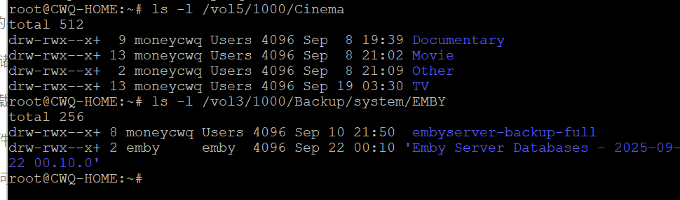

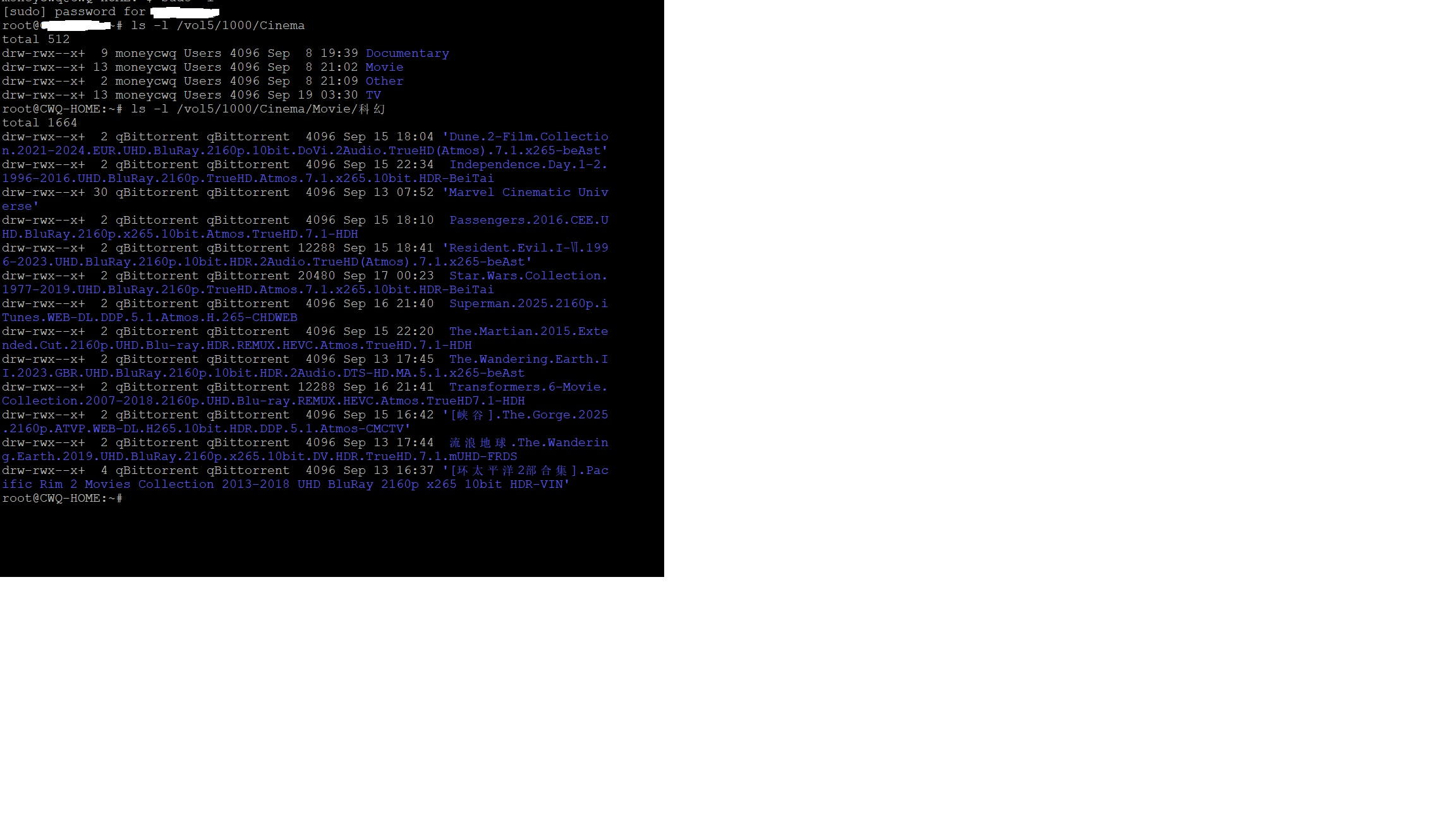

moneycwq 2 Posted September 20, 2025 Author Posted September 20, 2025 I checked the permissions according to this post and found that they appear to be fine. See the screenshots I attached. The Superman file that's having playback issues also has no issues. Furthermore, within the same directory, some files play fine, while others don't. Why is this? And if it's a permissions issue, why do some files play fine while others don't, even though I've given permissions to the entire directory?
Neminem 1623 Posted September 20, 2025 Posted September 20, 2025 I have noticed from your screen shot. That owner and user is qbittorrent. Are they really done downloading ? Since size 0 On 9/18/2025 at 7:53 PM, Happy2Play said: {"Protocol":"File","Id":"316a7c71fa7213ee2a4964e221944405","Path":"/vol5/1000/Cinema/Movie/科幻/Superman.2025.2160p.iTunes.WEB-DL.DDP.5.1.Atmos.H.265-CHDWEB/Superman.2025.2160p.iTunes.WEB-DL.DDP.5.1.Atmos.H.265-CHDWEB.mkv","Type":"Default","Container":"mkv","Size":0,"Name":"超人","IsRemote":false,"HasMixedProtocols":false,"SupportsTranscoding":true,"SupportsDirectStream":true,"SupportsDirectPlay":true,"IsInfiniteStream":false,"RequiresOpening":false,"RequiresClosing":false,"RequiresLooping":false,"SupportsProbing":false,"MediaStreams":[],"Formats":[],"RequiredHttpHeaders":{},"AddApiKeyToDirectStreamUrl":false,"ReadAtNativeFramerate":false,"ItemId":"34384"} Its never good practice to use your download folder as a media folder.
moneycwq 2 Posted September 20, 2025 Author Posted September 20, 2025 I am very sure that the download is complete. I use qb to automatically download to each media folder. If I set it separately, I will need to manually select which folder to put it in after the download is complete. qb uses a temporary folder to store media files during the download process. Only after the download is complete will the official files be transferred to the media folder I specified. So once you see it in the media folder, it means that qb has confirmed that the download is complete
TMCsw 259 Posted September 20, 2025 Posted September 20, 2025 Is 'emby' a member of the group 'qBittorrent'? If not, it cannot read these files... So add emby to the group sudo adduser emby qBittorrent 1
