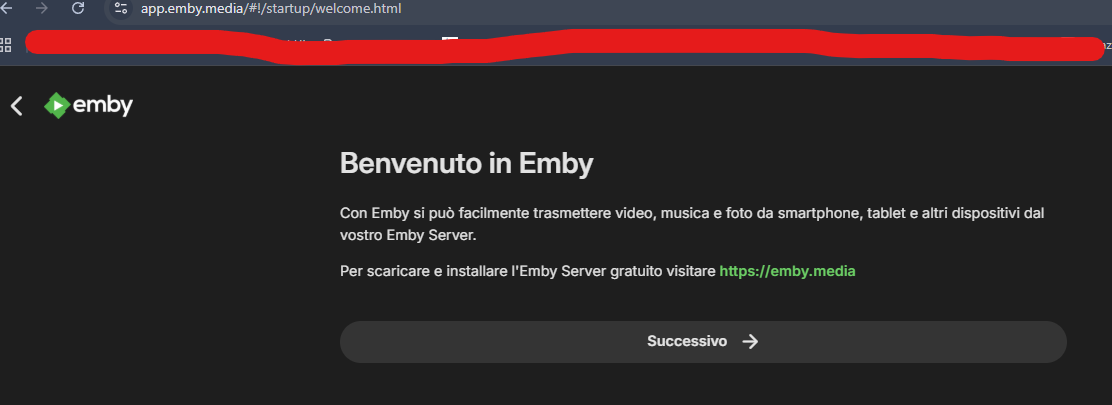

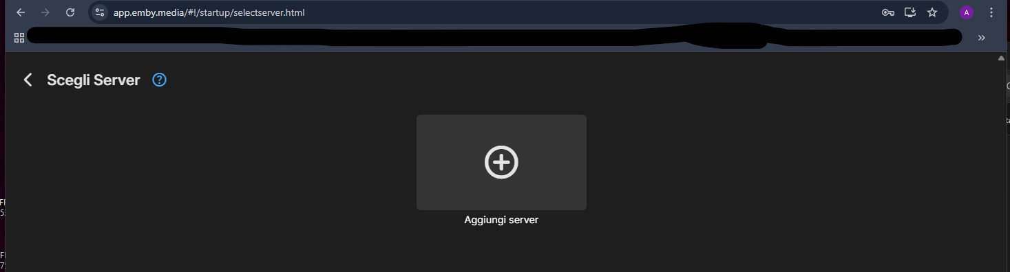

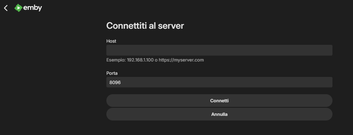

Taglia74 5 Posted October 20, 2025 Author Posted October 20, 2025 (edited) I can't understand how emby connect work. I am on a pc different from pc where is installed emby server and I'm trying to connect to emby. so I go to the emby website and I login with my user name and password account. As soon I'm logged emby ask to add a new server but of course because IP is changed I don't know a new IP......and I can't see any Emby connect option to use. Where do I'm wrong? (please find attached a sequence of screen that I done in the emby website) Edited October 20, 2025 by Taglia74
Luke 42289 Posted October 26, 2025 Posted October 26, 2025 On 10/20/2025 at 4:04 PM, Taglia74 said: I can't understand how emby connect work. I am on a pc different from pc where is installed emby server and I'm trying to connect to emby. so I go to the emby website and I login with my user name and password account. As soon I'm logged emby ask to add a new server but of course because IP is changed I don't know a new IP......and I can't see any Emby connect option to use. Where do I'm wrong? (please find attached a sequence of screen that I done in the emby website) Hi, did you try entering your server address manually? You can get your server address on the server machine by going to the front page of your emby server dashboard. @sa2000

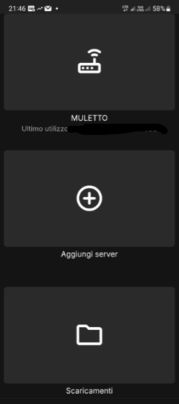

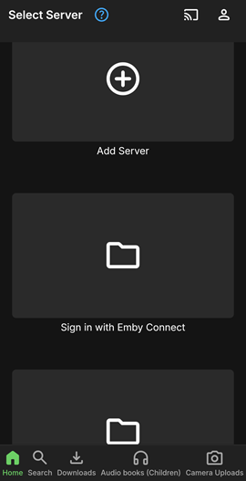

sa2000 703 Posted October 27, 2025 Posted October 27, 2025 (edited) On 20/10/2025 at 20:52, Taglia74 said: Hi I'have just try to check if it work from outside and it doesn't work because IP is changed. I've opened an emby app and no emby connect option is available (first option is old IP, second is "aggiungi server" and it ask for IP and no emby connect option is available).....Do I need to istall on my android mobile phone a different emby app? what version of Emby for Android are you using ? There should be an icon for "Sign in with Emby Connect" between the "Add Server" and "Downloads" icons. This is screenshot from my Android app after selecting "Change Server" Version info for the universal Emby fro Android app is given in this forum post Emby: Latest Versions Edited October 27, 2025 by sa2000

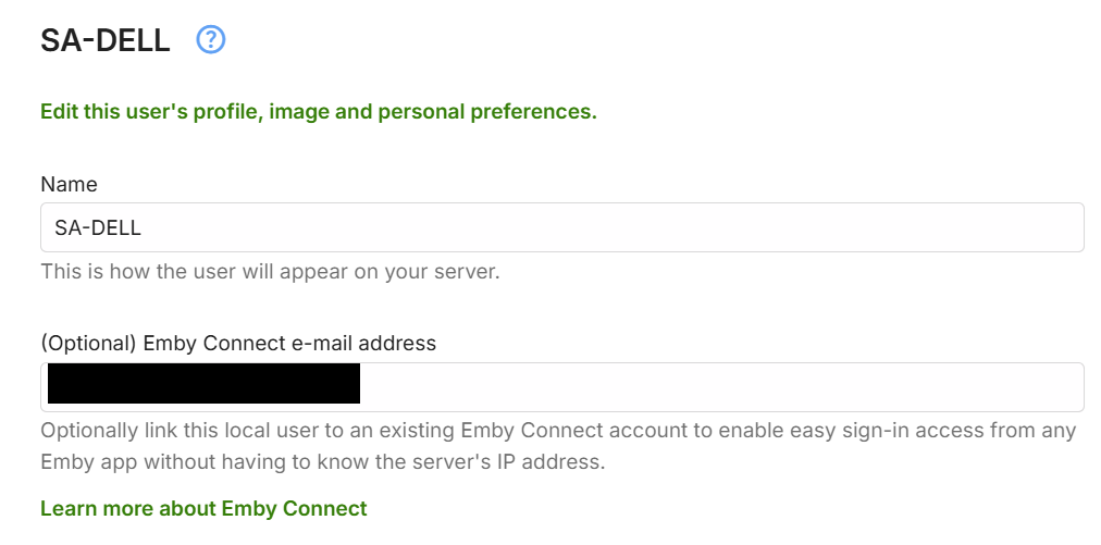

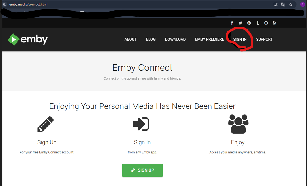

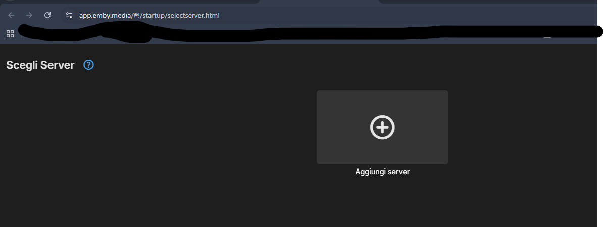

sa2000 703 Posted October 27, 2025 Posted October 27, 2025 @Taglia74 This screenshot indicates that the Emby Connect account you signed into is not currently linked to the Emby Server Access your server on the local network and then go to server settings and in the left side bar click on Users and then click on the user that you use to open the user settings And remove any emby connect email address in the field on this screenshot and click on Save and acknowlege the removal pop up and now enter the email address that you have setup on emby and would use for emby connect and save You will get emails confirming the removal and re-linking After this open the Emby for Android app - a fresh launch - so terminate any existing emby app process running and relaunch and look for the Sign in with Emby Connect on the Emby for Android app Similarly for a test on a PC you can go to http://app.emby.media or https://emby.media/connect.html and select "Sign In" from the 3 bars button

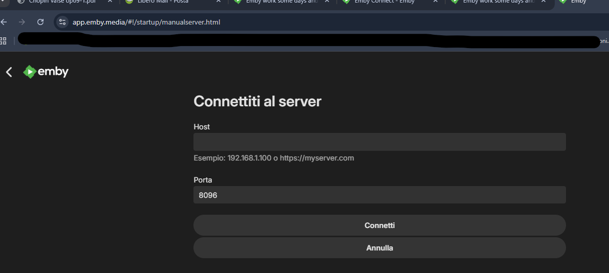

Taglia74 5 Posted October 27, 2025 Author Posted October 27, 2025 Strange things.....I've iserted the mail where you say me to do.....but this is the result after I cancel old server (that can't connect) and i try to connect to server again....I'm logged with right mail and password to my emby account but it is not available a "automatic" mode to connect to my server.....only a IP is required......so nothing change....

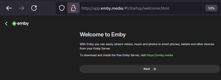

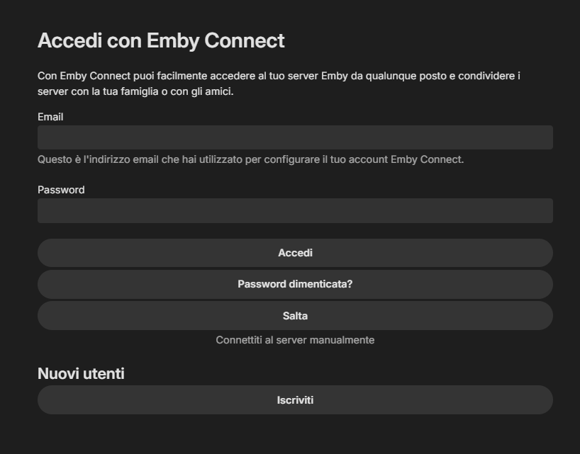

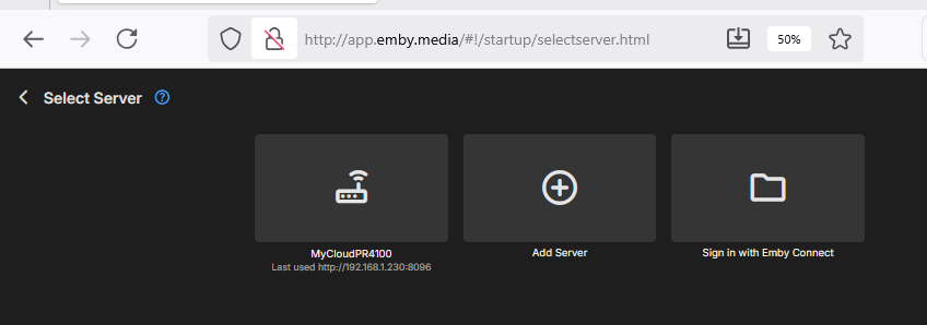

sa2000 703 Posted October 27, 2025 Posted October 27, 2025 Do you get the Sign In with Emby Connect button ? This is on the Select Server screen Do you see a screen like this you could put this in the browser, and see what you get back http://app.emby.media/#!/startup/selectserver.html I am going get you some screenshots using incognito private session to avoid using any cached browser data and show what a fresh sign in should show You can try to clear the browser cache for emby or test with private incognito window So first on going to http://app.emby.media/ you should see this screen ] Next is to do with enabling TV display mode option - you can skip and click Next Then you get the sign in with emby connect screen after you sign in you get to the Select Server screen
Taglia74 5 Posted October 27, 2025 Author Posted October 27, 2025 (edited) 12 minutes ago, sa2000 said: Do you get the Sign In with Emby Connect button ? This is on the Select Server screen Do you see a screen like this you could put this in the browser, and see what you get back http://app.emby.media/#!/startup/selectserver.html I am going get you some screenshots using incognito private session to avoid using any cached browser data and show what a fresh sign in should show You can try to clear the browser cache for emby or test with private incognito window So first on going to http://app.emby.media/ you should see this screen ] Next is to do with enabling TV display mode option - you can skip and click Next Then you get the sign in with emby connect screen after you sign in you get to the Select Server screen Yes I see the same screen but as soon I log in the proposed screen is next one. I can't see signt in with emby connect. My question is......if I log in with my user name or mail and password....why I need to add server....it shoud be available because it is my server and I set it to my server in any device......so why a new device must log again to server.. To me it is not available emby connect button and I don't know why Edited October 27, 2025 by Taglia74
