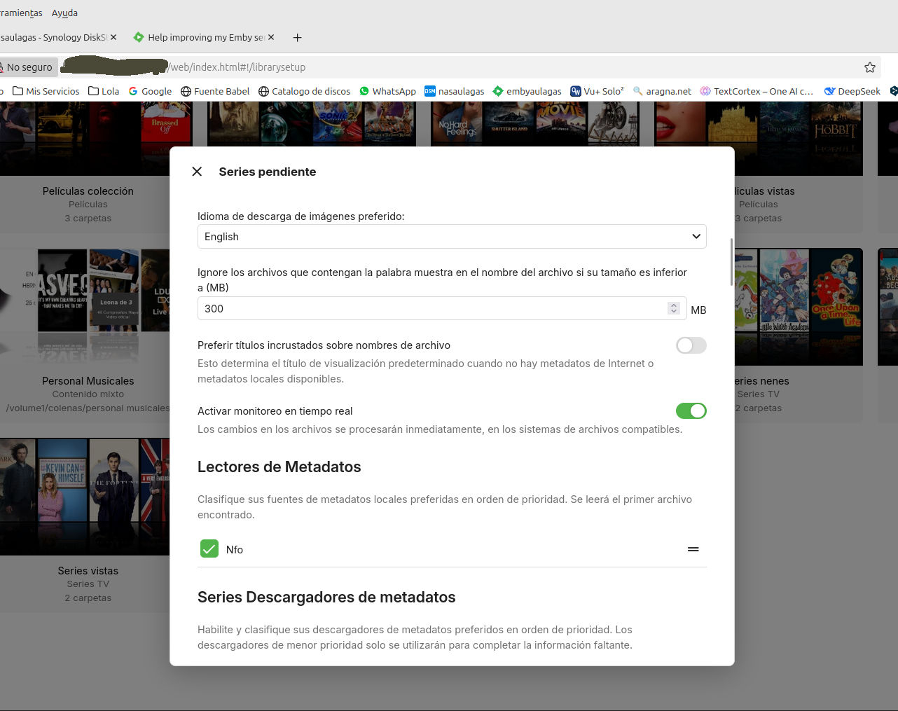

Luke 42239 Posted September 20, 2025 Posted September 20, 2025 Hi, is the realtime monitor enabled in the options of the library?

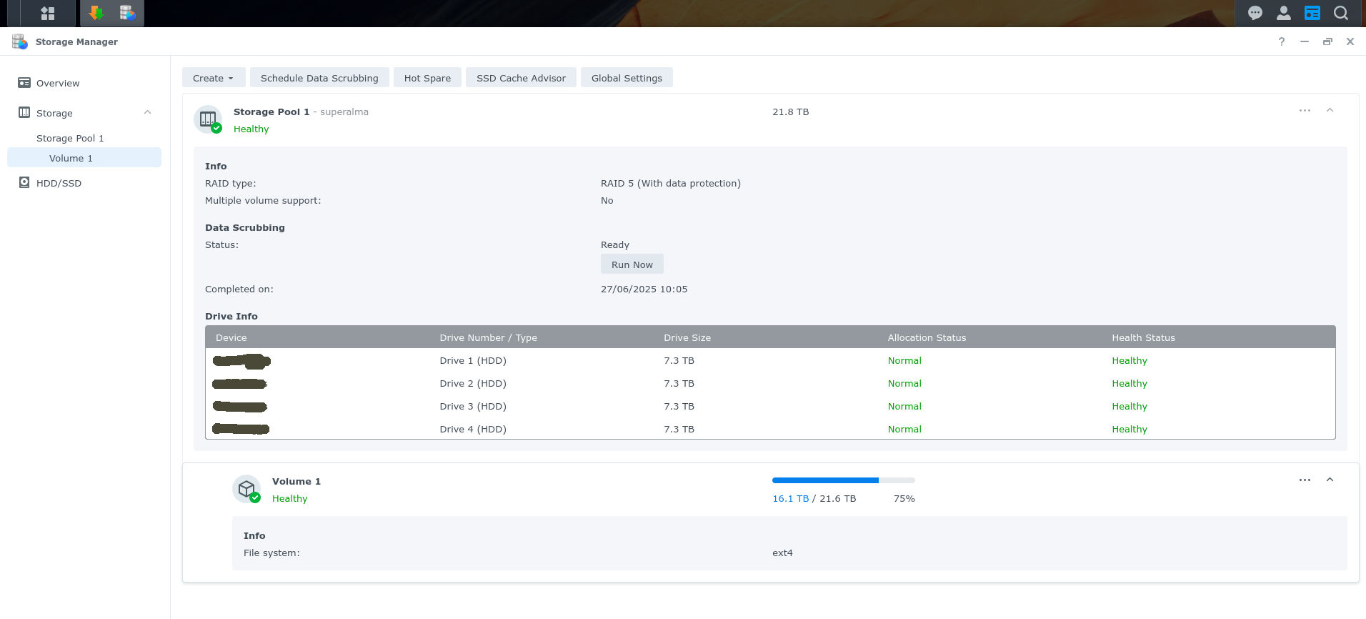

pgell 4 Posted September 21, 2025 Author Posted September 21, 2025 Yes, it is. Don't you think it could be a resources issue? The folder of that library has 4.06 TB in 4473 files and 636 sub-folders. I don't know how the realtime monitor option detect changes in the file system.
pgell 4 Posted September 21, 2025 Author Posted September 21, 2025 Yes. All the media of the emby server is in an ext4 file system over a 21.8 TB RAID5 unit, built with four 7.3 TB drives.
