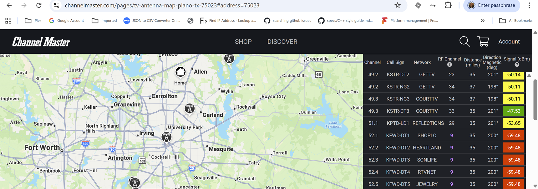

sa2000 695 Posted September 19, 2025 Posted September 19, 2025 @LyfesaverGot a reply from Gracenote but not the answer I was expecting Quote Channel contact has confirmed our listings are correct as is. No changes are needed. Is it possible you are accessing a channel aimed at a different timezone ? What is the city? and which antenna would be picking from - we can see reported signal level on channelmaster
Lyfesaver 135 Posted September 19, 2025 Author Posted September 19, 2025 4 hours ago, sa2000 said: @LyfesaverGot a reply from Gracenote but not the answer I was expecting Is it possible you are accessing a channel aimed at a different timezone ? What is the city? and which antenna would be picking from - we can see reported signal level on channelmaster Channelmaster? I am in Dallas and I am using the long distance HDTV antenna high on the roof of our house.

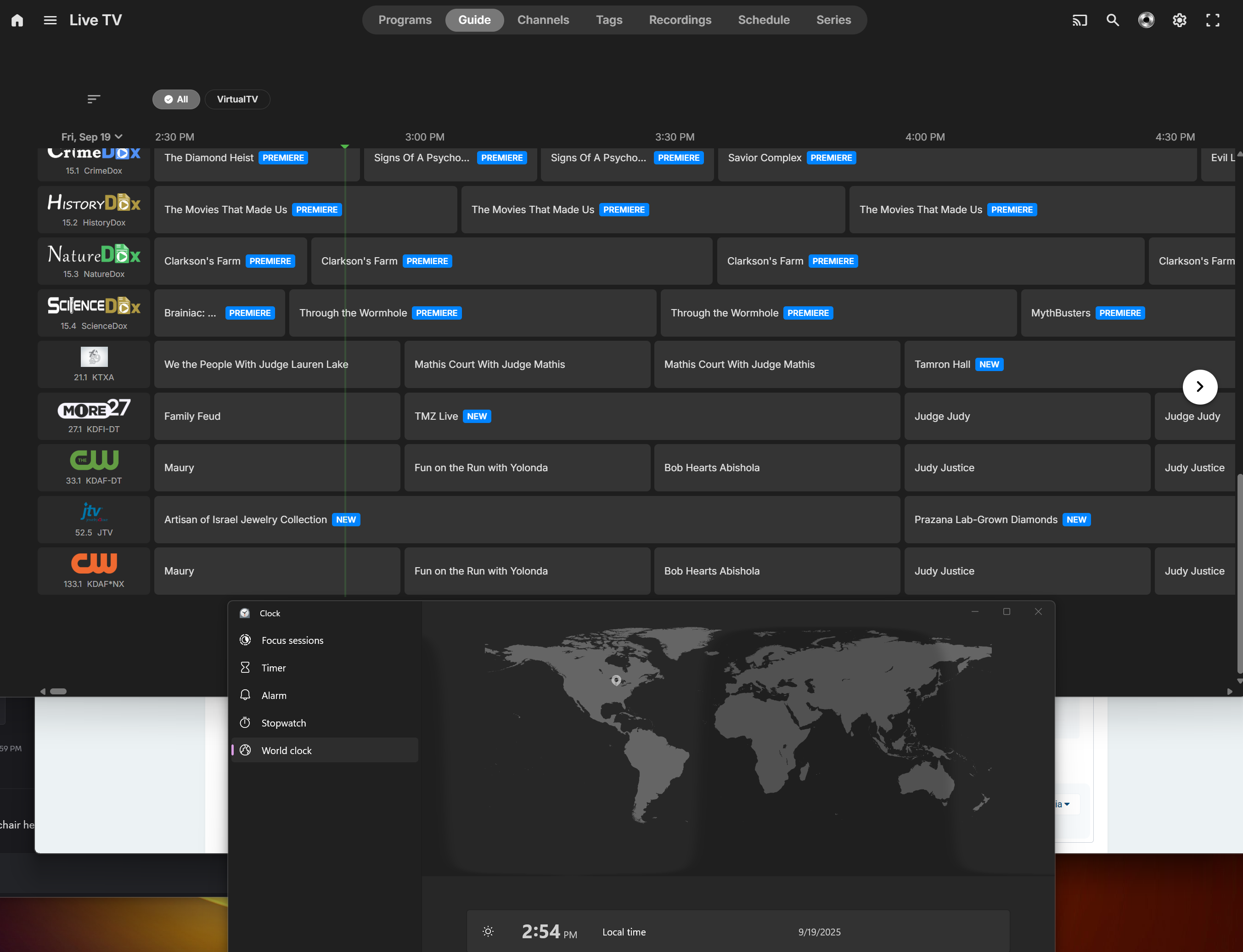

sa2000 695 Posted September 19, 2025 Posted September 19, 2025 Your lineup ID showed 75023 as your zip code - is that your actual zip code and could you send me proof with screenshots showing time and program airing abd the guide info and confirmation that the machine is running at right timezone
Lyfesaver 135 Posted September 19, 2025 Author Posted September 19, 2025 8 minutes ago, sa2000 said: Your lineup ID showed 75023 as your zip code - is that your actual zip code and could you send me proof with screenshots showing time and program airing abd the guide info and confirmation that the machine is running at right timezone Plano, TX 75023 is my city and zip and you want screenshots of what? Yes my server is running the correct time zone We are recording everything else on time, just 52.5 is off by an hour

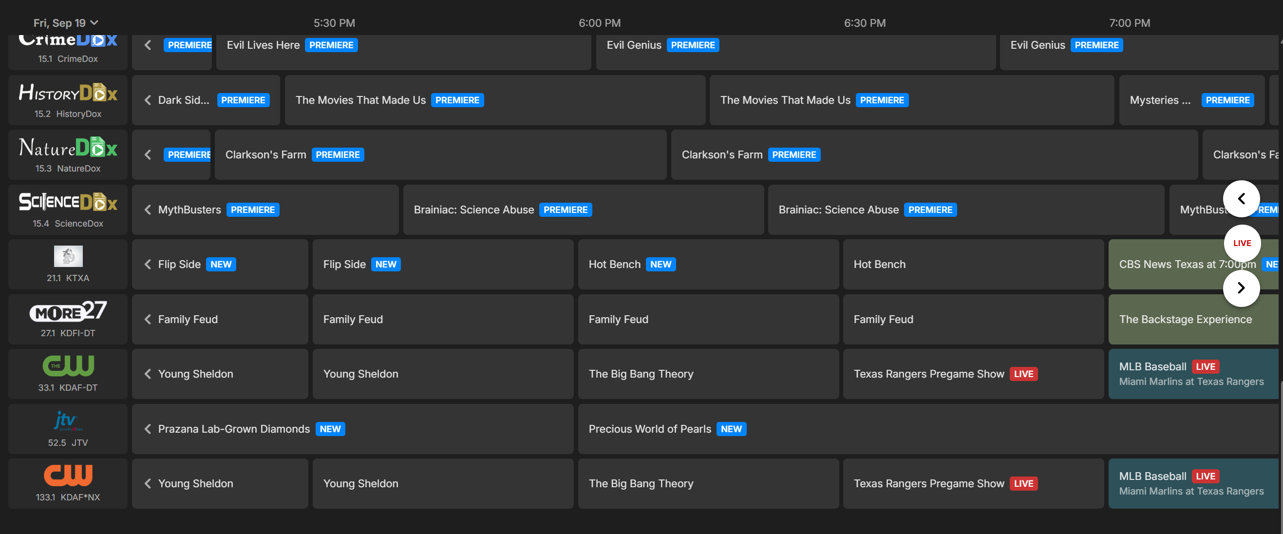

sa2000 695 Posted September 19, 2025 Posted September 19, 2025 12 minutes ago, Lyfesaver said: and you want screenshots of what? I wanted some proof that 52.5 airing is an hour off - probably need to get the screenshots of the guide and the TV airing when it starts a new airing that is not the same as one before it. So probably all 3 best to do when Prazana-Lan Grown starts
sa2000 695 Posted September 19, 2025 Posted September 19, 2025 1 hour ago, Lyfesaver said: Channelmaster? This is what I was referring to https://www.channelmaster.com/pages/tv-antenna-map-plano-tx-75023#address=75023 which shows the channels as very weak signals for this zip code - which is why I asked if that channel was intended to be for your area. Having a good aerial is not relevant to the issue.
Lyfesaver 135 Posted September 19, 2025 Author Posted September 19, 2025 7 minutes ago, sa2000 said: I wanted some proof that 52.5 airing is an hour off - probably need to get the screenshots of the guide and the TV airing when it starts a new airing that is not the same as one before it. So probably all 3 best to do when Prazana-Lan Grown starts
sa2000 695 Posted September 19, 2025 Posted September 19, 2025 (edited) so from the earlier screenshot we know prazana was starting at about 4pm. Do you have proof / screen to show that this did not happen at 4pm ? Some tangible evidence to pass to Gracenote and to ask them why they think it is right Timezone is showing as UTC-5 (is that with Day Light Saving?) Edited September 19, 2025 by sa2000
Lyfesaver 135 Posted September 19, 2025 Author Posted September 19, 2025 It's not 4pm yet, only 3:30 but I would not have any way of proving it that I know of
sa2000 695 Posted September 19, 2025 Posted September 19, 2025 Are you able to establish which market / geographic region this channel broadcast is aimed for ? Having very weak signal showing in channel master suggests it is not aimed for your zip code
Lyfesaver 135 Posted September 19, 2025 Author Posted September 19, 2025 29 minutes ago, sa2000 said: Are you able to establish which market / geographic region this channel broadcast is aimed for ? Having very weak signal showing in channel master suggests it is not aimed for your zip code
