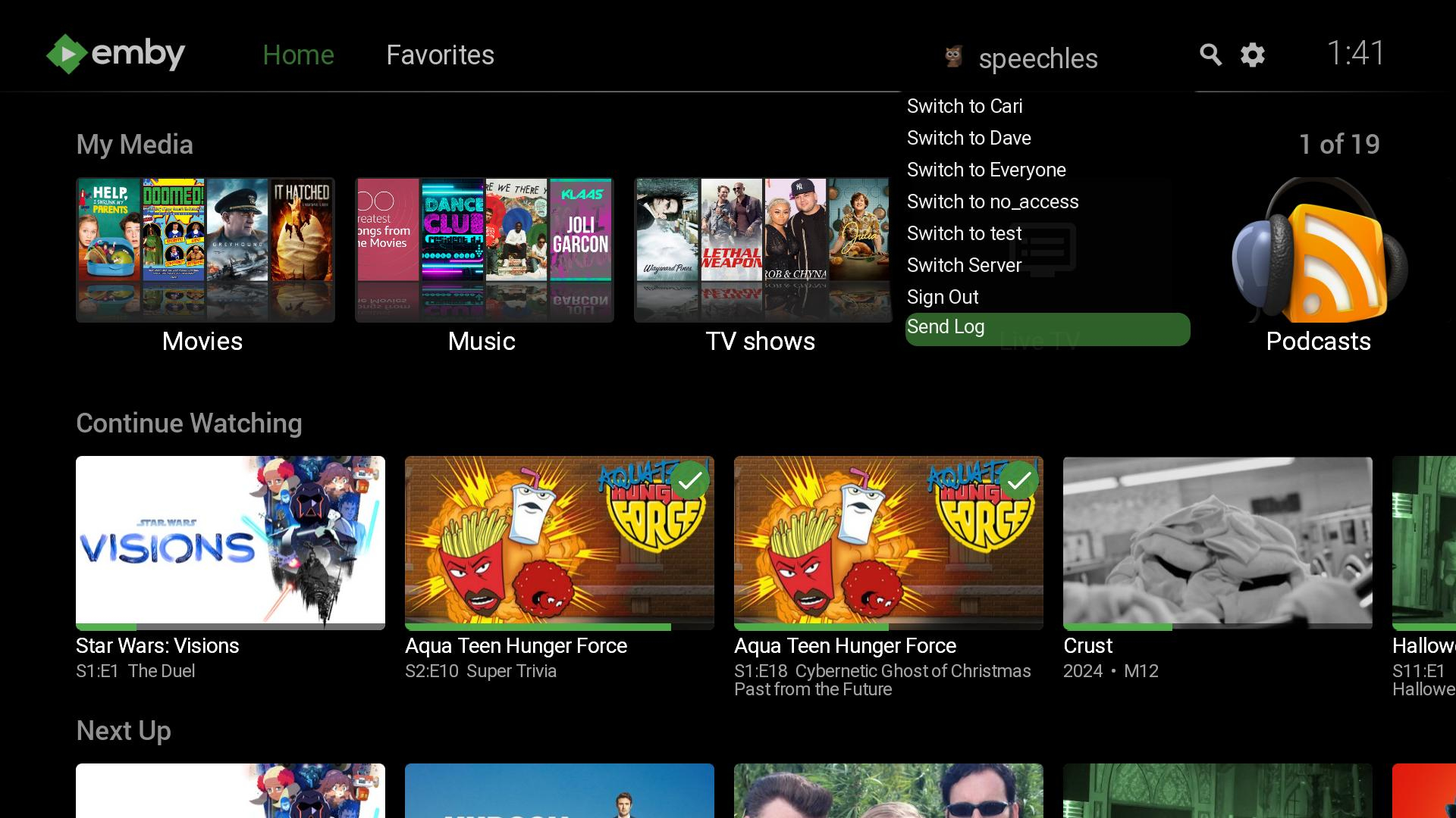

speechles 2062 Posted September 20, 2025 Posted September 20, 2025 (edited) The logs you posted in this thread in the ODT format do not have any playback attempts. It also looks like the server is still scanning things. Have you run a full library scan of everything and let it finish? Once you enable debug you have to exit the app and restart it. The app must start in a debug state fresh. Once you do this you recreate the problem then go back to the homescreen and navigate up to your username at top and click. Then the menu shown above will appear. At the bottom is the Send Logs option. The Roku is poor at subtitle support. No graphical subtitle support is available. All graphical subtitles must be burned into the video stream. The Roku only supports text subtitles with no fonts/formatting/adjustments. At this time we only support what Roku does or we suggest you burn the ASS/SSA subtitles into the video using the option found in the Roku app settings. We do not have a custom subtitle parser in the app at this time. Make sure to disable the debug option in the app once you have sent the logs. There are numerous messages saved into the Roku on-device-log when you enable this and if you navigate around quickly it may bog down the Roku and cause slowdowns for you. Only leave the debug option enabled while you are attempting to recreate the issue and send us logs. Thanks. Edited September 20, 2025 by speechles
