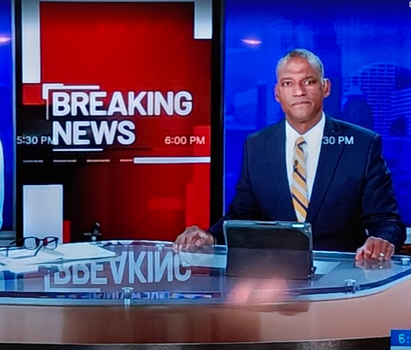

Brian_Oblivion 4 Posted September 18, 2025 Author Posted September 18, 2025 I've tried using the android version and it's mess on the fire cube anyways. Freezes, hangs, unstable in general. Get random weird artifacts like pieces of the channel guide suddenly getting overlaid onto the stream/show. Fire tv version has it issues but is at least stable. Seems to be a myriad of issues in play. e.g. left the room, this was one, then came back and parts of the screen guide were showing. e.g.
