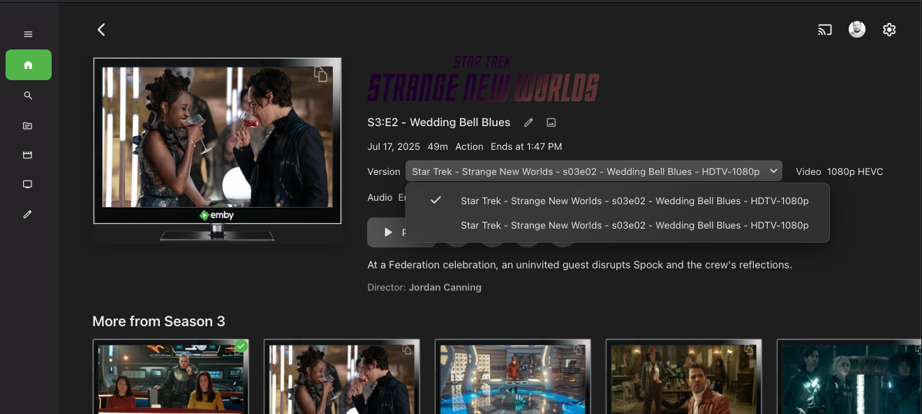

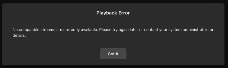

gudvardur 0 Posted September 12, 2025 Posted September 12, 2025 Hi all, I have two Libraries, TV Shows and Movies... Under each, I had two folder locations.... Both of that folder locations sometimes (often) had the same content... Now I removed one of the folder locations from each library so now there is only one folder location in each Library... However, Emby still keeps versions of older content that existed in the removed location and I'm unable to play any content unless I select the other version... I've tried rescaning both libraries... I've tried to refresh metadata and allow it to overwrite... neither of those seem to work... How can I remove all versions that point to this old location?

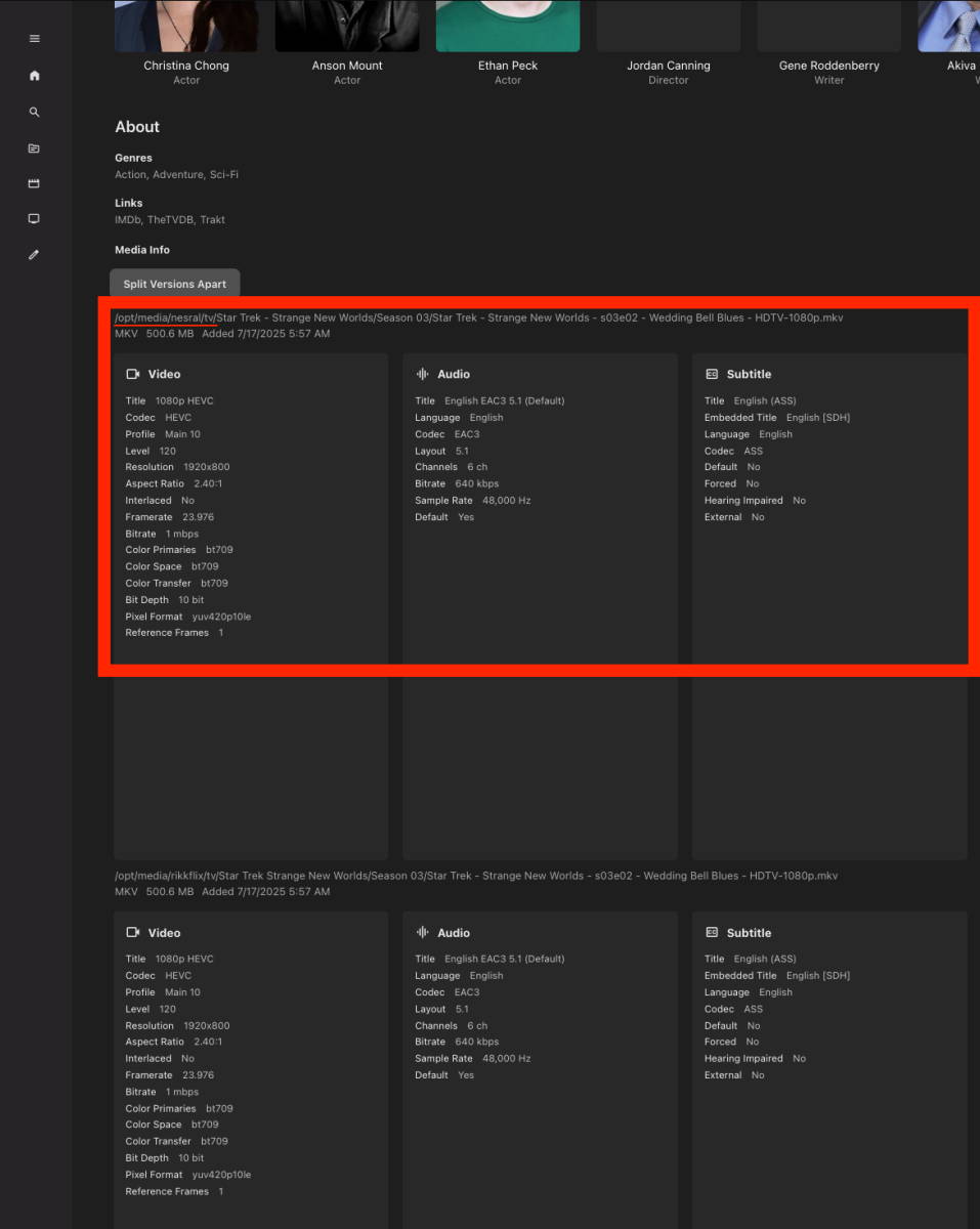

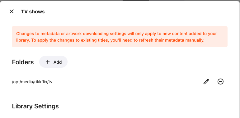

gudvardur 0 Posted September 12, 2025 Author Posted September 12, 2025 Sure thing... For example this specific episode I can't play unless I Select the lower version that is located in /opt/media/rikflix/tv, the upper version was located in /opt/media/nesral/tv I had both /opt/media/rikflix/tv and /opt/media/nesral/tv in the Folder list below... and this episode (obove) existed in both folders... This picture below reflects how the Library is currently configured... But then I needed to remove /opt/media/nesral/tv and now I'm unable to play this episode (And many other TV shows that existed on both locations), I can play this episode if I select the lower version like shown in the top picture that points to /opt/media/rikflix/tv.....

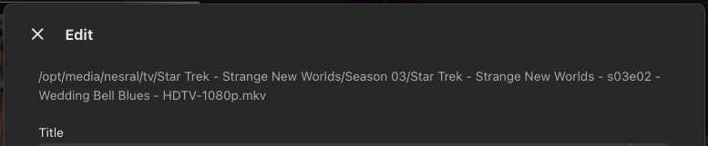

gudvardur 0 Posted September 12, 2025 Author Posted September 12, 2025 From embyserver logs... 3520268 -bufsize:v:0 7040536 -sc_threshold:v:0 0 -keyint_min:v:0 72 -r:v:0 23.976024627685547 -pix_fmt:v:0 yuv420p -preset:v:0 veryfast -profile:v:0 high -x264opts:v:0 "subme=0:me_range=4:rc_lookahead=10:partitions=none" -crf:v:0 23 -c:a:0 aac -ab:a:0 192000 -ac:a:0 2 -metadata:s:a:0 language=eng -filter:a:0 "volume=2" -disposition:a:0 default -max_delay 5000000 -avoid_negative_ts disabled -f segment -map_metadata -1 -map_chapters -1 -segment_format mpegts -segment_list "/var/lib/emby/transcoding-temp/C16CFE/C16CFE.m3u8" -segment_list_type m3u8 -segment_time 00:00:03.000 -segment_start_number 0 -individual_header_trailer 0 -write_header_trailer 0 -segment_write_temp 1 "/var/lib/emby/transcoding-temp/C16CFE/C16CFE_%d.ts" 13:02:04.101 ffmpeg version 5.1-emby_2023_06_25 Copyright (c) 2000-2022 the FFmpeg developers and softworkz for Emby LLC 13:02:04.101 built with gcc 10.3.0 (crosstool-NG 1.25.0) 13:02:04.101 Execution Date: 2025-09-12 13:02:04 13:02:04.105 /opt/media/nesral/tv/Star Trek - Strange New Worlds/Season 03/Star Trek - Strange New Worlds - s03e02 - Wedding Bell Blues - HDTV-1080p.mkv: No such file or directory 13:02:04.105 EXIT
gudvardur 0 Posted September 12, 2025 Author Posted September 12, 2025 So bottom line, how can I get rid of all versions that point to the old location /opt/media/nesral/tv from my server? And keep /opt/media/rikkflix/tv version...
