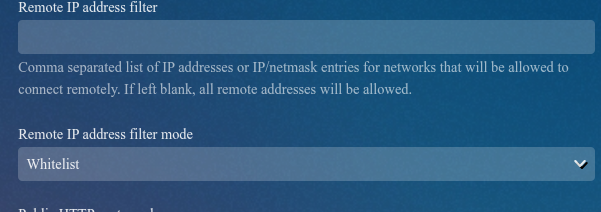

Normanos 13 Posted September 12, 2025 Posted September 12, 2025 Shot in dark, can't be because Remote filter mode is "blacklist? I using nginx proxy for SSL, but I have "whitelist"
AlanBatie 5 Posted September 12, 2025 Author Posted September 12, 2025 It says "if left blank, all remote addresses will be allowed", but grasping at straws...and it didn't help

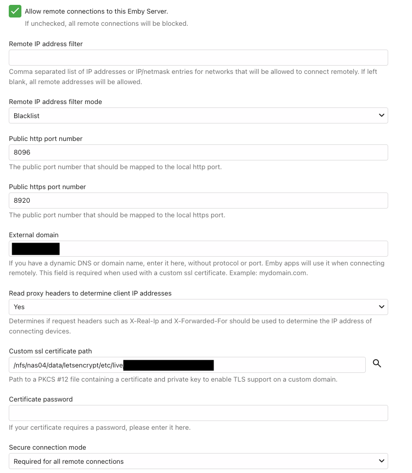

GrimReaper 4896 Posted September 12, 2025 Posted September 12, 2025 58 minutes ago, AlanBatie said: the .nfo file doesn't exist, so no surprise it can't access it... If it were only files not present, error would've been different, but sure. 59 minutes ago, AlanBatie said: Remote (WAN) access: http://[redacted]:8096 Can you share a screenshot of the first part of your Network settings?
Q-Droid 1011 Posted September 12, 2025 Posted September 12, 2025 2 hours ago, AlanBatie said: There was something wonky with my ipv6, which is probably why those are timing out, but that would have nothing to do with emby not listening on the https port, and that's been fixed now in any case... What's fixed, the IPv6 or HTTPS issues? The LE path has PEM (base64) certs and not the keystore format that Emby needs which is PKCS12. You have to create a keystore for Emby using those LE certs and preferably put that file in a different path and owned or readable by user emby.
Luke 42242 Posted September 12, 2025 Posted September 12, 2025 What is the file extension of your certificate?
AlanBatie 5 Posted September 12, 2025 Author Posted September 12, 2025 It was ipv6 that was fixed; I have a letsencrypt posthook that makes a pkcs12 file openssl pkcs12 -password xxx -export -in fullchain.pem -inkey privkey.pem -out combined.pfx chmod 644 combined.pfx 1 1
Solution AlanBatie 5 Posted September 13, 2025 Author Solution Posted September 13, 2025 Problem solved after I started the server manually to strace it and discovered that it worked when I started it manually as root - it was a permission problem on the letsencrypt live/archive directories - a shared nfs directory that got changed to fix a problem on another server. Both are using the ssl group now. This would have been a simple diagnosis if the access problem had gotten logged...
