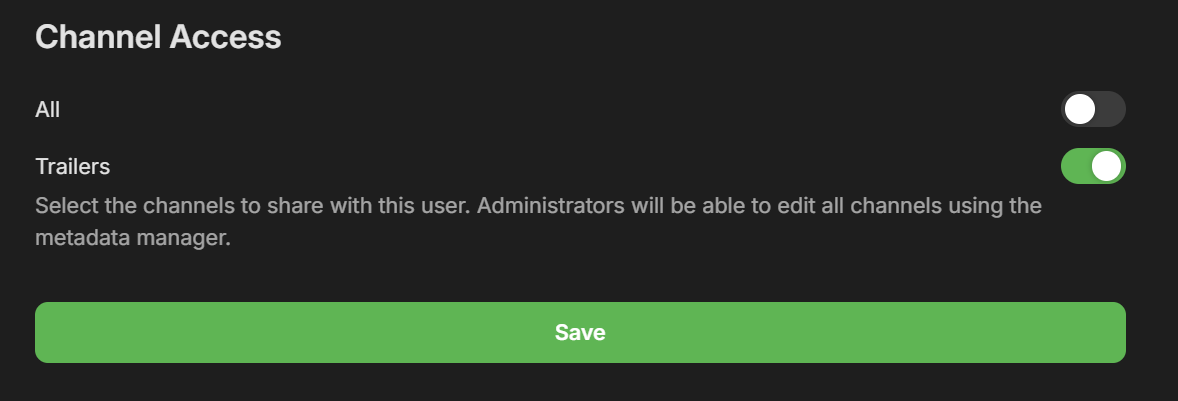

embyzone 5 Posted September 9, 2025 Posted September 9, 2025 (edited) Hi All For one user I have the Trailer library and for another I dont? I have checked and the plugin is installed and working its just not visible for another user? Both users have admin rights/can control the server. Is there anyway to manually just add the Trailer library for this user? I suspect that this user have deleted the Trailer library at some point? So maybe some config file where I can enable it? Thanks for any input on this I have done everything but uninstalling it and reinstalling it (Dont want to scan everything again) Update: I have it selected under the account tried both Trailer and all: Edited September 9, 2025 by embyzone

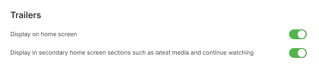

GrimReaper 4926 Posted September 9, 2025 Posted September 9, 2025 Does the user that doesn't see it has it enabled in user Home Screen settings? Maybe they have disabled it?
embyzone 5 Posted September 9, 2025 Author Posted September 9, 2025 So I ended up removing the trailer plugin and did a reboot installed it again and did a reboot. Same as before the old user have a Trailer library and all new users dont have it?
embyzone 5 Posted September 9, 2025 Author Posted September 9, 2025 This is a funny "feature/bug" if I go to home screen and find trailer and enable it to show! Then it works! But the user cant see it in Library under server management. The other admin can see it both places. Anyway I think that is fine - now he can see it on the main screen. Only benefit is when you want to change media poster or other things then its nice to have it under library management. Thanks! GrimReaper hadnt thought of that!
