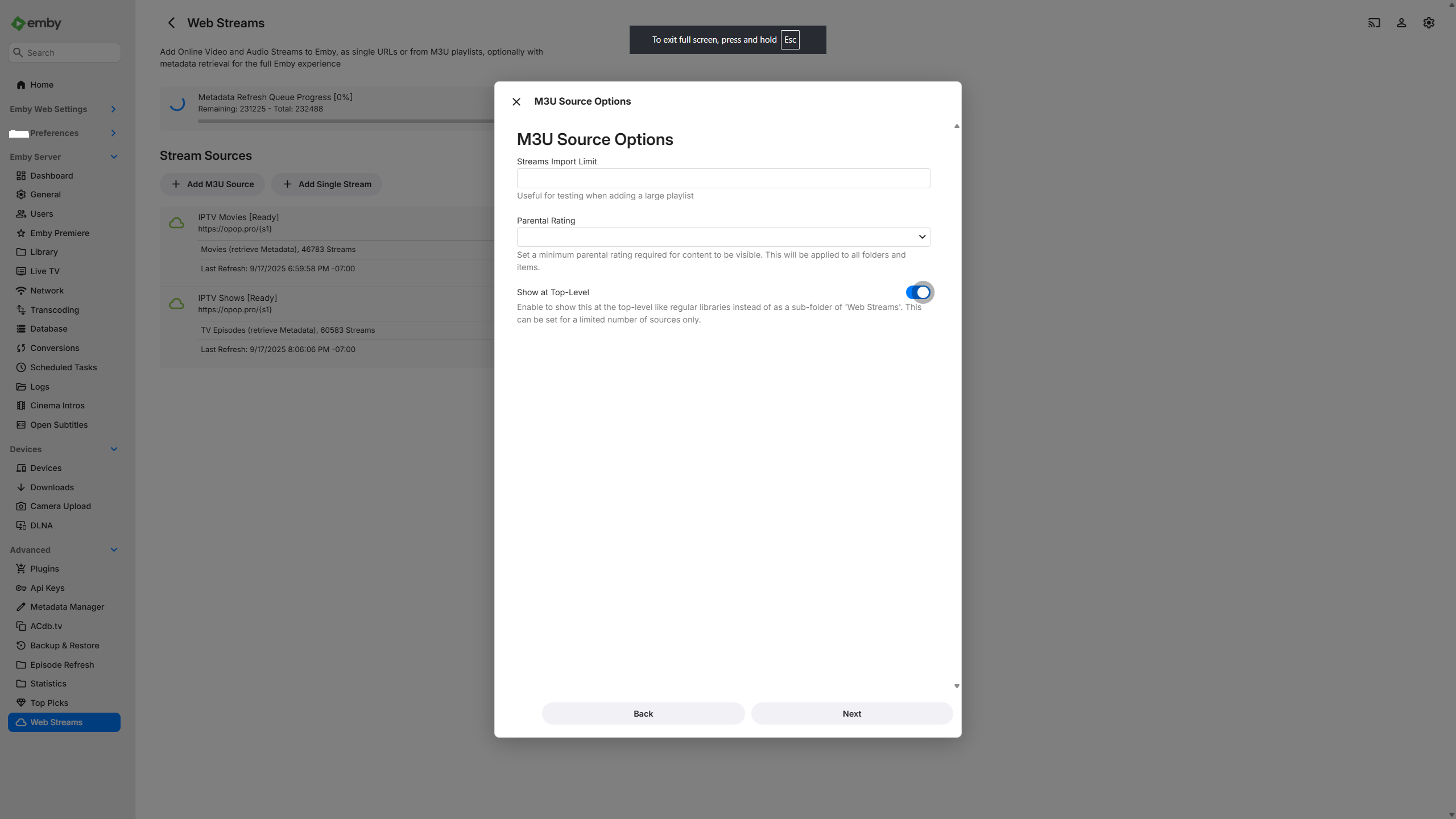

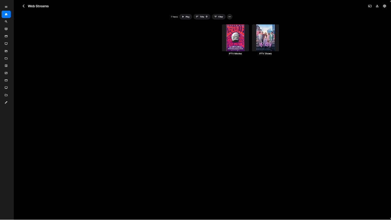

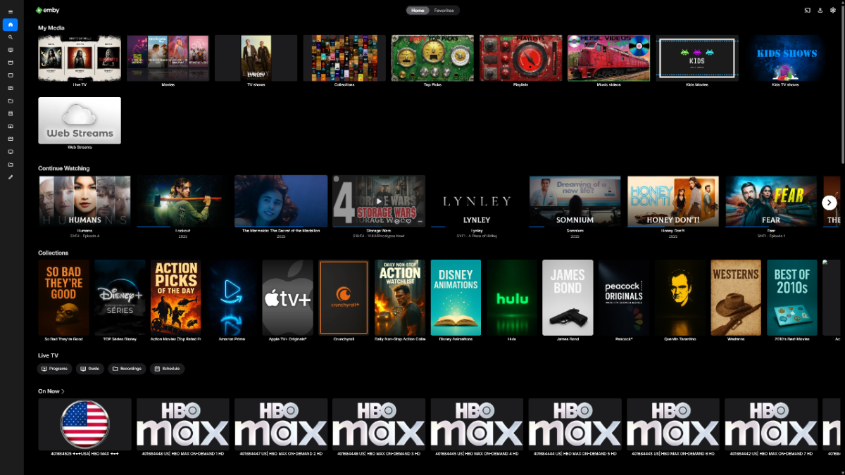

ryzen5000 17 Posted September 18, 2025 Posted September 18, 2025 (edited) I have a few questions about the Web Streams Plugin. I selected the option for the movie and tv folders to be displayed top level, but they are visible only inside the Web Streams folder as subfolders still. Is there a configuration setting to fix this? For Movies, I left default settings besides the settings I mentioned already for Movies and to select it as a movie library, they are appearing as library items which is great. But can there be backdrops added to the movies? The TV shows I added are still scanning and its been several hours for only 2438 TV Series, while the 46783 Movies scanned very fast, in just a few minutes I saw nice movie posters. The Tv series also are only displaying as individual episodes and there is no metadata images from the TVDB. Is there additional configuration that is required for them to get posters and look like regular library items? Edited September 18, 2025 by ryzen5000 typo
Luke 42246 Posted September 18, 2025 Author Posted September 18, 2025 1 hour ago, ryzen5000 said: I have a few questions about the Web Streams Plugin. I selected the option for the movie and tv folders to be displayed top level, but they are visible only inside the Web Streams folder as subfolders still. Is there a configuration setting to fix this? For Movies, I left default settings besides the settings I mentioned already for Movies and to select it as a movie library, they are appearing as library items which is great. But can there be backdrops added to the movies? The TV shows I added are still scanning and its been several hours for only 2438 TV Series, while the 46783 Movies scanned very fast, in just a few minutes I saw nice movie posters. The Tv series also are only displaying as individual episodes and there is no metadata images from the TVDB. Is there additional configuration that is required for them to get posters and look like regular library items? HI there, can you please provide a specific example? How to Report a Problem Thanks !

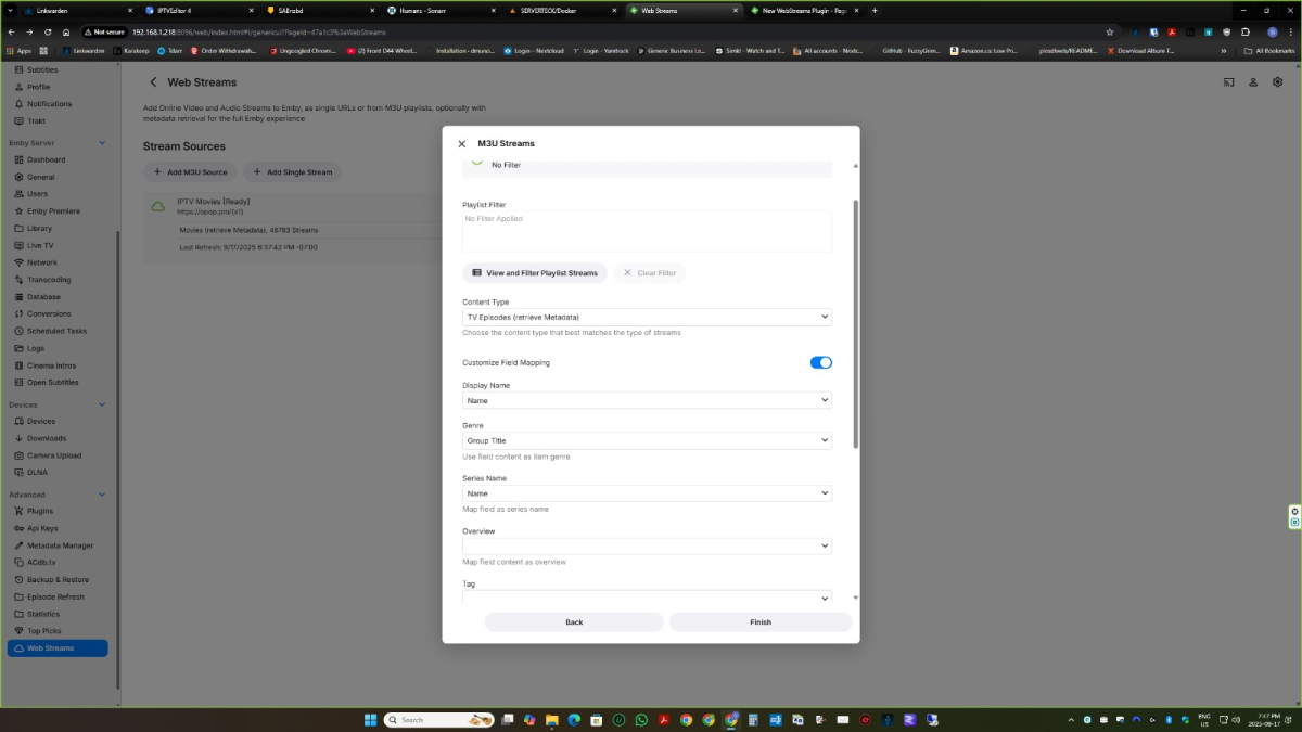

ryzen5000 17 Posted September 18, 2025 Posted September 18, 2025 Yes, I can provide images of the series folders missing, the subfolders appear when I selected the option for them to be displayed at top level. The settings I used for series Is there something I need to configure differently?
softworkz 5133 Posted September 18, 2025 Posted September 18, 2025 14 hours ago, ryzen5000 said: I selected the option for the movie and tv folders to be displayed top level, but they are visible only inside the Web Streams folder as subfolders still. Is there a configuration setting to fix this? This is broken and requires a fix to the server. 14 hours ago, ryzen5000 said: For Movies, I left default settings besides the settings I mentioned already for Movies and to select it as a movie library, they are appearing as library items which is great. But can there be backdrops added to the movies? The TV shows I added are still scanning and its been several hours for only 2438 TV Series, while the 46783 Movies scanned very fast, in just a few minutes I saw nice movie posters. The Tv series also are only displaying as individual episodes and there is no metadata images from the TVDB. Is there additional configuration that is required for them to get posters and look like regular library items? All broken but already fixed in an update to the plugin.

ryzen5000 17 Posted September 19, 2025 Posted September 19, 2025 "All broken but already fixed in an update to the plugin." I will wait for the release of the new version then. My settings must be correct because I tested by setting a limit to 50 series from m3u and it created some of the series folders at the very bottom of the list while others at the top remain just as episodes still. When allowing the whole m3u to with no limits It creates only 2 series folders. But there is backdrops on the tv series that did show up.
softworkz 5133 Posted September 19, 2025 Posted September 19, 2025 53 minutes ago, ryzen5000 said: I will wait for the release of the new version then Yea, that's what I was hinting at - it would just be wasted energy..

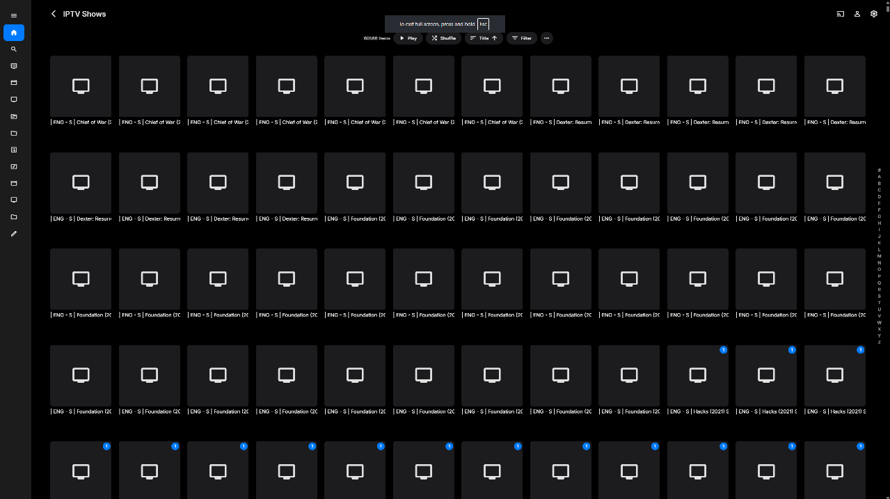

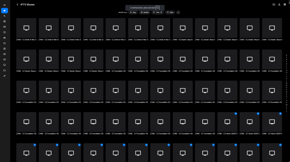

horstepipe 423 Posted September 20, 2025 Posted September 20, 2025 wondering, why is there no "Apply Grouping" for TV shows content type? There are lots of duplicates in German media libraries. BR 1
horstepipe 423 Posted September 20, 2025 Posted September 20, 2025 or did I get the functionality wrong of that feature? Isn't it to remove/merge duplicates from different m3us?
softworkz 5133 Posted September 20, 2025 Posted September 20, 2025 2 hours ago, horstepipe said: wondering, why is there no "Apply Grouping" for TV shows content type? There are lots of duplicates in German media libraries. In this case, the grouping is not available because it is used internally for grouping into Series > Seasons > Episodes 2 hours ago, horstepipe said: or did I get the functionality wrong of that feature? Isn't it to remove/merge duplicates from different m3us? No. Different m3us are always treated separate and independent from others. The grouping allows you to create subfolders. For example, when you would choose Genre and Country as group fields, you would see a folder for your source with the name you gave it at the top. Entering that folder, you would see a collection of genre folders (only genres that are present in your streams list) and entering a genre folder gives you a list of countries for which items exist that are having that genre. Entering a country folder will show you all streams having that genre and that country
