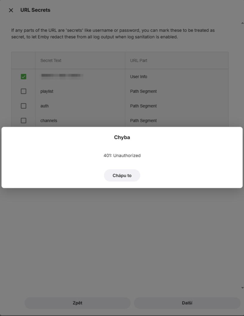

archecon 11 Posted September 8, 2025 Posted September 8, 2025 (edited) On 9/8/2025 at 4:05 PM, softworkz said: Did you try it? Doesn't it work? I don't remember exactly, but I believe it had been tested successfully. Yes we tested this. But doesnt work. :-(. For example IP TV PRO light client for android /android TV too/ works correctly. Edited September 16, 2025 by softworkz
softworkz 5133 Posted September 8, 2025 Posted September 8, 2025 3 minutes ago, archecon said: Yes we tested this. But doesnt work. :-(. @archecon - at which point exactly did it "not work" - what did you see?
archecon 11 Posted September 8, 2025 Posted September 8, 2025 26 minutes ago, softworkz said: @archecon - at which point exactly did it "not work" - what did you see? Authorize fail. At first I did not talk about the error. I didn't know if authentication was implemented. When you try to define m3u using a url link, an authentication error occurs.

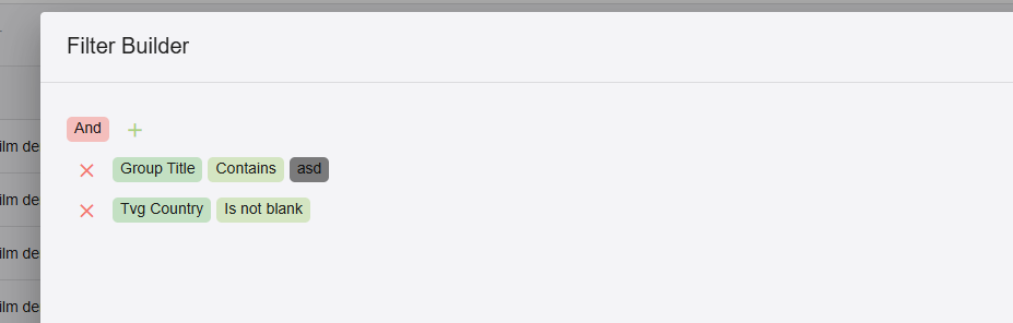

GrimEvil 73 Posted September 8, 2025 Posted September 8, 2025 I have tested the plugin and have some feed back/questions 1. we need an option to set where the plugin stores the library as it can be quite large, so need to be able to locate it in a different drive/location. 2. Can you exclude groups as I could not figure out how to do this. 3. Can you integrate it directly into the built in libraries, so it would for example show movies in the movies library instead of a separate one.

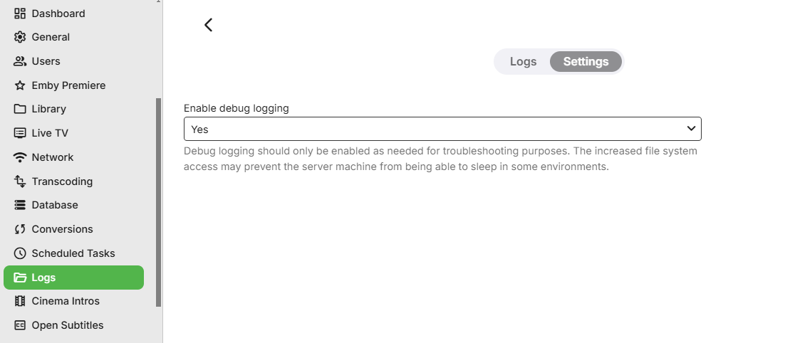

softworkz 5133 Posted September 8, 2025 Posted September 8, 2025 10 minutes ago, archecon said: Authorize fail. At first I did not talk about the error. I didn't know if authentication was implemented. When you try to define m3u using a url link, an authentication error occurs. Okay, can you please enable debug logging (like below) and restart the server. Then, try to add the URL once again and finally post the server log (double check that your password has been redacted).
softworkz 5133 Posted September 8, 2025 Posted September 8, 2025 6 minutes ago, grimevil said: I have tested the plugin and have some feed back/questions 1. we need an option to set where the plugin stores the library as it can be quite large, so need to be able to locate it in a different drive/location. The plugin doesn't store anything. It integrates streams that are available on the web into Emby - that's why it's called "WebStreams" 6 minutes ago, grimevil said: 2. Can you exclude groups as I could not figure out how to do this. Go to the entry in the plugin config, click the 3-dot menu and choose "Edit Filer" There, click the filter button: Then you'll see a grid that is showing all entries, and the grid provides lots of ways for filtering. You can enter values in the filter row, click on the magnifier icon to change the match type You can click on the funnel icons in the headers (Excel-like filters) You can click on "Create Filter" at the bottom left to build custom filters just as you like: The primary rule is: The filtered result is what you see in the grid. Finally, click on "Save" to persist the filter. 6 minutes ago, grimevil said: 3. Can you integrate it directly into the built in libraries, so it would for example show movies in the movies library instead of a separate one. No, this isn't possible. But there is an option to show a WebStreams collection as a top-level library (making it look the same as normal library) 1
archecon 11 Posted September 8, 2025 Posted September 8, 2025 38 minutes ago, softworkz said: Okay, can you please enable debug logging (like below) and restart the server. Then, try to add the URL once again and finally post the server log (double check that your password has been redacted). embyserver.txt
softworkz 5133 Posted September 8, 2025 Posted September 8, 2025 Ok, thanks. Does that URL work in a browser? If it does work in a browser but not in Emby, then it's often due to the user agent string. What you can try is to enable advanced options in the WebStreams config and paste the following line for the user agent header: Mozilla/5.0 (Windows NT 10.0; Win64; x64) AppleWebKit/537.36 (KHTML, like Gecko) Chrome/140.0.0.0 Safari/537.36 Edg/140.0.0.0
archecon 11 Posted September 8, 2025 Posted September 8, 2025 40 minutes ago, softworkz said: Ok, thanks. Does that URL work in a browser? If it does work in a browser but not in Emby, then it's often due to the user agent string. What you can try is to enable advanced options in the WebStreams config and paste the following line for the user agent header: Mozilla/5.0 (Windows NT 10.0; Win64; x64) AppleWebKit/537.36 (KHTML, like Gecko) Chrome/140.0.0.0 Safari/537.36 Edg/140.0.0.0 Edge, Brave, Yandex works. A try editing user agents, but plugin still 401 error.
rekit 16 Posted September 8, 2025 Posted September 8, 2025 On 9/7/2025 at 2:38 PM, Luke said: Hi, as soon as 4.9 releases. Any day now. 4.9 looks to be a massive update. looking forward to seeing all the hard work put into it 1
softworkz 5133 Posted September 8, 2025 Posted September 8, 2025 2 hours ago, archecon said: Edge, Brave, Yandex works. A try editing user agents, but plugin still 401 error. Thanks. When I try the same URL with fantasy user/password, I get 403 instead of 401. You can verify by trying with a wrong password. This means that the authentication is actually working, but the server doesn't like the request for some other reason. We'll have to debug this with a working account and see in which ways the browsers' request it different from ours and mimic that behavior. At the time of development, referrer and user agent were the most typical request headers that made providers reject requests, that's why these are available under "Advanced Options". Some time has passed, and there may be new criteria based on which providers might reject requests...

softworkz 5133 Posted September 9, 2025 Posted September 9, 2025 (edited) 21 minutes ago, archecon said: This work correct, but there are not basic auth.. Like I said above: Basic auth is not the problem in your case. It's something else that your provider expects and that we don't send in the request. Edited September 9, 2025 by softworkz
softworkz 5133 Posted September 9, 2025 Posted September 9, 2025 (edited) 15 hours ago, softworkz said: Thanks. When I try the same URL with fantasy user/password, I get 403 instead of 401. You can verify by trying with a wrong password. This means that the authentication is actually working, but the server doesn't like the request for some other reason. We'll have to debug this with a working account and see in which ways the browsers' request it different from ours and mimic that behavior. At the time of development, referrer and user agent were the most typical request headers that made providers reject requests, that's why these are available under "Advanced Options". Some time has passed, and there may be new criteria based on which providers might reject requests... One thing you can try as a temporary workaround is to download the m3u to a file location on the server and then choose "Local File": Edited September 9, 2025 by softworkz

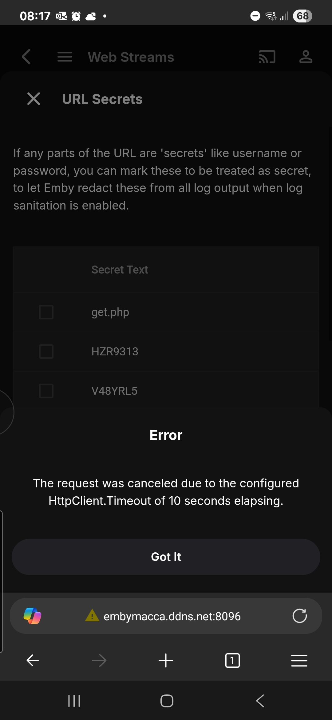

gillmacca01 220 Posted September 10, 2025 Posted September 10, 2025 (edited) Thought i would give this a try, but ran into an issue when I added my ip tv m3u url Edited September 16, 2025 by softworkz
softworkz 5133 Posted September 10, 2025 Posted September 10, 2025 (edited) On 9/10/2025 at 9:20 AM, gillmacca01 said: Thought i would give this a try, but ran into an issue when I added my ip tv m3u url How long does it take when you download the list via a browser? The 10s timeout is not the time for completing the download but the time until the first response. It is chosen to be relatively short, because it's unlikely that it would work when there's not a single byte of response after 10s. You can also download manually and add the m3u from the file system (see above). Edited September 16, 2025 by softworkz
gillmacca01 220 Posted September 10, 2025 Posted September 10, 2025 (edited) Approx 22 seconds. I know i can download manually, but that really defeats of having an automated system. I would have to remember to download every day to make sure it's uptodate The same url downloads fine in live tv Edited September 10, 2025 by gillmacca01
softworkz 5133 Posted September 10, 2025 Posted September 10, 2025 1 hour ago, gillmacca01 said: Approx 22 seconds. I know i can download manually, but that really defeats of having an automated system. I would have to remember to download every day to make sure it's uptodate The same url downloads fine in live tv Yea, of course a manual download is not the desired solution. I just mentioned it as an immediate remedy to get past this limitation. I'd still like to understand what's happening exactly. Could you please: Open a new browser tab Press F12 to open dev tools Switch to the network tab in dev tools Make sure that the "Waterfall" column is visible If not, right-click any column header, then click on Waterfall to make the column visible Paste the m3u URL in the browser tab Look at the network tab Hover the mouse over the Waterfall column item entry (containing some color bars) until the popup is shown Press WIN+SHIFT+S or the Print key to make a screenshot of the popup It should look like this: (note: instructions are for Chromium based browsers) Thanks!
