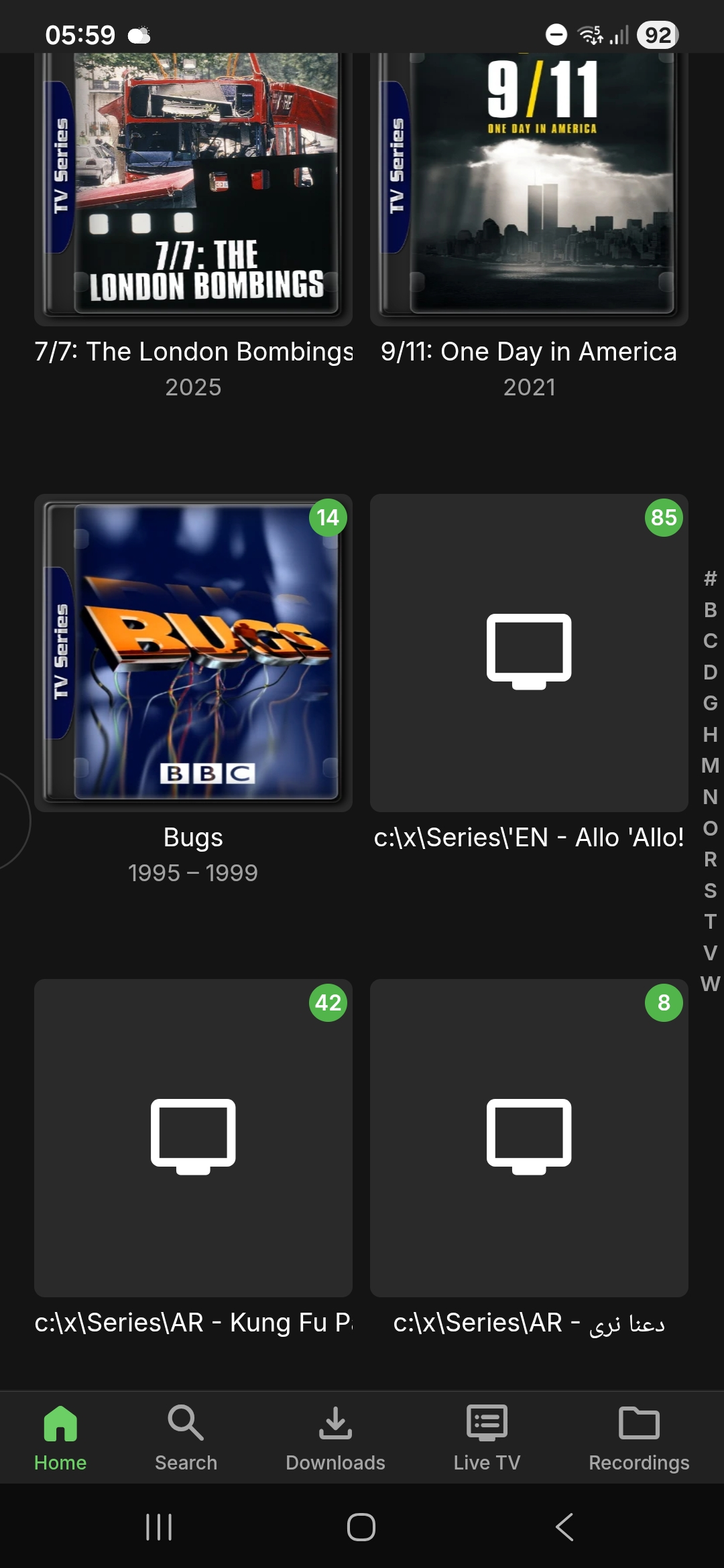

gillmacca01 220 Posted November 25, 2025 Posted November 25, 2025 On 11/21/2025 at 8:51 AM, antplugger said: Hi, I am a new user trying the plugin for series and getting a strange result. The names of all the series start with a c:\x:\Series This is the entry from the M3U file This is how it looks in emby. Any help greatly appreciated Im having the same issue. I am using latest dll, and scanning is complete, but 99% of my content is like this
softworkz 5133 Posted November 25, 2025 Posted November 25, 2025 12 hours ago, griam01 said: I am running into similar issues with source naming, the "EN - ", is what is causing it. Otherwise, it does map most of the series correctly as a TV series. I had to manually edit my M3U to remove "EN - " though ahead of time since IPTV Boss renames for TV series doesn't output the renamed name it only does for Movies. Acknowledged. We need to add a way to remove those prefixes.
softworkz 5133 Posted November 25, 2025 Posted November 25, 2025 20 minutes ago, gillmacca01 said: Im having the same issue. I am using latest dll, and scanning is complete, but 99% of my content is like this Do you see the "Quick Add Source" button like in my screenshot in that earlier post? https://emby.media/community/index.php?/topic/142334-new-webstreams-plugin/page/13/#findComment-1488621

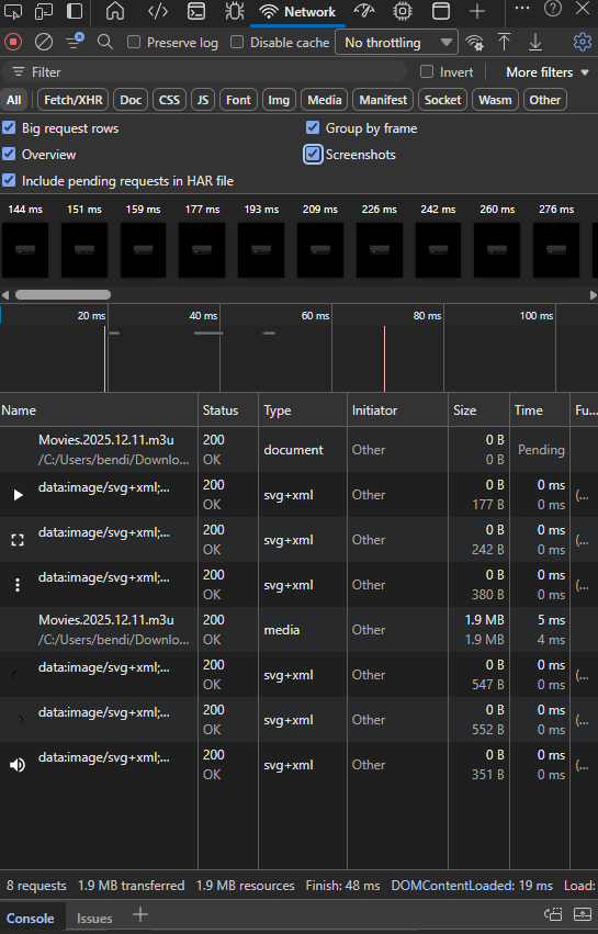

Chillout 111 Posted December 10, 2025 Posted December 10, 2025 First, thanks for creating this app! I have been creating .strm files and this plug-in will replace all that effort. Unfortunately, for one of my providers, linking the m3u URL results an in error: Unsupported Playlist: Unknown playlist type It works fine if download the m3u and keep it local but would require manually updating as new content is released. Is there a setting or something I am missing? My other provider accepts the URL link just fine. Regardless, even I have to do manual updates this plug-in will save me lots of time. The format of the m3u that doesnt work online linking directly to URL (but works fine locally): #EXTM3U #EXTINF:0 group-title="Movie VOD",xxx 2025 [1080p] [WEBRip] [WEB] #EXTGRP:Movie VOD https://x.com/movie/x/x/900041314 #EXTINF:0 group-title="Movie VOD",xxx 2025 [1080p] [WEBRip] [WEB] #EXTGRP:Movie VOD https://x.com/movie/x/x/900041313

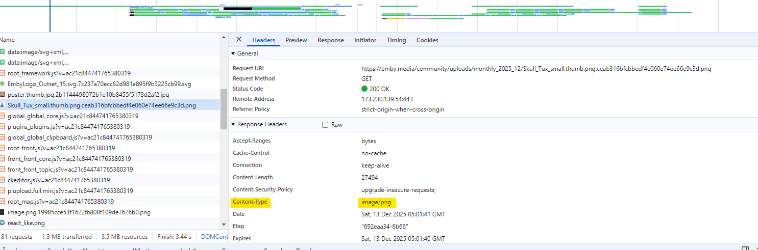

softworkz 5133 Posted December 11, 2025 Posted December 11, 2025 @Chillout - it could be a mime-type issue. When you load the m3u in a browser while having dev tools open (F12 = > network tab) - what's the content-type response header?
Chillout 111 Posted December 11, 2025 Posted December 11, 2025 (edited) @softworkz I'm not sure if this is what you are after but i can IM you the m3u URL if it will be helpful. Edited December 11, 2025 by Chillout
