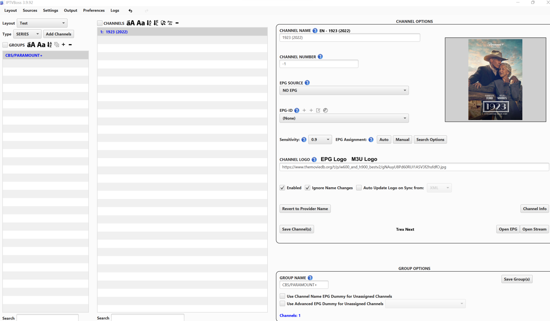

griam01 14 Posted November 13, 2025 Posted November 13, 2025 (edited) @softworkzIs there a way to edit the M3U automatically after it is exported? I am using IPTV Boss for creating my M3U's, but unfortunately for series, it doesn't change the name in the output. For Example: I am building it out as this below screen shot, but the M3U still contains the "EN - " in the name which it doesn't recognize. So in the filter of the webstream is there a way to have it ignore "EN - " or filter it out so it doesn't show? #EXTINF:-1 CUID="603b3cc9-69e5-30e7-a12d-a5f82de825a9" tvg-chno="5" tvg-id="" tvg-name="EN - 1923 (2022) - S01E01 - 1923" tvg-logo="https://www.themoviedb.org/t/p/w600_and_h900_bestv2/gNAuyU8Pd60RUI1ASV3f2hsfdfO.jpg" group-title="CBS/PARAMOUNT+",EN - 1923 (2022) - S01E01 - 1923 Edited November 13, 2025 by griam01

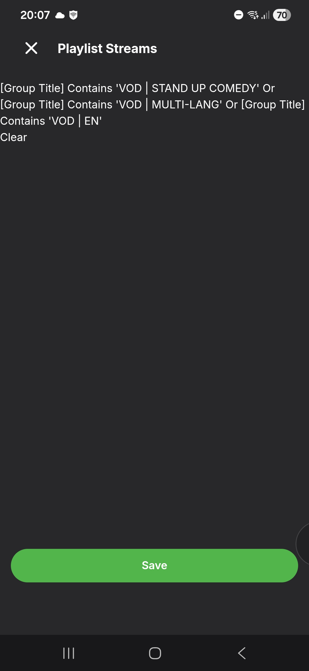

gillmacca01 220 Posted November 16, 2025 Posted November 16, 2025 How do you edit a filter that has already been created? When I select to edit it get the following screen:
softworkz 5133 Posted November 16, 2025 Posted November 16, 2025 @gillmacca01- what you're seeing is the "loading" state. It should actually show a spinner instead of the plain-text filter. After a while, you should see the grid. If not, can you try from a desktop browser?

gillmacca01 220 Posted November 17, 2025 Posted November 17, 2025 (edited) 5 hours ago, softworkz said: @gillmacca01- what you're seeing is the "loading" state. It should actually show a spinner instead of the plain-text filter. After a while, you should see the grid. If not, can you try from a desktop browser? Thanks. It did take about 5 mins before I saw the grid Edited November 17, 2025 by gillmacca01
softworkz 5133 Posted November 17, 2025 Posted November 17, 2025 16 minutes ago, gillmacca01 said: Thanks. It did take about 5 mins before I saw the grid How man items does your source have? A large number can be challenging for a mobile browser. These are better managed from a desktop browser in the LAN. Locally, with a list of 150,000 items, opening the grid takes 3 seconds for me and I can fluently scroll from top to bottom through all 150k rows. This is something you rarely see anywhere else
gillmacca01 220 Posted November 17, 2025 Posted November 17, 2025 (edited) 11 hours ago, softworkz said: How man items does your source have? A large number can be challenging for a mobile browser. These are better managed from a desktop browser in the LAN. Locally, with a list of 150,000 items, opening the grid takes 3 seconds for me and I can fluently scroll from top to bottom through all 150k rows. This is something you rarely see anywhere else I accept that, but 2 hrs later it was still on that screen. Tried rebooting, but as soon as I select edit filter, it loads that page and goes no further. Think I will remove the source and start again Edited November 17, 2025 by gillmacca01
softworkz 5133 Posted November 17, 2025 Posted November 17, 2025 24 minutes ago, gillmacca01 said: Tried rebooting, but as soon as I select edit filter, it loads that page and goes no further. Think I will remove the source and start again Please try from a desktop browser, then we can see whether there's a problem other than performance. You can try to add it under a different name without removing the existing one.
gillmacca01 220 Posted November 17, 2025 Posted November 17, 2025 Isn't it typical. Been trying since my initial post, and as soon as I say it takes 2hrs, it let's me straight in on my next attempt on my phone
