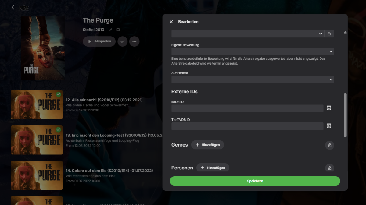

horstepipe 423 Posted October 16, 2025 Posted October 16, 2025 15 hours ago, softworkz said: You're right, there's no menu item for this. You'd have to choose "Edit Metadata" and clear the External IDs: Eventually, we'll need to make this easier by automatically clearing the child items' identifications when you clear it for a series. thanks, but there isn't one, either:
softworkz 5133 Posted October 16, 2025 Posted October 16, 2025 4 hours ago, horstepipe said: thanks, but there isn't one, either: What's the situation right now? Is "the Purge" right or wrong? Did you try to re-identify the serries (if wrong)?

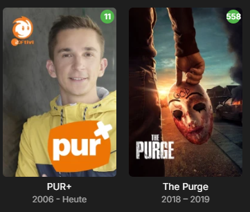

horstepipe 423 Posted October 18, 2025 Posted October 18, 2025 (edited) On 10/16/2025 at 2:42 PM, softworkz said: What's the situation right now? Is "the Purge" right or wrong? Did you try to re-identify the serries (if wrong)? The Purge is wrong. I reidentified the show, now I have two shows, the right one and the wrong one (but I am not sure whether PUR+ was there before) But I don't see a way to move the episodes from "The Purge" to "PUR+" This is the m3u: https://streamfeeds.github.io/web/m3u/de-deu-kika_zdftivi-tvshows-local-mv.m3u8 BR Edited October 18, 2025 by horstepipe

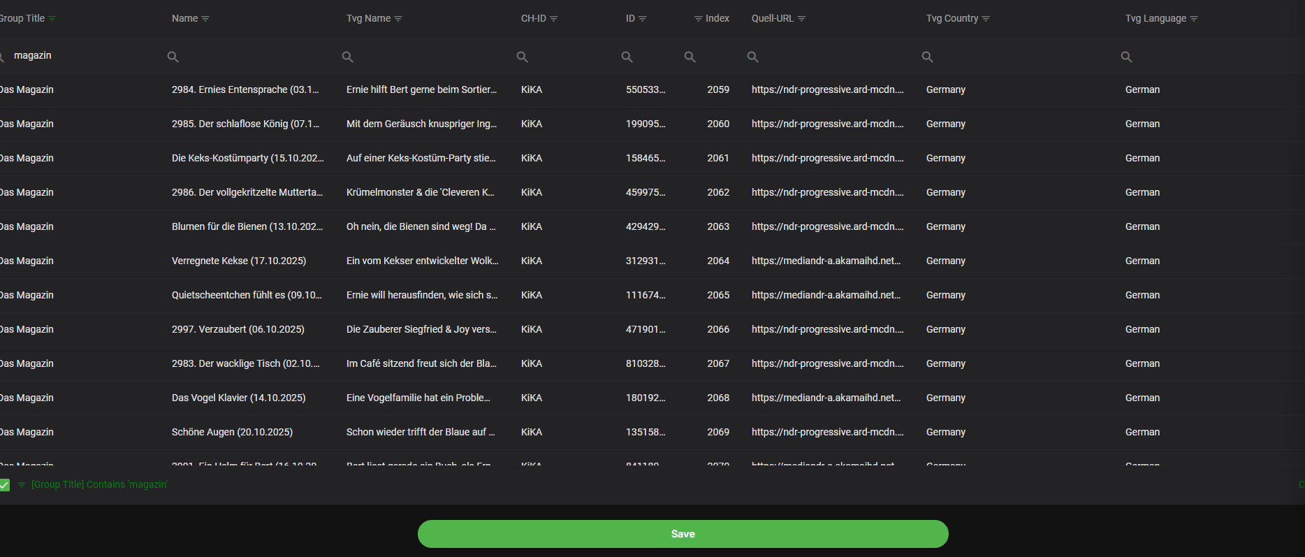

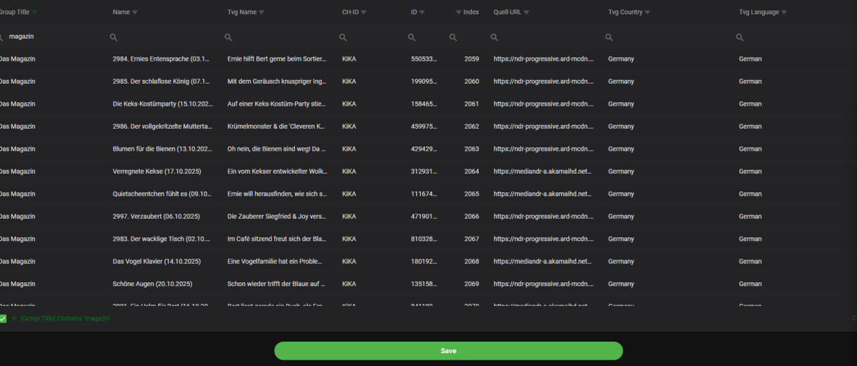

horstepipe 423 Posted October 20, 2025 Posted October 20, 2025 (edited) Next problem I see: For whatever reasons, Sesamstraße is called "Das Magazin" at Kika m3u - I see the same in Mediathekview. In Web Streams plugin I see the episodes in filter view: But I can't find the show at all in Emby. Edited October 20, 2025 by horstepipe

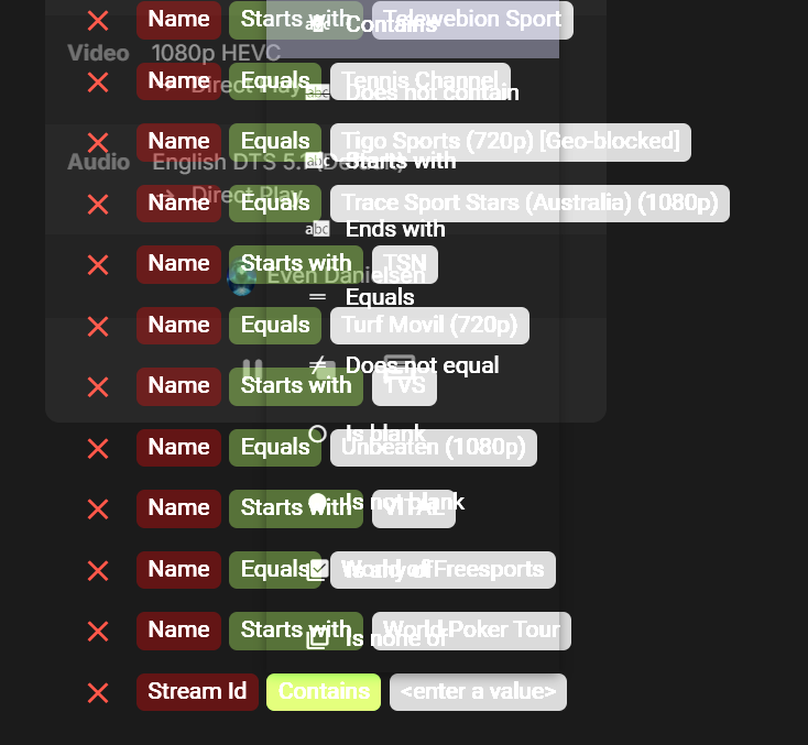

Aleas 40 Posted October 20, 2025 Posted October 20, 2025 On 10/16/2025 at 12:51 PM, softworkz said: You should be able to add them either as single streams or you could create an M3U file on a server disk, this will allow them to be grouped and easier for managing permissions. See Content Access So, I absolutely am Loving the plugin, but with content access it's either all or nothing. Say I have 5 Sources listed for the Top-Level, I can only restrict the plugin entirely but cannot control each source's permissions. What if I only want Source X (CCTV) to be viewable only by me, I can't control that.. Also something with the display filters gets a little funky, there's no background behind the options when you click a field (using Edge Windows) As you can see here. It looks fine at first, but after say 10 filters it bugs out.. 1
softworkz 5133 Posted October 20, 2025 Posted October 20, 2025 1 hour ago, Aleas said: Say I have 5 Sources listed for the Top-Level, I can only restrict the plugin entirely but cannot control each source's permissions. What if I only want Source X (CCTV) to be viewable only by me, I can't control that.. Unfortunately beyond some ugly hacks, misusing parental control and tags, there's no solution - yet! The problem is that it requires server change. It can't be done at the side of the plugin (alone). 1 hour ago, Aleas said: Also something with the display filters gets a little funky, there's no background behind the options when you click a field (using Edge Windows) As you can see here. It looks fine at first, but after say 10 filters it bugs out.. Can you please reset your browser cache, press F12, go to the "Network" tab and check "Disable cace". Then F5 back in the browser. 1

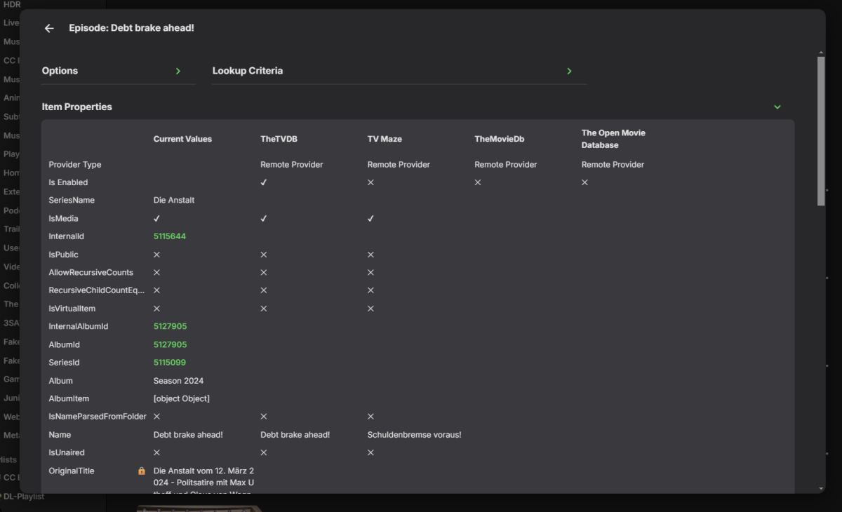

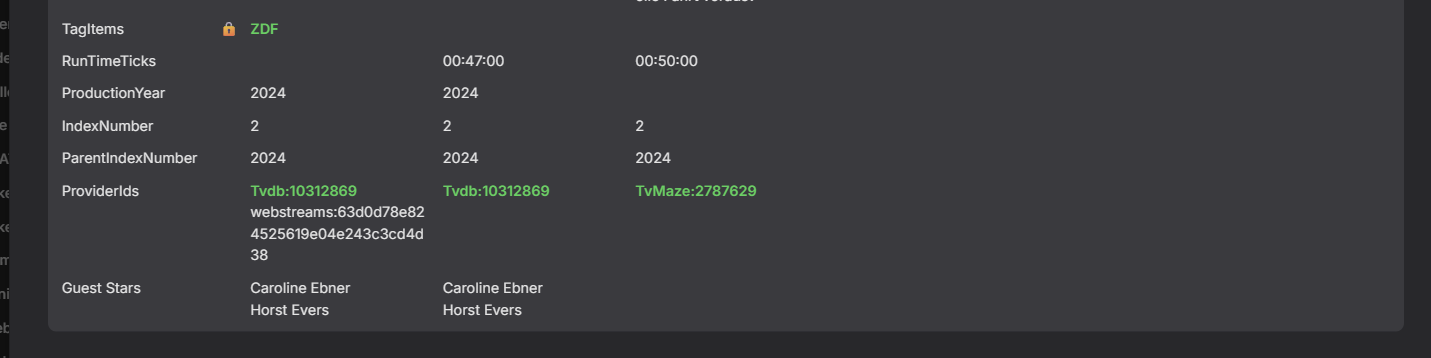

softworkz 5133 Posted October 20, 2025 Posted October 20, 2025 On 10/18/2025 at 10:42 AM, horstepipe said: But I don't see a way to move the episodes from "The Purge" to "PUR+" You might want to install the Data Explorer plugin Besides data from remote providers, it also displays all the currnet data of items (the regular UI is hiding some). Specifically interesting in your case would be the ProviderIDs as well as IndexNumber and ParentIndexNumber. Seeing these might give us some more clue.. 1
softworkz 5133 Posted October 20, 2025 Posted October 20, 2025 2 hours ago, horstepipe said: But I can't find the show at all in Emby. Did you switch between the dll plugin and the one from the catalog at any time? (without rebuilding the configuration)

horstepipe 423 Posted October 20, 2025 Posted October 20, 2025 26 minutes ago, softworkz said: Did you switch between the dll plugin and the one from the catalog at any time? (without rebuilding the configuration) I switched from catalog to your provided dll, but deleted all sources and started from scratch.
horstepipe 423 Posted October 21, 2025 Posted October 21, 2025 okay I did not make any changes, just refreshed the Kika m3u in web streams today again. Now I have the show, although it is identified wrong. But yesterday this show was not there definitely: I observed Emby logs while refreshing the playlist, lots of requests were made to the metadata providers. My guess is that there is some daily limit enforced by Emby server how much requests to the providers one can send to prevent problems with them? @Luke That would explain why the show was not there yesterday but shows up today after refresh. (I made a refresh yesterday, too). BR

horstepipe 423 Posted October 22, 2025 Posted October 22, 2025 On 10/10/2025 at 11:30 AM, horstepipe said: so @softworkz I reidentified that show to Pur+, ending up with an empty Pur+ folder, all episodes are still in "The Purge" folder. I guess this is just not fully implemented yet? I am so confused why I am getting different results each day I just tried to reidentify "The Purge" to "Pur+" again, now it worked. I will go on testing, thanks!

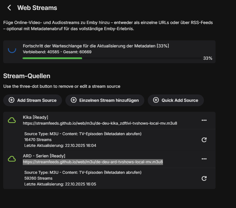

horstepipe 423 Posted October 22, 2025 Posted October 22, 2025 any idea why today's refresh of https://streamfeeds.github.io/web/m3u/de-deu-kika_zdftivi-tvshows-local-mv.m3u8 and https://streamfeeds.github.io/web/m3u/de-deu-ard-tvshows-local-mv.m3u8 triggered a full resync? I have an old kiki m3u in my downloads folder, don't see a difference which could cause that.
