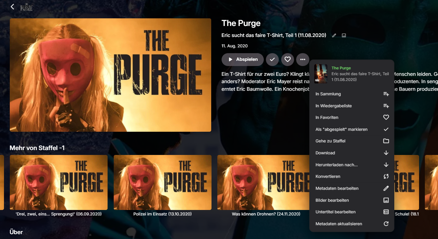

horstepipe 423 Posted October 10, 2025 Posted October 10, 2025 @Luke probably a little off topic, I added a german public broadcast m3u for children, there is the Show "Pur+" https://thetvdb.com/series/263753-show#seasons #EXTINF:-1 group-title="PUR+" tvg-id="693655218" tvg-name="Moderator Eric Mayer will wissen‚ wann sportliche Vergleiche zu besseren Leistungen beflügeln.<br/>From 30.09.2025 19:25" tvg-country="Germany" tvg-language="German" channel-id="KiKA",Wer ist schneller‚ schlauer‚ schöner? (30.09.2025) Emby assigns it to "The Purge" The Purge - TheTVDB.com
horstepipe 423 Posted October 10, 2025 Posted October 10, 2025 1 hour ago, horstepipe said: @Luke probably a little off topic, I added a german public broadcast m3u for children, there is the Show "Pur+" https://thetvdb.com/series/263753-show#seasons #EXTINF:-1 group-title="PUR+" tvg-id="693655218" tvg-name="Moderator Eric Mayer will wissen‚ wann sportliche Vergleiche zu besseren Leistungen beflügeln.<br/>From 30.09.2025 19:25" tvg-country="Germany" tvg-language="German" channel-id="KiKA",Wer ist schneller‚ schlauer‚ schöner? (30.09.2025) Emby assigns it to "The Purge" The Purge - TheTVDB.com so @softworkz I reidentified that show to Pur+, ending up with an empty Pur+ folder, all episodes are still in "The Purge" folder. I guess this is just not fully implemented yet?

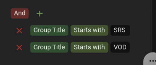

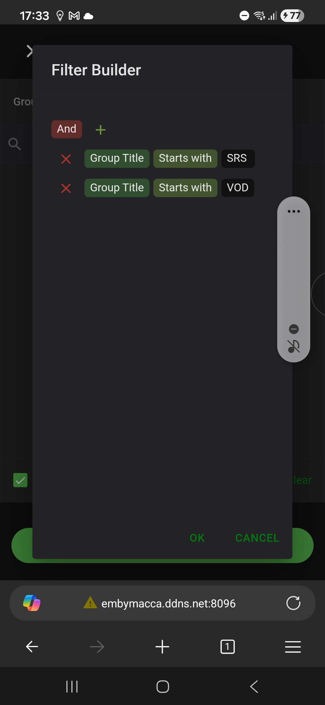

gillmacca01 220 Posted October 10, 2025 Posted October 10, 2025 (edited) What am I doing wrong here. I have groups starting with SRS and VOD. If I choose either on their own it works, but together, no data available Edited October 10, 2025 by gillmacca01
softworkz 5133 Posted October 10, 2025 Posted October 10, 2025 2 hours ago, gillmacca01 said: What am I doing wrong here. I have groups starting with SRS and VOD. If I choose either on their own it works, but together, no data available You need to click on the "And" and change it to an "Or"
gillmacca01 220 Posted October 10, 2025 Posted October 10, 2025 Ah. I change the and to or, on the VOD line thinking that would do it

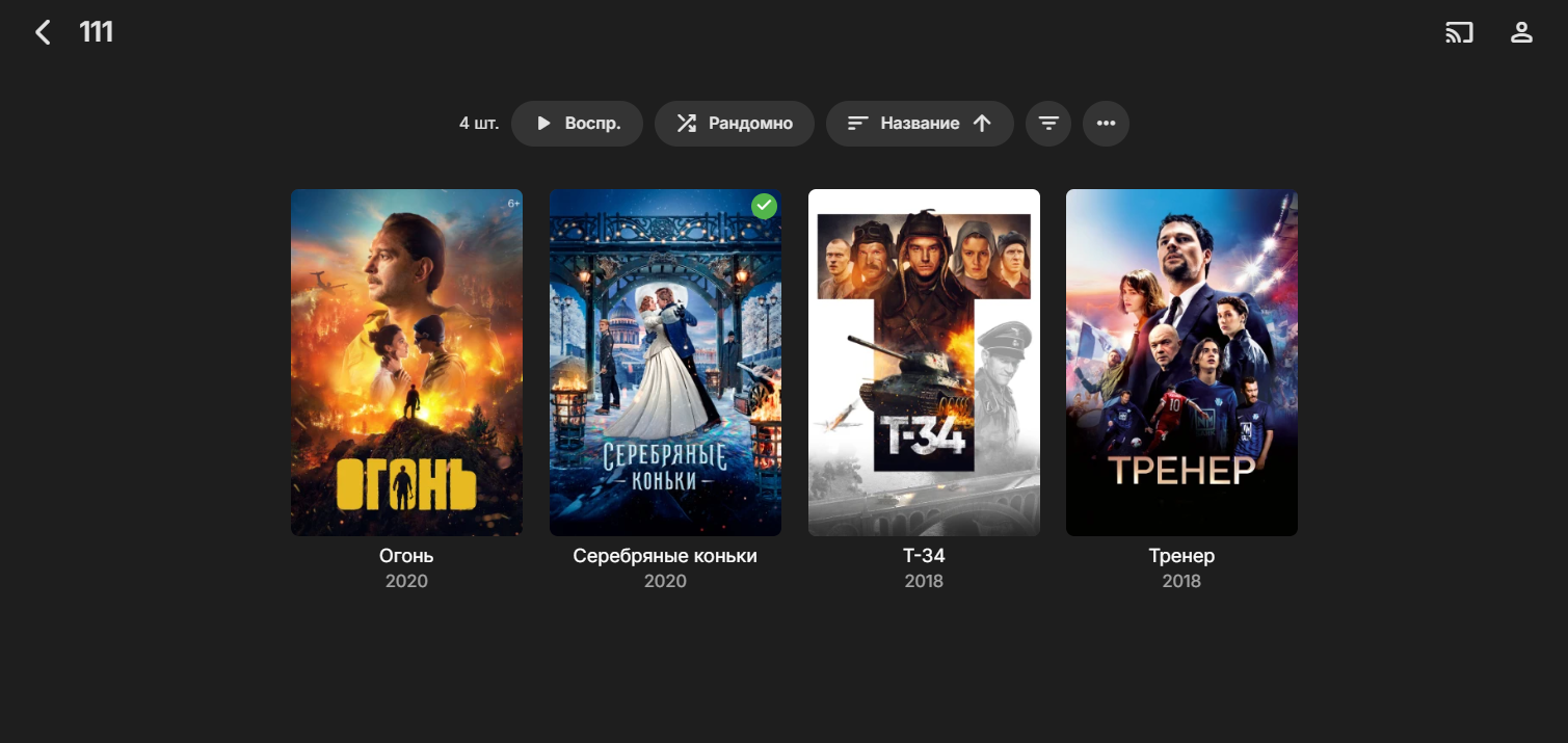

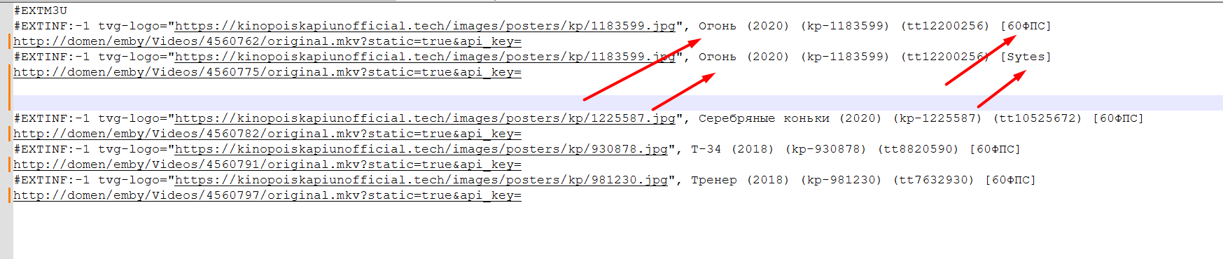

svyaznoy362 17 Posted October 14, 2025 Posted October 14, 2025 (edited) Добавляю тестовый лист с 5 фильмами. 2 из них одинаковые. В итоге получается не 5, а 4 фильма. embyserver.txt Edited October 14, 2025 by svyaznoy362

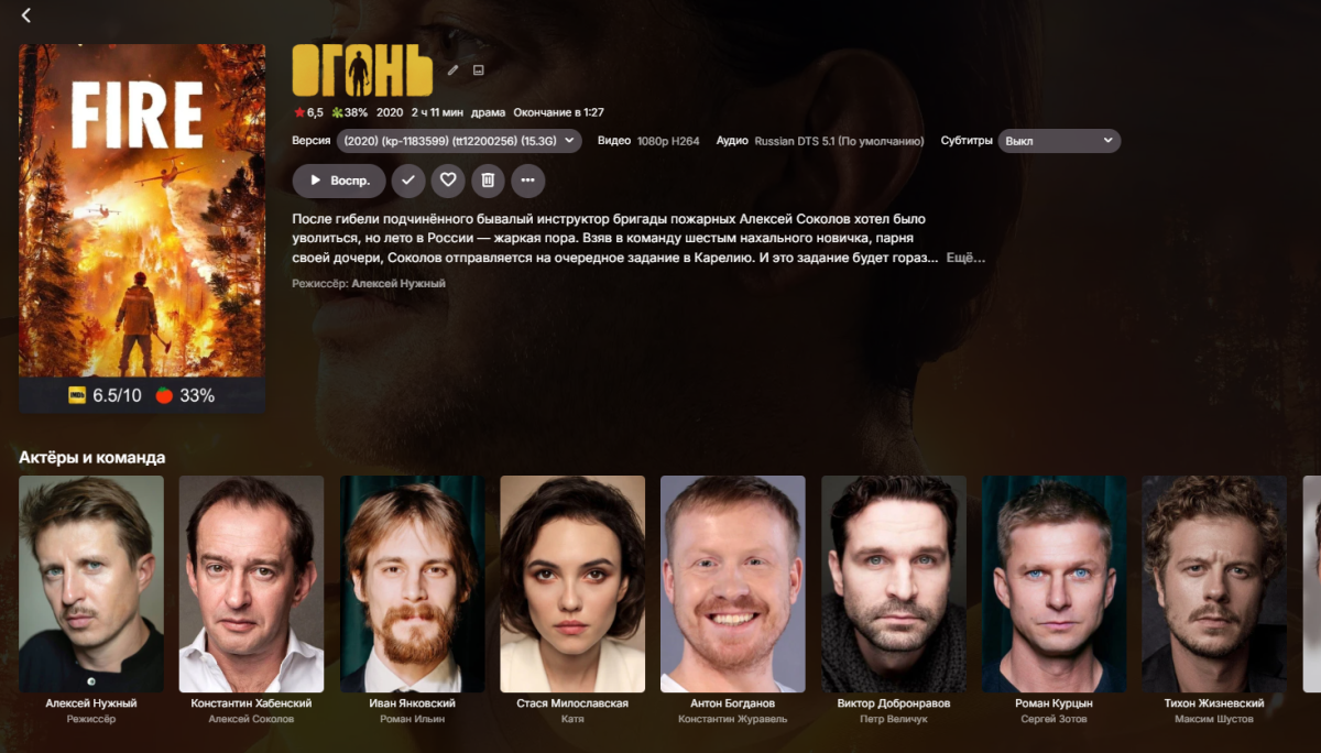

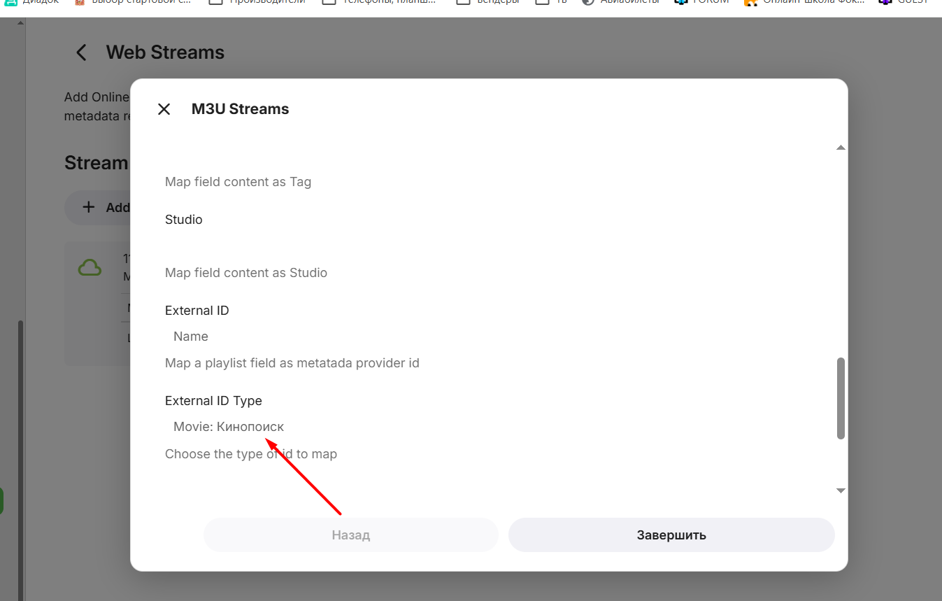

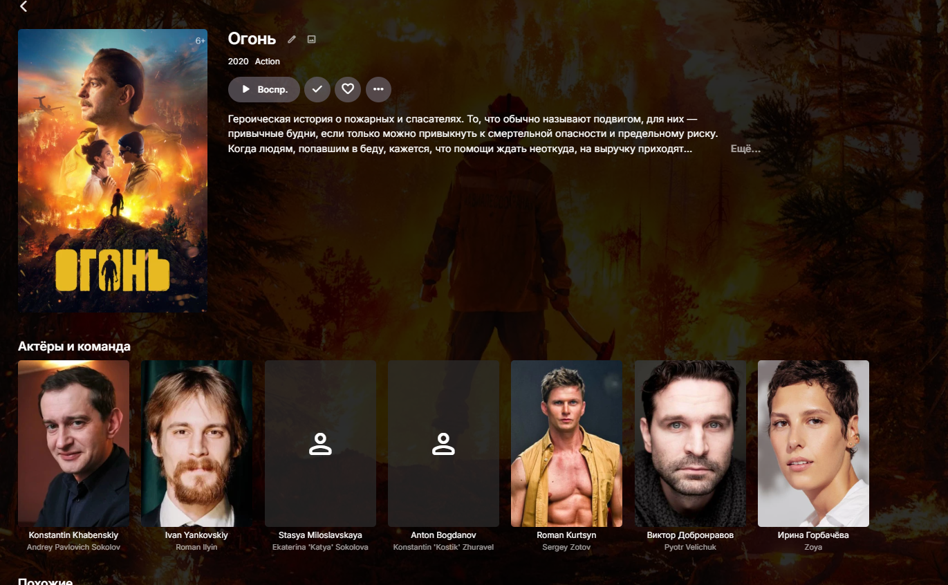

svyaznoy362 17 Posted October 14, 2025 Posted October 14, 2025 I use kinopoisk to add metadata, and if I add a playlist via m3u, then the names of the actors are in English. And if I add it via strm, then all the actors are in Russian.

softworkz 5133 Posted October 15, 2025 Posted October 15, 2025 20 hours ago, svyaznoy362 said: Why can't I edit the menu sections after adding and saving the data? It would cause inconsistency and chaos. 20 hours ago, svyaznoy362 said: I use kinopoisk to add metadata, and if I add a playlist via m3u, then the names of the actors are in English. And if I add it via strm, then all the actors are in Russian. Please see my earlier post about setting the metadata language.
svyaznoy362 17 Posted October 15, 2025 Posted October 15, 2025 3 minutes ago, softworkz said: Это приведет к непоследовательности и хаосу. Пожалуйста, ознакомьтесь с моей предыдущей публикацией о настройке языка метаданных. It doesn't work for actors, but only for the name of the films.
