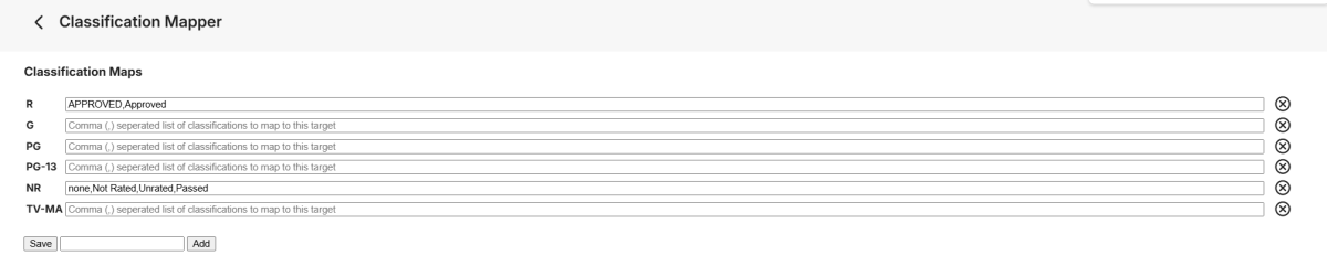

CarneAsada 12 Posted September 23, 2025 Author Posted September 23, 2025 Using the Classification Plug-in; I was able to clean up the inappropriate classification for my kids profile age 0-6. Emby by default groups G/PG and APPROVED; as such I needed a way to identify all ratings under APPROVED and upgrade them to R. These are the settings I used. 1
