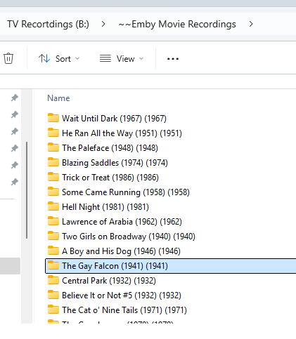

Ronstang 294 Posted September 7, 2025 Posted September 7, 2025 I think this is something new but I didn't try to record a movie in a long time previous to .24 but the date in parentheses in the folder and filenames are now in there twice. Strange but kind of funny. There is a picture below. At first I thought my wife had spiked my drink.
Luke 42239 Posted September 7, 2025 Posted September 7, 2025 Hi, I don't think there's any change here. I think this is just caused by the guide data having the year at the end of the name which up until now has not been typical. So the recording process needs to be updated to check for this and not double it up if it's already there.
Ronstang 294 Posted September 7, 2025 Author Posted September 7, 2025 Not really understanding what you mean Luke. 8 minutes ago, Luke said: I think this is just caused by the guide data having the year at the end of the name which up until now has not been typical. Look at this picture below and pay attention to the last column which is date created, my emby recordings have ALWAYS had the date at the end of the file in parenthesis. 1

Ronstang 294 Posted September 9, 2025 Author Posted September 9, 2025 Crap, I spoke a little too soon. The double dates are gone in the folder names but not the filenames, they still have a double date. 1
