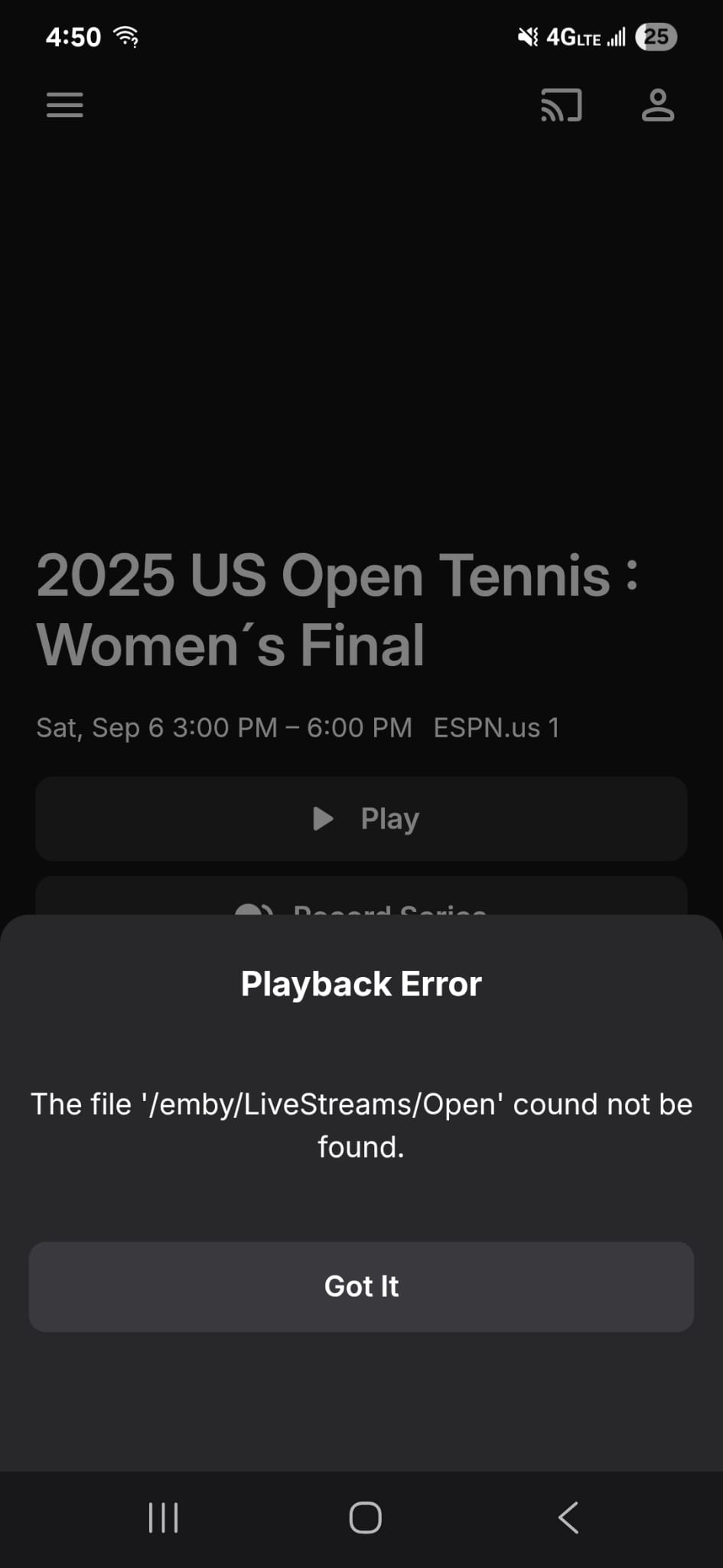

ExploitPanda 0 Posted September 6, 2025 Posted September 6, 2025 I’ve been having this ongoing issue with a Samsung device and a Samsung TV Is this an issue on my server or the actual application device. I went ahead and did a full reboot of EMBY and the server it’s hosted on and no success. Thank you

ExploitPanda 0 Posted September 6, 2025 Author Posted September 6, 2025 38 minutes ago, Luke said: Hi there, let's look at an example. Please attach the information requested in how to report a media playback issue. Thanks! I have attached the log. It's at 2025-09-06 16:50 embyserver (1).txt
ExploitPanda 0 Posted September 9, 2025 Author Posted September 9, 2025 11 minutes ago, Luke said: HI, are you running a reverse proxy? yes I am using Nginx Proxy Manager
Luke 42289 Posted September 9, 2025 Posted September 9, 2025 There is evidence in this log of a misconfigured reverse proxy. There are GET requests that should be POST. Unless you're connecting to your server with some third party app that isn't doing things correctly, then that's what that looks like to me. First thing I would do is compare your reverse proxy settings to this and get them aligned:
