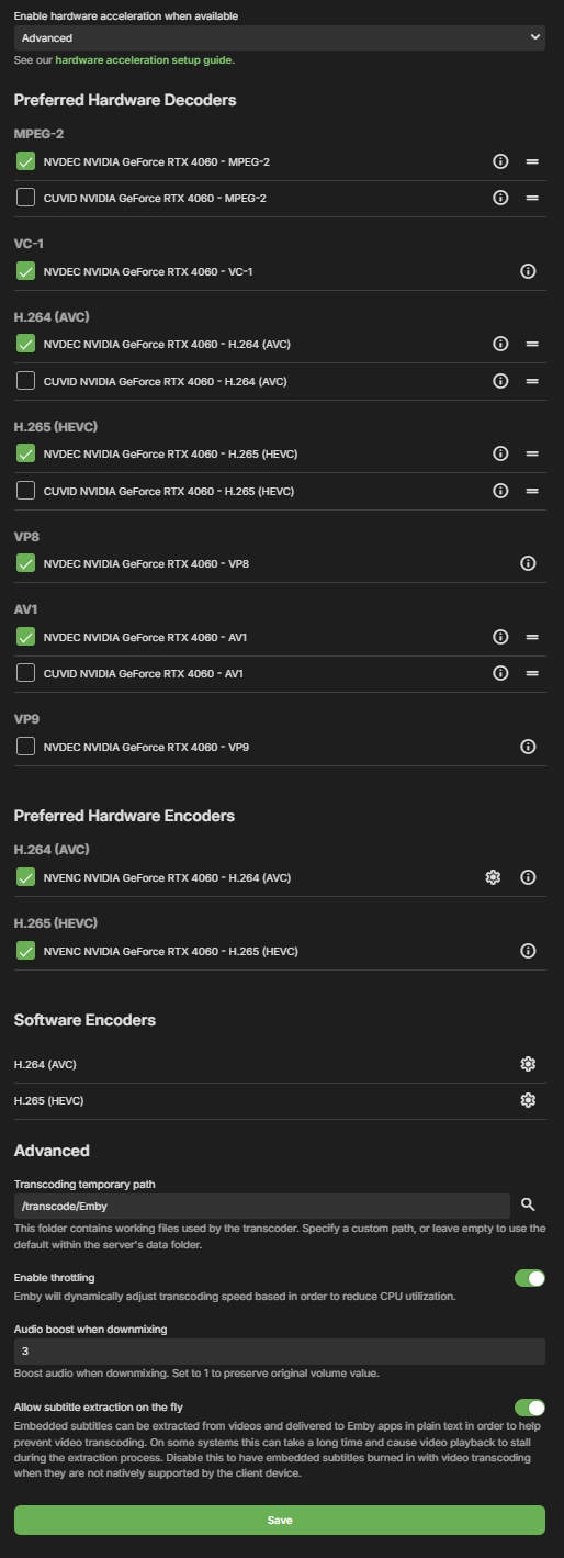

KevinAtlee 3 Posted September 6, 2025 Posted September 6, 2025 Hello, could someone identify why this file was transcoded using CPU/Software instead of the available NVENC? Transcoding works fine on the majority of my library with NVENC, just noticed my CPU load spike during this transcode. Is it just a DV licensing issue? I was under the impression with an HDR base layer it wouldn't be an issue. Excerpt from ChatGPT: If you transcode Profile 8.1, Emby will still ignore the DV metadata and encode the HDR10 base. That’s fine, but you’re back to CPU because Emby won’t engage NVENC for DV-tagged input. Thanks! ffmpeg-transcode-b2acaf08-32f7-476d-a957-1dfb6f7cb559_1.txt
GrimReaper 4896 Posted September 6, 2025 Posted September 6, 2025 (edited) 2 hours ago, KevinAtlee said: Hello, could someone identify why this file was transcoded using CPU/Software instead of the available NVENC? Your GPU is not even listed as available decoder/encoder: Quote >>>>>> Selected Codecs Decoder Automatic software decoder Encoder x264 Max Bitrate: 781 Mbit/s Color Formats: YUV420P, YUVJ420P, YUV422P, YUVJ422P, YUV444P, YUVJ444P, NV12, NV16, NV21, YUV420P10, YUV422P10, YUV444P10, NV20, GRAY8, GRAY10 - Bit Depths: 8, 10, 12, 14 Profiles: Baseline Profile (Level 6.2), Main Profile (Level 6.2), High Profile (Level 6.2), High 10 Profile (Level 6.2), High 4:2:2 Profile (Level 6.2), High 4:4:4 Predictive Profile (Level 6.2) >>>>>> FindVideoEncoder - MediaType: h264, UseHardwareCodecs: False, HWA-Mode: Advanced Info Checking: 'x264' Info Check successful - selecting 'x264' >>>>>> FindVideoDecoder - MediaType: hevc, UseHardwareCodecs: False, HWA-Mode: Advanced Info Checking: 'Automatic software decoder' Info Check successful - selecting 'Automatic software decoder' Info Tone Mapping would be desired, but software tone mapping is disabled Can you share hardware detection log, and screenshot of your Transcoding settings in Emby? Edited September 6, 2025 by GrimReaper
KevinAtlee 3 Posted September 7, 2025 Author Posted September 7, 2025 It appears to be visible to Emby, logs attached, thoughts? hardware_detection-63892754986.txt

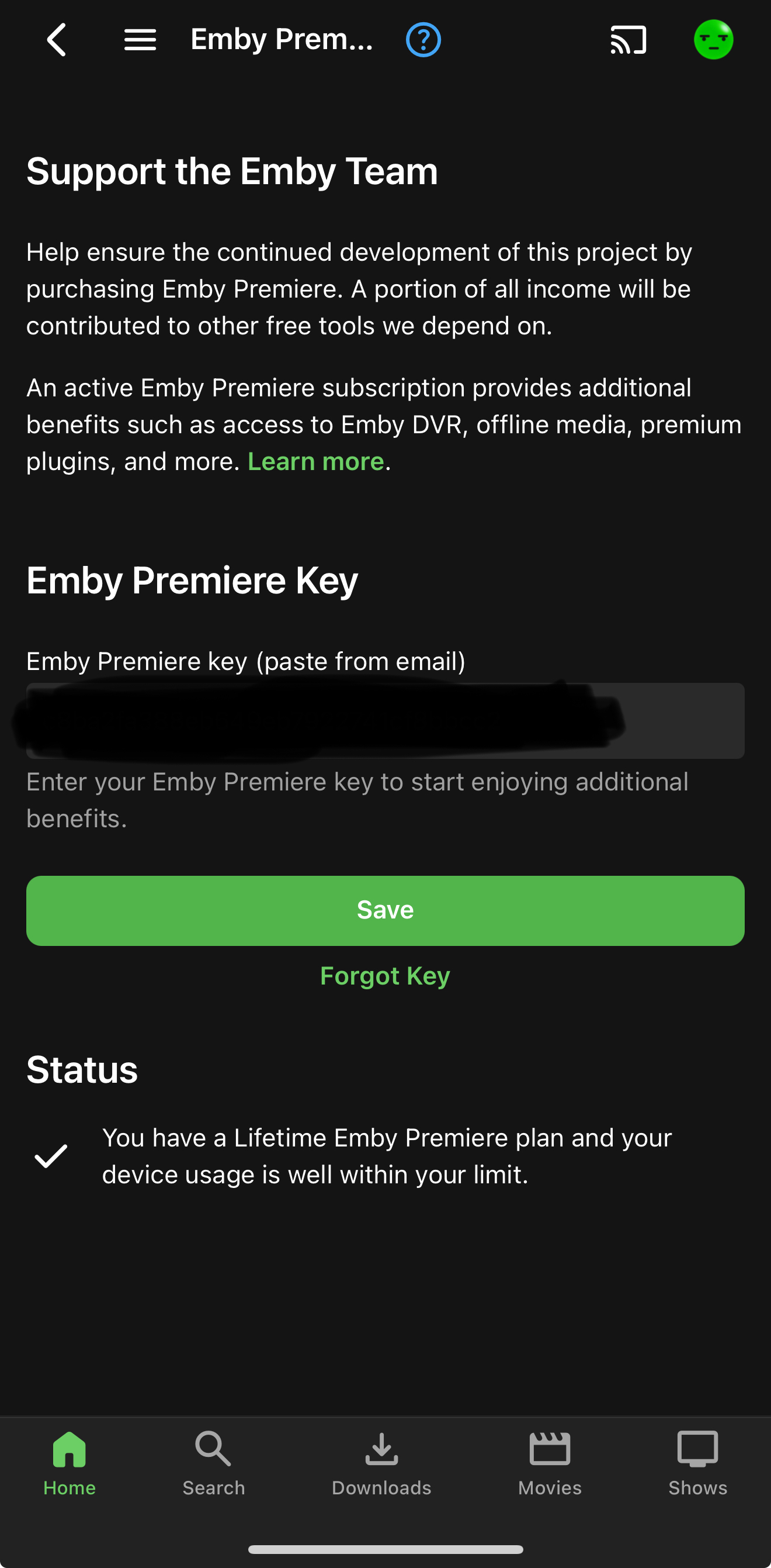

softworkz 5133 Posted September 7, 2025 Posted September 7, 2025 Logs are showing that there's a flag set which indicates to disable hw accelerated transcoding: One reason for this is the lack of a valid Emby Premiere Subscription But it can also be simply due to a preceding transcode attempt which failed. So - assuming that there's a valid Premiere subscription, the answer should be visible in the preceding FFmpeg log rather than this one. 1 1
KevinAtlee 3 Posted September 7, 2025 Author Posted September 7, 2025 I’ve always had a registered lifetime Premiere subscription, and it appears to still be in good standing. Would it be the log immediately before this log, or could it be any number of logs before this? If so, I’ve got some searching to do, and what exactly would I be looking for? Should restarting Emby Server and / or restarting the Emby Server docker reset this flag? Thanks!

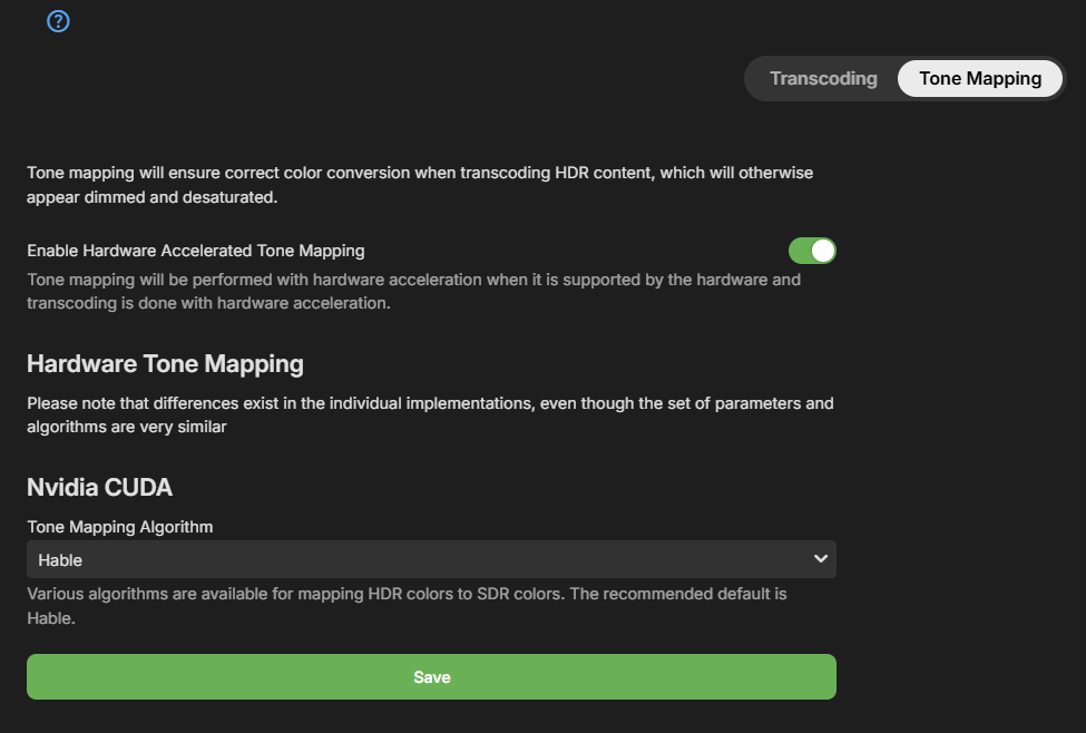

KevinAtlee 3 Posted September 8, 2025 Author Posted September 8, 2025 I've found a log where NVENC was attempted, but failed on tone mapping? Hopefully someone can point me in the right direction here. Log attached, thanks! ffmpeg-transcode-86a48261-99fb-4d87-be5d-26c6192fa8c4_1.txt

KevinAtlee 3 Posted September 9, 2025 Author Posted September 9, 2025 From what I've gathered, installing from the NVIDIA site, and not the plugin would be a poor life choice. FWIW, after some more testing, this happens to all media that is scaled down from 4k to HD, and requires tone mapping. If doing one task or the other, there is no issue, and the transcoding, or the tone mapping runs on the GPU without fail. I believe it's only the case on DOVI content with an HDR base layer, but I can't seem to find 4K HDR content in my library that doesn't have a DOVI layer for testing. I downloaded your Transcoding Tests plugin, and have it running now. Another excerpt from ChatGPT: What actually bit you is the CUDA tone-mapping filter in Emby’s ffmpeg build. Your other log shows Emby attempted an all-GPU pipeline (NVDEC → scale_cuda → tonemap_cuda → NVENC) and then crashed with a PTX JIT error (CUDA_ERROR_INVALID_PTX … requires PTX ISA .version 6.0+). After that failure, Emby retried in software, which is why you saw CPU x264. This is a filter/PTX compatibility issue. It seems to think it's an Emby issue, but that's well outside my wheelhouse.
