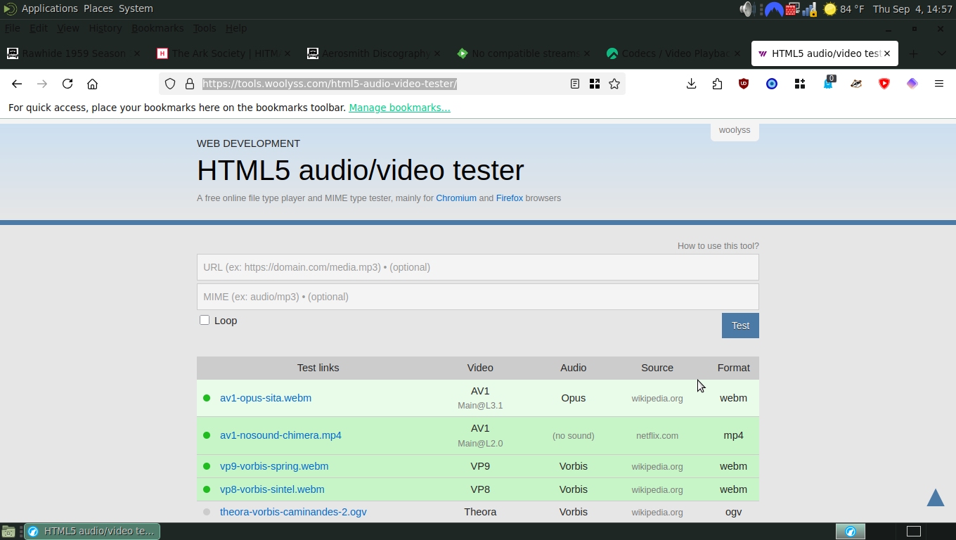

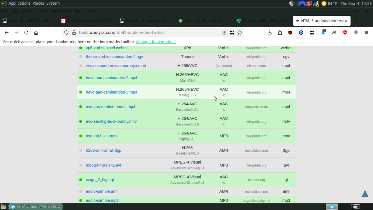

Ihategettinganotheraccount 0 Posted September 4, 2025 Author Posted September 4, 2025 (edited) On 9/3/2025 at 9:32 PM, Luke said: Hi, how did you test that? https://tools.woolyss.com/html5-audio-video-tester/ Green means it is working. Also has a video you can play as well, if working. Edited September 4, 2025 by Ihategettinganotheraccount
Luke 42242 Posted September 4, 2025 Posted September 4, 2025 This is what we are testing for h264 support: video/mp4; codecs="avc1.42E01E, mp4a.40.2" If it is trying to transcode an mp4 with h264 then barring some other reason, that condition must be returning false.
