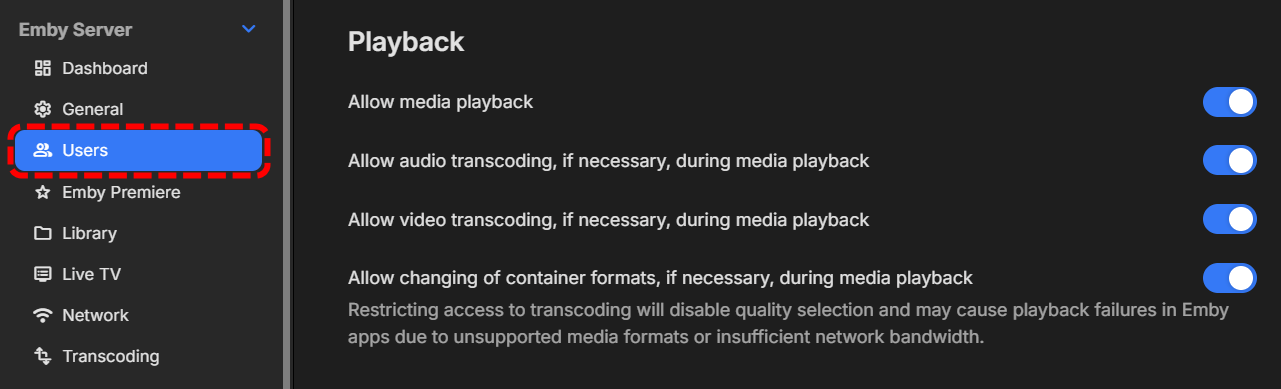

maier64 5 Posted September 5, 2025 Author Posted September 5, 2025 OK, somehow it's very strange, I wonder why LG does that. I'm aware that this is not Embys fault. However, this thing with the permissions (temporarily restricting user transcoding permissions to force it to direct play), where can I do that. Since we are out of town this weekend, I'm going to try this next week. Thank you so much for your help so far.
seanbuff 1355 Posted September 5, 2025 Posted September 5, 2025 24 minutes ago, maier64 said: However, this thing with the permissions (temporarily restricting user transcoding permissions to force it to direct play), where can I do that. within the Server, open your Users profile > Playback section
maier64 5 Posted September 5, 2025 Author Posted September 5, 2025 (edited) 10 minutes ago, seanbuff said: within the Server, open your Users profile > Playback section Sorry, can't find this, I run Emby Server on a Synology NAS with DSM 7.1 Emby Server 4.8.11 Edited September 5, 2025 by maier64
seanbuff 1355 Posted September 5, 2025 Posted September 5, 2025 1 hour ago, maier64 said: Sorry, can't find this, I run Emby Server on a Synology NAS with DSM 7.1 Emby Server 4.8.11 "Users" -> "Profile" -> "Playback"
Luke 42239 Posted September 5, 2025 Posted September 5, 2025 Just don't forget to undo it after testing or it will most likely cause playback problems.
