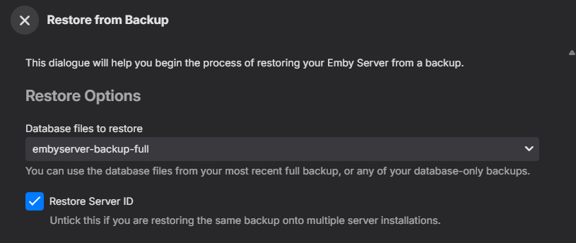

ebr 16354 Posted September 2, 2025 Posted September 2, 2025 Backup and Restore? Or, if you are really making the move, why not just upgrade your current server to beta?

ebr 16354 Posted September 2, 2025 Posted September 2, 2025 1 hour ago, Neminem said: I would run them side by side. Shutdown the one you run now. Install normal / stabil Portable version. Emby Server for Windows Shut it down. copy appdata over to your new install. Edit the system.xml to new ports, so they don't reflect your old server. <PublicPort>8096</PublicPort> <PublicHttpsPort>8920</PublicHttpsPort> <HttpServerPortNumber>8096</HttpServerPortNumber> <HttpsPortNumber>8920</HttpsPortNumber> That should do it. Start your old server. See if that works. Start new server and see if that works. After that upgrade new server to 4.9. You should still have everything + users on your new beta. This will create duplicate server IDs which will be a potential problem. You'll want to delete the "device.txt" file from the new one and let it re-generate. 1
Happy2Play 9814 Posted September 2, 2025 Posted September 2, 2025 Since everything tied to database sets now it really isn't possible to transfer from server to server now. As the users.db is your users but the library.db uses the userids from your users.db for your users data and for Playlists permissions. You also have other dbs like displaypreferences (think removed or move to library.db) and authentication; As mentioned you would have to restore a backup on your new system and upgrade to beta. But as mentioned if both servers will remain online you will want to delete the device.txt on one or ensure to deselect that option on the restore process. And probably offset Emby ports and ensure you redo add new portforwarding. 1
