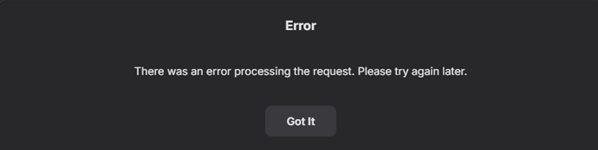

ChrisBee1961 0 Posted September 1, 2025 Posted September 1, 2025 Hi All, I have a large music library of nearly 2500 songs. When the client is listing all the songs and I try to select any to play, I get the error message below. This only happens when I try to play them on my remote DNLA device. If I try to play them locally then I dont get the error. embyserver.txt I can play individual songs from a selected album on my DNLA remote device with no issues. I am thinking this issue is due to the size of the song library. I have attached the debug log for reference. I downloaded the log file as soon as the issue happened so the debug info is at the end of the log file. .embyserver.txtembyserver.txtembyserver.txt

Luke 42234 Posted September 1, 2025 Posted September 1, 2025 Hi, so you're saying you're trying to put the entire library into a play queue?
ChrisBee1961 0 Posted September 2, 2025 Author Posted September 2, 2025 Hi, Yes that is correct. Selecting "Songs" lists them all out. I can click on "Play" at the top of the list where there is "Play - Shuffle - Title - Filter - ..." and they will play in order with no issues. I can go down the list and select "Play" from the "..." and it will play OK Where it goes wrong is where I select "Play all from here" from the "..." or click on a track which I presume is doing the same. Only when I am playing to my Cambridge Audio streamer using the DNLA play to feature that it has the issue. I have been using Jellyfin as my media server and that can play all of the songs to my streamer with no issues. I prefer the interface to Emby, hence trying to use it and discovering this issue. Hope this helps.
