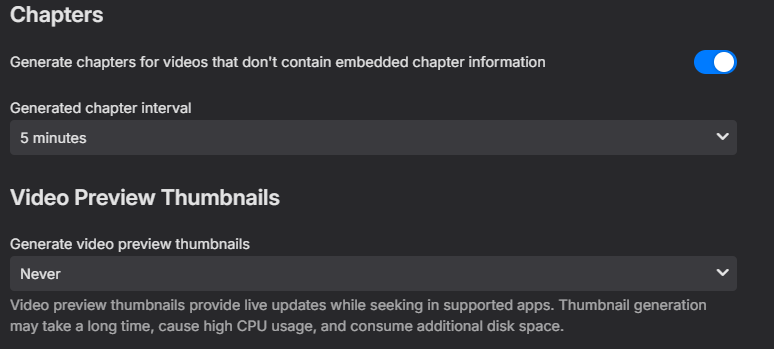

Ronstang 294 Posted September 1, 2025 Posted September 1, 2025 Installed the latest beta the other day for another reason that didn't pan out but have it running as a parallel portable install to test some things. I noticed when making a new library that there is a feature to add chapter markers to video files that do not have them. This is really cool because I have a lot of files that do not have chapters for some odd reason. I have a solution called MKVChapterizer which works perfectly but I have to know which files don't have chapters. My question is does emby scan the files and find the ones that don't have chapters and run as a scheduled task or is this one of those things the first time you try to load a file in emby it adds the chapter markers? What I mean is if I navigate to the info page of a movie and it has no chapters will I see that upon viewing and if not when I play it will the chapters be added and then subsequent views will now show the chapters? Sorry, I have now confused myself as much as I probably have you so it is easier to just ask how and when does this feature work? This is actually exciting.
Luke 42289 Posted September 1, 2025 Posted September 1, 2025 Hi, this is not really a new feature. The server has always had it. The option only provides the ability to turn off the behavior that was already there. Quote My question is does emby scan the files and find the ones that don't have chapters and run as a scheduled task During the initial import it gets chapters from the file. If there are none, it will auto-generate some at 5 minute intervals. This last part is what can now be turned off.

Luke 42289 Posted September 1, 2025 Posted September 1, 2025 Quote So it does nothing? When you're in Emby you'll be able to use the auto-generated chapters just as if they were part of the original file. But it will not save the chapters into the file for use outside of Emby. The detail screen only shows chapters with images, so either you didn't enable video preview thumbnail extraction, or it hasn't happened yet for that particular video.

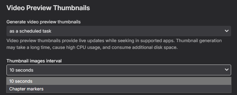

Happy2Play 9814 Posted September 2, 2025 Posted September 2, 2025 (edited) 56 minutes ago, Luke said: Did you enable thumbnail generation during the scan or just during the scheduled task? Enabling just he Chapters option is not enough? (Have not tested this yet) But I will guess everything is still tied to Video Preview Thumbnails options even if you enable the Chapter switch. Edited September 2, 2025 by Happy2Play
Luke 42289 Posted September 2, 2025 Posted September 2, 2025 Quote Enabling just he Chapters option is not enough? (Have not tested this yet) it is enough to generate the chapters, but not to extract images. That has a separate option.
Ronstang 294 Posted September 2, 2025 Author Posted September 2, 2025 Yes, thumbnail generation is enabled and while I was asleep it generated the BIF file that I deleted after using MKVChapterizer but there are still no thumbnails associated with the chapters when they show while playing with emby, but they still do not show in the info page.
Happy2Play 9814 Posted September 2, 2025 Posted September 2, 2025 1 minute ago, Ronstang said: Yes, thumbnail generation is enabled and while I was asleep it generated the BIF file that I deleted after using MKVChapterizer but there are still no thumbnails associated with the chapters when they show while playing with emby, but they still do not show in the info page. But if you deleted the bif then no images will appear as that is where the images will come from.
Ronstang 294 Posted September 2, 2025 Author Posted September 2, 2025 1 hour ago, Happy2Play said: But if you deleted the bif then no images will appear as that is where the images will come from. I told you, I deleted the BIF file because nothing showed once I deleted the chapters that were not actually there and created new ones with MKVChapterizer. Then I tried to get emby to generate a new one but it wouldn't but it did overnight. But still no images show in the chapters when playing the file in emby and no chapters show in the info page.
