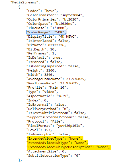

softworkz 5133 Posted August 30, 2025 Posted August 30, 2025 Thanks for the logs. The explanation is simple: Emby doesn't detect this video as an HDR video:
softworkz 5133 Posted August 30, 2025 Posted August 30, 2025 Let me answer your next question right away: Quote But it has smpte2084, bt2020, bt2020nc and it's 10bit - so it must be HDR! No! That's a common misconception. These a prerequisites for an HDR video but do not mean that a video is HDR. What is also needed on top of the above is HDR metadata in the stream like: for HDR10 Static metadata Mastering display metadata Content light level metadata for HDR10+ Same static metadata like above - and Dynamic metadata ST 2094-40 metadata (continuously changing as scenes are changing)
Solution softworkz 5133 Posted August 30, 2025 Solution Posted August 30, 2025 Two things are possible: The video is actually not HDR The video details were determined by an old version of Emby server (without detailed detection) and haven't been updated ever since You can try to refresh metadata on the item (or change a single letter of the file name - to be sure that it has been re-probed) and see whether it changes the data
hhb97b 11 Posted August 31, 2025 Author Posted August 31, 2025 12 hours ago, softworkz said: Two things are possible: The video is actually not HDR The video details were determined by an old version of Emby server (without detailed detection) and haven't been updated ever since You can try to refresh metadata on the item (or change a single letter of the file name - to be sure that it has been re-probed) and see whether it changes the data Hi I needed to read up on HDR as its atleast a couple of years since I have looked at. I agree that Bt2020 is only wide gamut and it can be both sdr and HDR. The file is hdr10 and changing the file name(2), solved the issue. I'm sure as I used "label" as I have multiple version of the file and I saw the label had changed inside emby. It makes sense at you need to make the api call to the os before starting the mpv and caching the value makes it easier and faster. Is there anyway to reprobe my whole library without having to rename files? I have a large library and it will take me forever to do it manaually. I have looked at the scheduled task it doesn't seem to be one.
softworkz 5133 Posted August 31, 2025 Posted August 31, 2025 34 minutes ago, hhb97b said: Is there anyway to reprobe my whole library without having to rename files? Of course you don't need to rename all files. The reason why I suggested that is because it gives you a quick and reliable answer: When Emby has picked up the name change, it is also guaranteed that it has been re-probed without any doubts and without waiting (unless you have automatic change detection disabled, but then you wouldn't have seen the file name change either in Emby). To update the library, just right-click and choose "Refresh Metadata". This may take a while...
