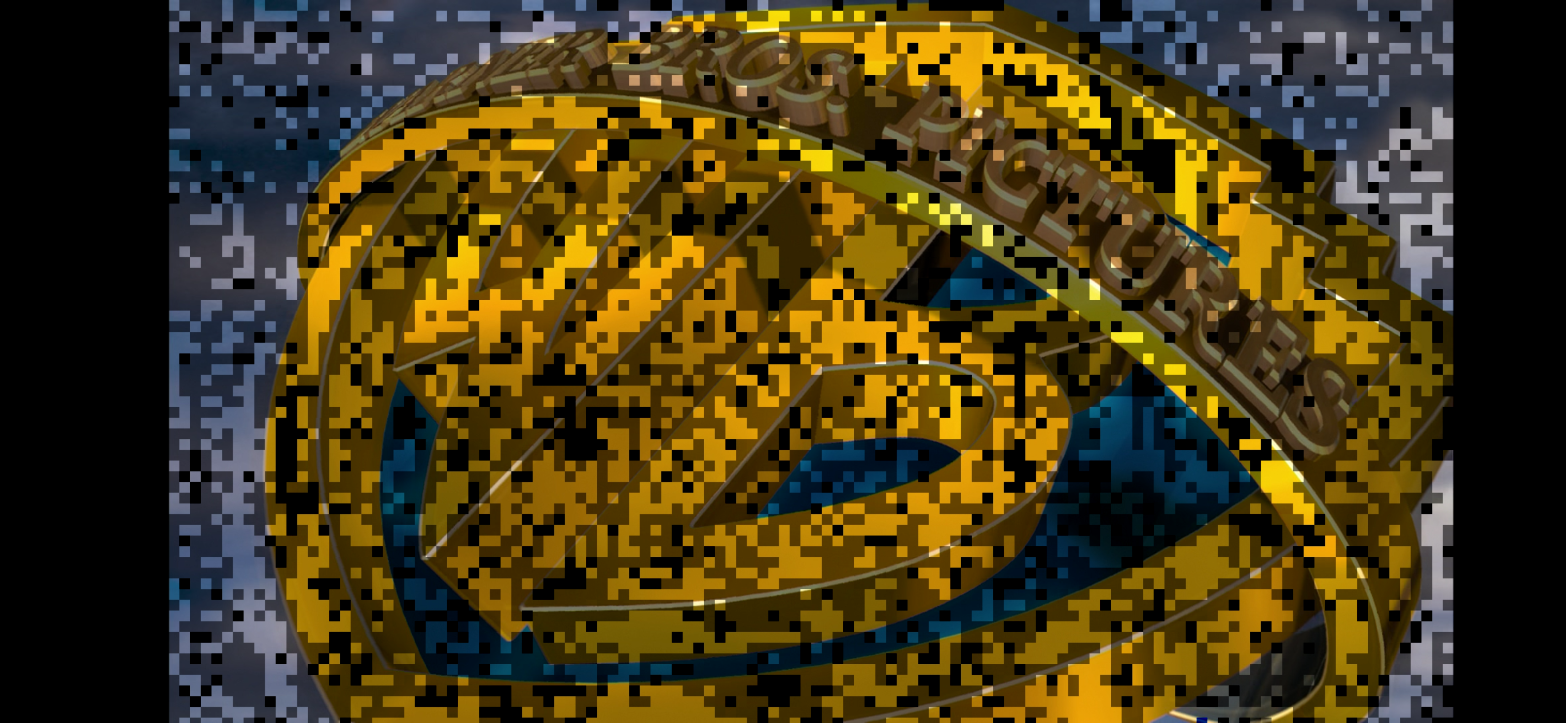

Grzegorz93 1 Posted August 26, 2025 Posted August 26, 2025 Hi. I've noticed that with the VC-1 codec, graphical artifacts occur at higher bitrates than the video supports. If the video has a bitrate of 20 and I force a higher bitrate than the original, the image flickers (pixelated), as shown in the photo. I switched from Jellyfin and the problem disappeared. Why? How can I fix it?

Luke 42241 Posted August 31, 2025 Posted August 31, 2025 VC1 is an extremely demanding codec. If your device doesn't have built-in hardware decoding for it, then I would not expect it to play very well.
Grzegorz93 1 Posted September 1, 2025 Author Posted September 1, 2025 I understand, but why does this error appear in Emby and not in Jellyfin?
Luke 42241 Posted September 6, 2025 Posted September 6, 2025 On 9/1/2025 at 1:34 AM, Grzegorz93 said: I understand, but why does this error appear in Emby and not in Jellyfin? It could be that they are not even trying to direct play and just going right to server transcoding. This is the most likely answer. What we generally do is try to play with software decoding on the device. You can make Emby operate the same way as the other app by going into playback settings and forcing a conversion for VC1. Then all VC1 will be transcoded by the server. Please let us know if this helps. Thanks.
