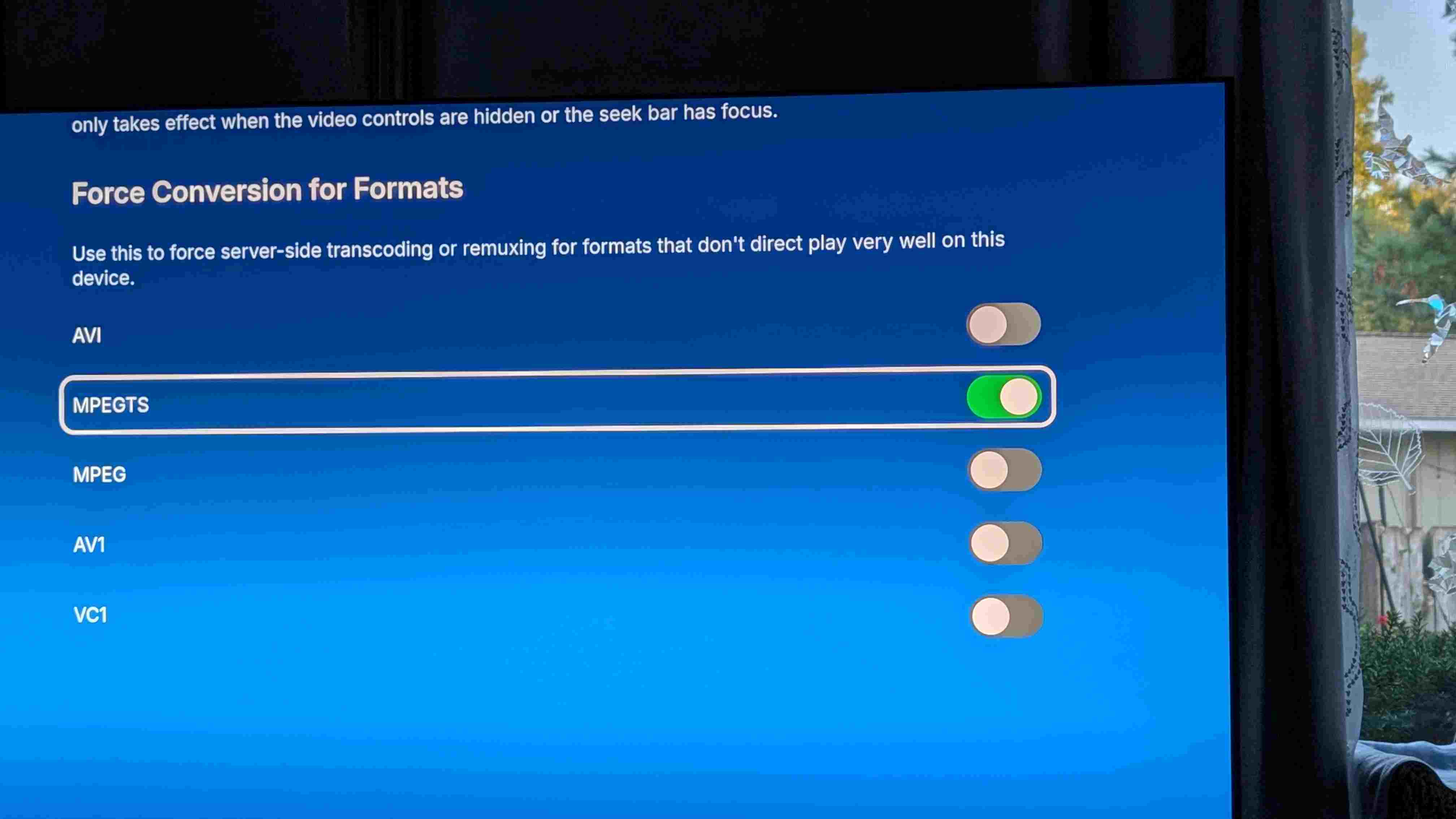

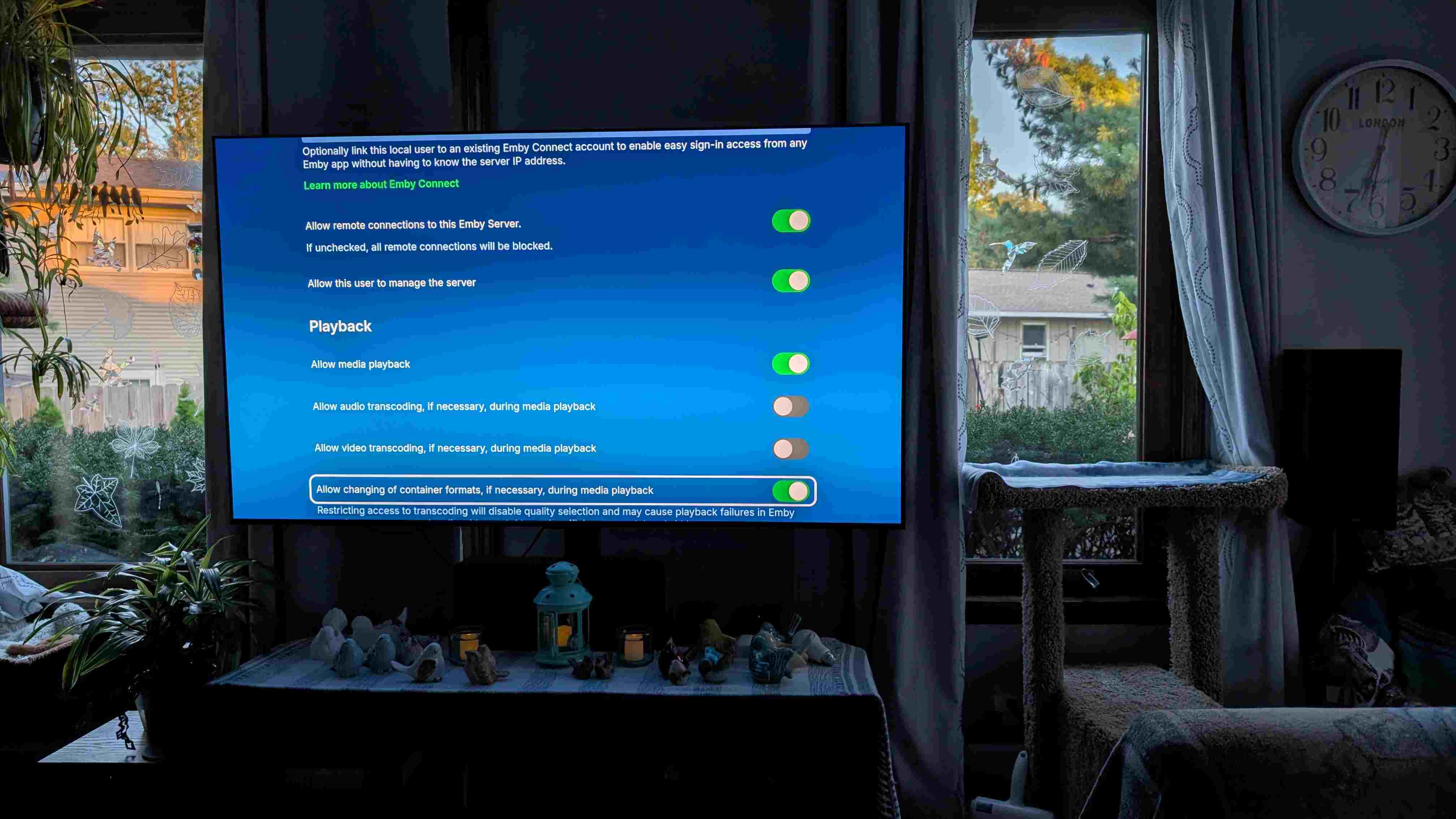

Using the Universal Android client. I have problems getting the closed captions (subtitles) to display on Live TV.  I have an HDHomerun tuner.  when using the universal client, I have to turn on force Conversion for formats mpegts to be able to fast forward and rewind the live stream so emby does not transcode the stream, I also have to turn off the allow audio and video transcoding options.  If I don't do this, the video is transcoded and the quality is subpar since the video getds transcoded for some reason. The dashboard and info for nerds says the video is being transcoded.

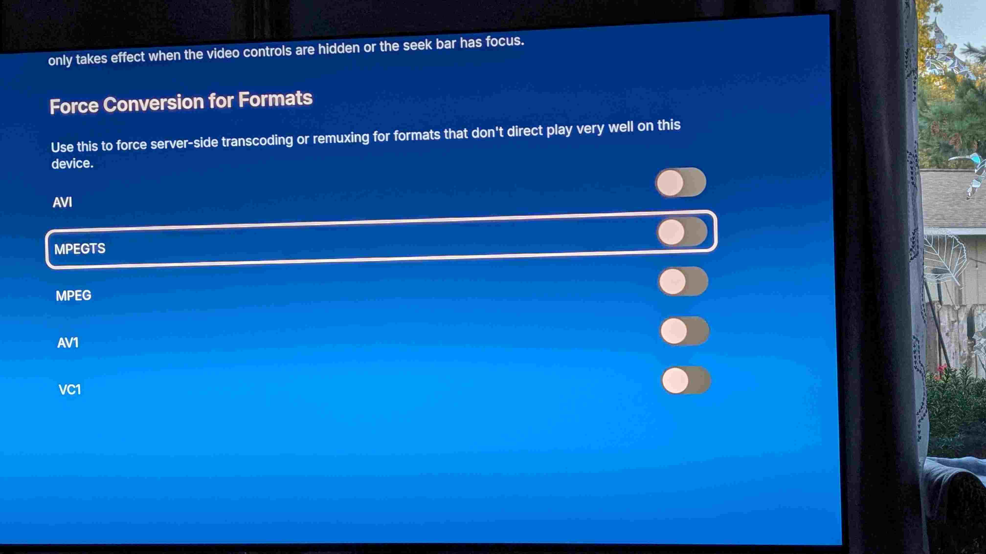

When watching a show and turn the CC on, the CCs don't display.  If I turn off the convert MPEGTS conversion, CCs display, but I am unable to rewind or fast forward.  RW and FF are more important the CCs, though we would like both.  On the old emby client 2.1.26a, CCs work as expected, though they appear more in the middle of the screen than at the bottom, but this may be because of images/crawls at the bottom.  Also on the old and new clients, when using Channels DVR as a tuner for Hulu (TVE) I can't get subtitles to work on either client. I get subtitles unable to load.  I can confirm there are subtitles when using Channels DVR client.  I would like to use Emby exclusively since I think the picture quality is better.  I would also like to use the Newer Universal client since it looks more polished and I believe that is where the development is. I've included screen shots and logs as well as an approximate timeline of what I did.

Turn off mpegts seek
6:29 start morning show
6:31 turn on cc - it works, but unable to ff and rewind
6:32 tried to rewind, failed
