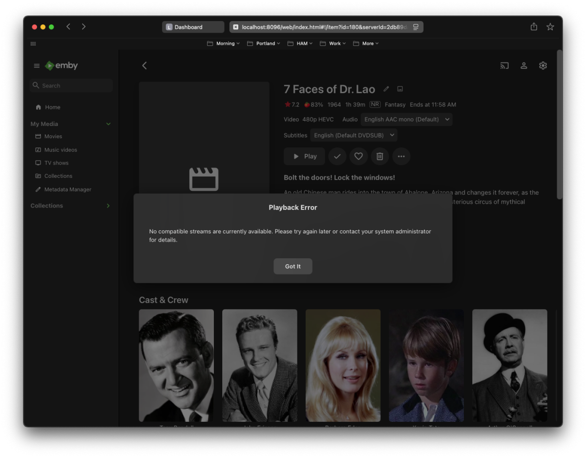

gregmote 2 Posted August 28, 2025 Author Posted August 28, 2025 I thought that local playback was working but it is not working either! Attached is the error message and the log files. ffmpeg-transcode-24ece3e8-e688-4127-8875-db6a56e24bb2_1.txt ffmpeg-transcode-778928ff-446e-4961-9edd-86fe2e9effa7_1.txt ffmpeg-transcode-e2a8869d-dac0-45db-8a1e-7f4120ca62ca_1.txt
Luke 42237 Posted September 1, 2025 Posted September 1, 2025 @gregmotedid you see this in the ffmpeg log? 20:47:36.077 /Volumes/Thanks/Movies/7 Faces Of Dr. Lao.m4v: No such file or directory Is your media storage volume offline?
gregmote 2 Posted September 1, 2025 Author Posted September 1, 2025 My media drive is online. But it appears that emby is looking for the drive my library was on long ago. It is pulling the meta data from the correct place, I think. I’ll have to check if more recently added media is looking at the current drive. Any idea how to tell Emmy to stop looking there? I am planning to move this to a NAS next year so this issue might appear or be fixed…
gregmote 2 Posted September 4, 2025 Author Posted September 4, 2025 Found the problem. I renamed the drive at some point and emby does not follow MacOS standards of using the reference not the name...Fixed.
Luke 42237 Posted September 4, 2025 Posted September 4, 2025 27 minutes ago, gregmote said: Found the problem. I renamed the drive at some point and emby does not follow MacOS standards of using the reference not the name...Fixed. HI, what do you mean by that? did the path to that file change to something new?
Luke 42237 Posted September 4, 2025 Posted September 4, 2025 Quote But it appears that emby is looking for the drive my library was on long ago. When you made the change, did you update Emby library setup?
gregmote 2 Posted September 4, 2025 Author Posted September 4, 2025 MacOS lets you name your drives. I changed the name of the drive containing my media files. I didn't realize the I had to go into the emby server and change the locations. That fixed viewing movies in the ember browser viewer on the server and my Apple TV. The emby app is still not working on any devices so I have more digging to do. Says it can't connect to the server. I will dive in on that issue when I have more time. Getting it working on the Apple TV is the main thing. 1

gregmote 2 Posted September 12, 2025 Author Posted September 12, 2025 I found that the drive my media is on was set to shared in Finder. When I unchecked that everything works everywhere! embyserver.txt 1
