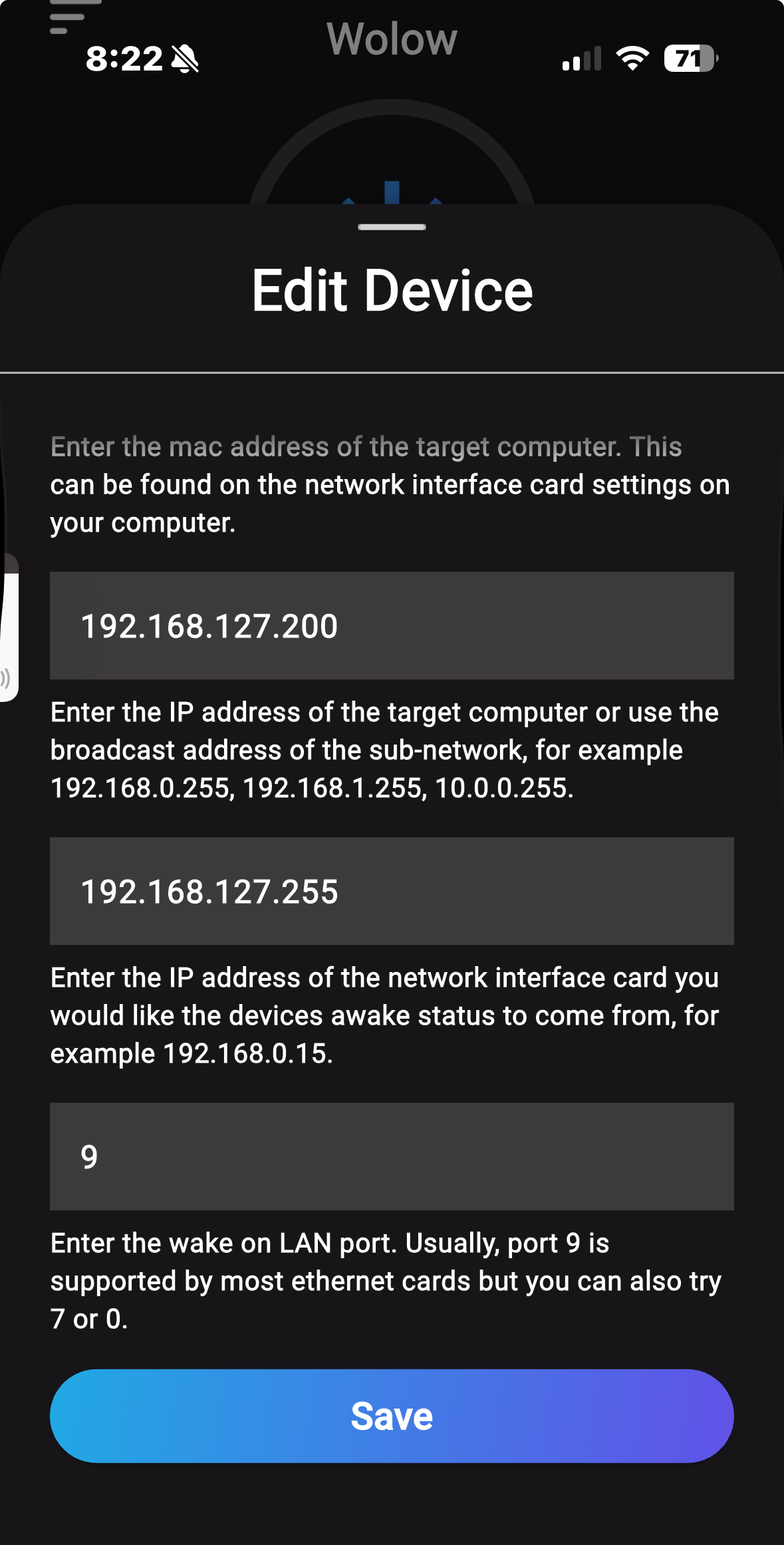

Tech127 20 Posted September 3, 2025 Author Posted September 3, 2025 I don't believe so. I just enabled it in bios and allowed it to the nic in windows. I can send a packet from the WoL ios app on port 9 and also from my Elan automation system on port 9. Both work. AFAIK, it's as simple, straightforward config as you can get. There are no funky router/firewall rules that would interfere either
Tech127 20 Posted September 3, 2025 Author Posted September 3, 2025 Here the config in my phone. I hid only the MAC address in this pic

sa2000 689 Posted September 3, 2025 Posted September 3, 2025 12 hours ago, Luke said: are you able to reproduce? Yes 12 hours ago, Luke said: Currently the apps broadcast it to 255.255.255.255, port 9 Yes - for some reason this does not wake the server up but the same packet to 192.168.1.255 does The wolow iOS app sends the WOL packet for port 9 to 192.168.1.255 and that works ok and wakes up Emby Server. There was one WOL packet from wolow ios app that did not wake the server. The Emby for iOS app sends the same WOL packet for port 9 to 255.255.255.255 and that does not appear to do the wake up Tests Logged server activity 2025-09-03 15:42:39.019 Info HttpClient: Http response 200 from http://192.168.1.235:9197/AVTransport_1.xml after 43ms 2025-09-03 15:51:28.764 Debug UserViewsService-0HNFAT1EBDU1O:00000001: http/1.1 GET http://192.168.1.173:8096/emby/Users/xxxxxx and the WOL packets Emby for iOS - did not wake the server 2722 2025-09-03 15:47:57.582699 0.000000 192.168.1.225 64072 255.255.255.255 9 DISCARD 144 Discard ffffffffffff207bd26d4ce9207bd26d4ce9207bd26d4ce9207bd26d4ce9207bd26d4ce9207bd26d4ce9207bd26d4ce9207bd26d4ce9207bd26d4ce9207bd26d4ce9207bd26d4ce9207bd26d4ce9207bd26d4ce9207bd26d4ce9207bd26d4ce9207bd26d4ce9 Wolow iOS app - did wake the server 22222 2025-09-03 15:51:27.638772 210.056073 192.168.1.225 64861 192.168.1.255 9 DISCARD 144 Discard ffffffffffff207bd26d4ce9207bd26d4ce9207bd26d4ce9207bd26d4ce9207bd26d4ce9207bd26d4ce9207bd26d4ce9207bd26d4ce9207bd26d4ce9207bd26d4ce9207bd26d4ce9207bd26d4ce9207bd26d4ce9207bd26d4ce9207bd26d4ce9207bd26d4ce9 and again emby server logged activity 2025-09-03 15:51:41.787 Error PortMapper: Error creating port map 2025-09-03 15:56:13.860 Debug SyncService-0HNFAT1EBDU2U:00000001: http/1.1 GET http://192.168.1.173:8096/emby/Sync/Items/Ready?TargetId= Test from Emby for iOS Emby for iOS - did not wake the server 31902 2025-09-03 15:55:10.360743 222.721971 192.168.1.225 53844 255.255.255.255 9 DISCARD 144 Discard ffffffffffff207bd26d4ce9207bd26d4ce9207bd26d4ce9207bd26d4ce9207bd26d4ce9207bd26d4ce9207bd26d4ce9207bd26d4ce9207bd26d4ce9207bd26d4ce9207bd26d4ce9207bd26d4ce9207bd26d4ce9207bd26d4ce9207bd26d4ce9207bd26d4ce9 Server woke up by moving mouse in this case and next tests Emby Server logged activity 2025-09-03 16:01:20.330 Debug UserService-0HNFAT1EBDU3E:00000001: http/1.1 Response 200 to 192.168.1.225. Time: 16ms. GET http://192.168.1.173:8096/emby/Users/xxxxxx 2025-09-03 16:04:43.243 Debug LiveTvService-0HNFAT1EBDU3F:00000001: http/1.1 GET http://dell-inspiron14:8096/emby/LiveTv/Channels?userId=xxxxxx and tests - first from wolow app did not succeed Emby for iOS - did not wake the server 69378 2025-09-03 16:01:36.645072 386.284329 192.168.1.225 64210 255.255.255.255 9 DISCARD 144 Discard ffffffffffff207bd26d4ce9207bd26d4ce9207bd26d4ce9207bd26d4ce9207bd26d4ce9207bd26d4ce9207bd26d4ce9207bd26d4ce9207bd26d4ce9207bd26d4ce9207bd26d4ce9207bd26d4ce9207bd26d4ce9207bd26d4ce9207bd26d4ce9207bd26d4ce9 Wolow iOS app - did not wake the server 74404 2025-09-03 16:03:26.940901 110.295829 192.168.1.225 61742 192.168.1.255 9 DISCARD 144 Discard ffffffffffff207bd26d4ce9207bd26d4ce9207bd26d4ce9207bd26d4ce9207bd26d4ce9207bd26d4ce9207bd26d4ce9207bd26d4ce9207bd26d4ce9207bd26d4ce9207bd26d4ce9207bd26d4ce9207bd26d4ce9207bd26d4ce9207bd26d4ce9207bd26d4ce9 Wolow iOS app - did wake the server 76974 2025-09-03 16:04:38.667675 71.726774 192.168.1.225 57403 192.168.1.255 9 DISCARD 144 Discard ffffffffffff207bd26d4ce9207bd26d4ce9207bd26d4ce9207bd26d4ce9207bd26d4ce9207bd26d4ce9207bd26d4ce9207bd26d4ce9207bd26d4ce9207bd26d4ce9207bd26d4ce9207bd26d4ce9207bd26d4ce9207bd26d4ce9207bd26d4ce9207bd26d4ce9 Disabling windows firewall for this last test had no impact
sa2000 689 Posted September 3, 2025 Posted September 3, 2025 The fact that I saw this broadcast to 255.255.255.255 in wireshark on another laptop means the router is not blocking the packet. Maybe windows silently discards it without logging it in firewall log - it is afterall referred to as a WAN broadcast because of the 255.255.255.255 address Might be the NIC discarding the WAN broadcast packets?
