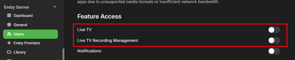

Neminem 1620 Posted August 25, 2025 Posted August 25, 2025 What happens if you turn off this on your user ? When deleting the tv tuner did you also delete the Guide data source ?
Dickydodah! 154 Posted August 25, 2025 Author Posted August 25, 2025 Live TV is turned off for all users and the Guide data was deleted. Even on a system that has never had Live TV ctrl-g brings up an empty TV guide. In the Web gui it's not really an issue as no one is going to accidently use ctrl-g but on the Samsung TV the channel button isreally easy to press by accident.
