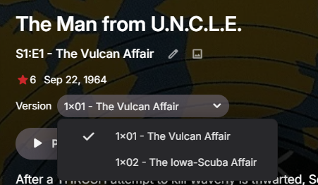

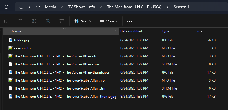

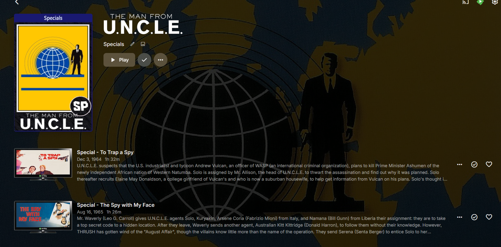

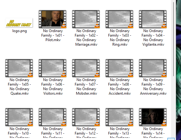

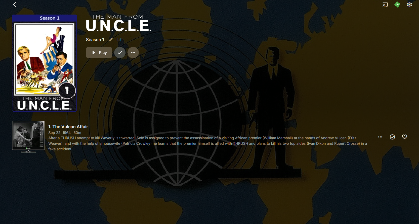

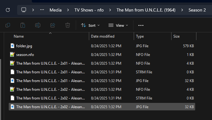

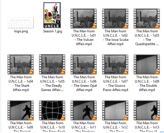

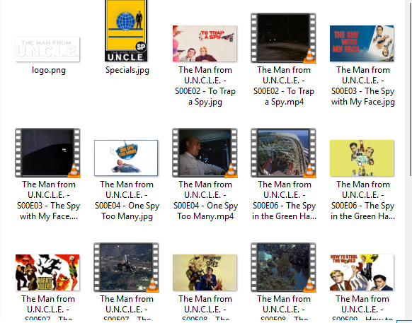

chrisrobbins1970 82 Posted August 24, 2025 Posted August 24, 2025 The Man from U.N.C.L.E., The (1964) - https://thetvdb.com/series/the-man-from-u-n-c-l-e For some reason Emby is not picking up the naming conversion for The Man From Uncle (1964) tv series correctly... This is from the webUI... As you can see each season shows only ONE episode.. Here is the naming structure I have been using for ALL my tv series; with NO issues... Now in order for the specials to get named corrected in Emby I had to do this naming structure manually ... I have removed the whole tv series folder; did a re-scan..added back in did a re-scan..same issue.. then I removed the whole folder and restarted the server; same results.. Here is an example of another tv series with the same name structure... Any idea what is going on... I am using Filebot to bulk rename tv series...

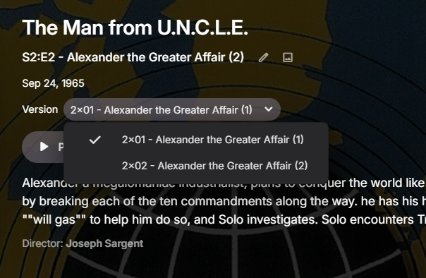

GrimReaper 4927 Posted August 24, 2025 Posted August 24, 2025 Had a similar issue the other day, I believe underlying cause is the same: Rename those SxE parts to some other naming scheme of your preference, like SxxEyy (S01E01 instead of 1x01 etc.), so that part "...E. - 1..." doesn't break parser. 1
speechles 2062 Posted August 24, 2025 Posted August 24, 2025 If you click into that episode is it showing several versions? Like all episodes are gathered under versions for the single episode?

chrisrobbins1970 82 Posted August 24, 2025 Author Posted August 24, 2025 UPDATE: made a change to the naming structure to The Man from U.N.C.L.E. - S01E01 - The Vulcan Affair..now all episodes are showing up.. so just for a random search..some of my tv series now have NO metadata in emby, when they did before...
Happy2Play 9814 Posted August 24, 2025 Posted August 24, 2025 15 minutes ago, chrisrobbins1970 said: nope..no different versions... something with Emby and naming structure as changed all of a sudden for me. Multi-versioning happens in my test per linked topic. But looks like renaming/different naming scheme is required here as you have already done. @Luke

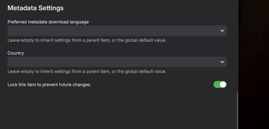

chrisrobbins1970 82 Posted August 24, 2025 Author Posted August 24, 2025 UPDATE:....ok weird one... NO metadata...Looked at the metadata..and all were locked..I didn't lock them... Unlocked and did a re-scan..now metadata is back...
Luke 42289 Posted August 24, 2025 Posted August 24, 2025 You may have locked it a long time ago and then forgotten about it. It happens.
