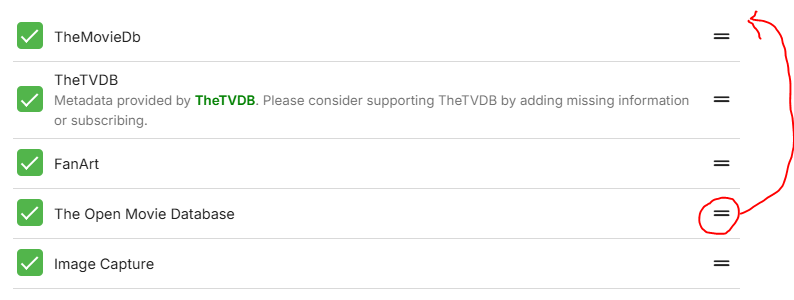

brothom 211 Posted August 25, 2025 Posted August 25, 2025 2 hours ago, Zealot said: Thanks for replying. I would guess that the Anime plug-in is first in order since it is listed first. How do I change that? I didn't see anything in the settings to change the fetcher order. As far as benefits, I just wanted more complete metadata. I figured if someone went to the trouble to create a plug in that the regular sources weren't that good. I appreciate the help. Regards, Simon ' Via the Emby Server settings -> Libraries -> Select your Library and scroll to "Metadata downloads" you should be able to use the "handle" to sort a download above or below others. For example if I wanted to move "The Open Movie Database" to the first position, I would use the handle and drag it above "TheMovieDB".

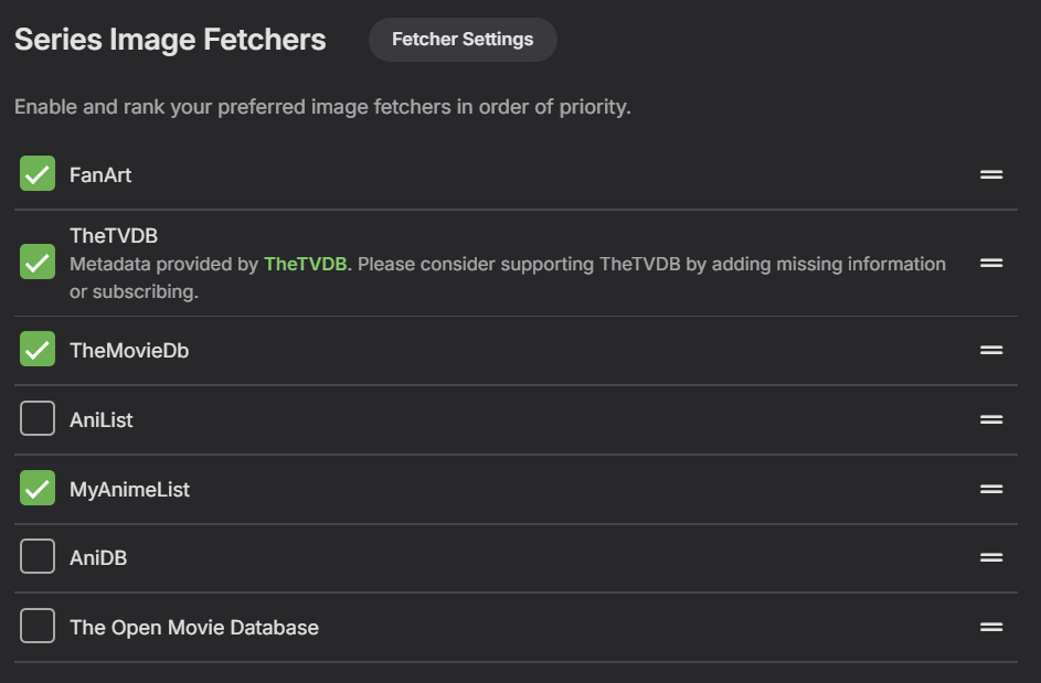

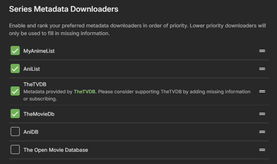

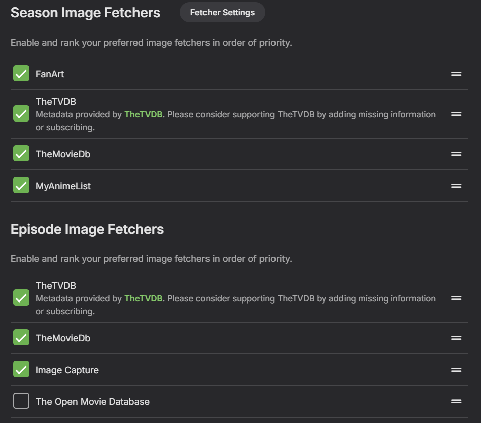

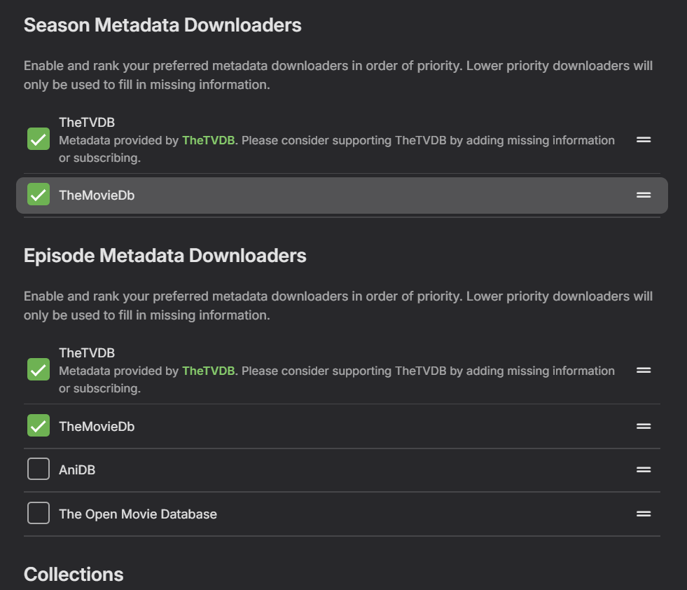

evil_crab 23 Posted August 26, 2025 Posted August 26, 2025 (edited) Here's my metadata fetcher setup for the anime library, except for a couple of weird cases (cough cough Monogatari cough) it works well. I had some issues with MAL and AniList fetcher reliability, but I was able to fix them, and I think Luke merged all my changes a while ago, so the published plugins should have them. A couple of tips: Activate Allow adult metadata for the library. On MAL some shows are incorrectly marked as NSFW and the plugin won't fetch their metadata without this setting Add MAL API key to the plugin. This way it'll use the API instead of ripping the data from the web pages. I also disabled Download character metadata option for the AniList plugin, but it's a matter of preference Edited August 26, 2025 by evil_crab
