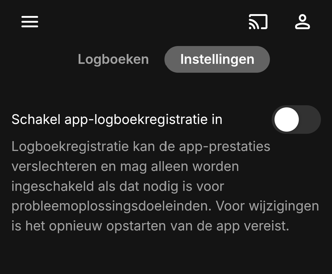

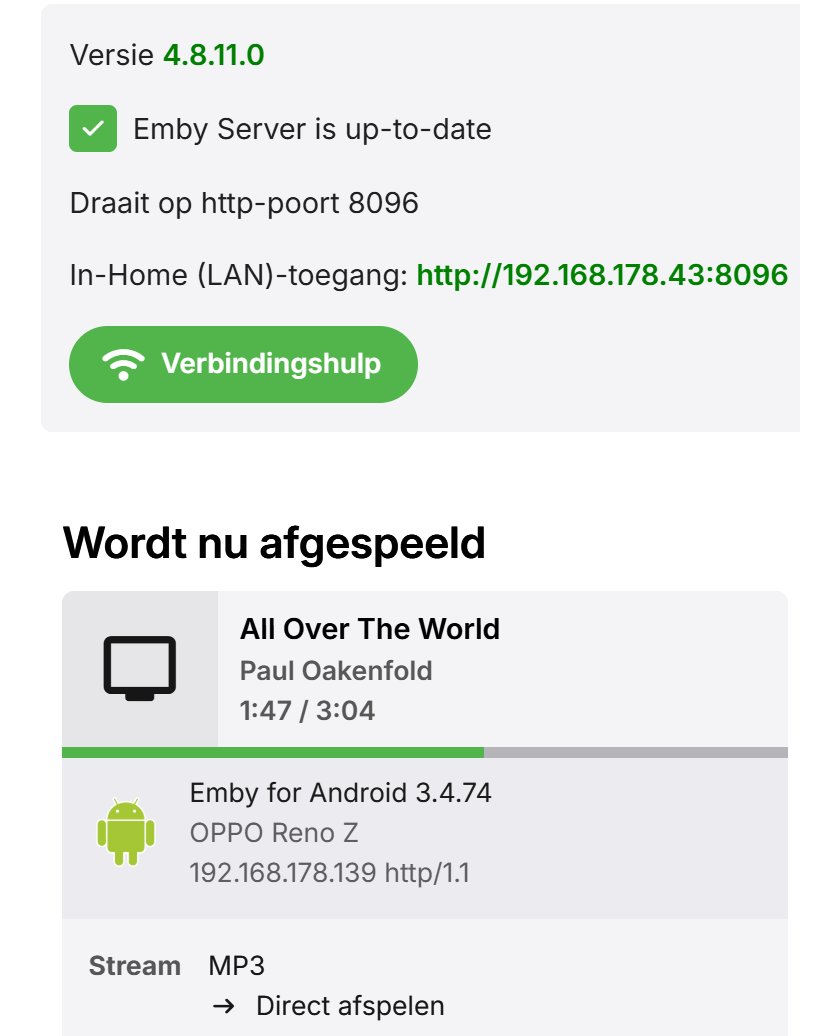

Davey's 40 Posted August 23, 2025 Author Posted August 23, 2025 (edited) Many thanks Neminem, it still plays fine on the other device, but on my device I really can't do anything with it anymore. I will also add the logs here. (I don't know how I can view the logs from an Android device, so I grabbed them from the Synology-server) embyserver.txtffmpeg-transcode-644cef30-4ff6-4924-9e28-2a5521737486_1.txt edit: another typo Edited August 23, 2025 by Davey's
Neminem 1623 Posted August 23, 2025 Posted August 23, 2025 I think its described here, how to send logs from android, Its near the bottom.
Davey's 40 Posted August 23, 2025 Author Posted August 23, 2025 (edited) Thanks, I'll wait and see if this is enough. While I was talking to you, I was trying to play a YouTube-rip of 'Fien and Teun' for my son (because I couldn't control it anymore, this didn't work either). After describing this problem in the community, I wanted to stop the playlist and swiped away the Android app(so its close) on the other Android device. At that moment, Fien and Teun suddenly started playing on the device.?? Edited August 23, 2025 by Davey's Ugggh
Davey's 40 Posted August 23, 2025 Author Posted August 23, 2025 Okay, I checked both Android devices. The Oppo RenoZ (slave) had disabled logs, so I could only access the logs on the Oppo Findx5 (master). emby_android_1755953102173.txtemby_android_1755951916259.txtemby_android_1755951647100.txtemby_android_1755950669389.txt (Oppo Reno Z) 1

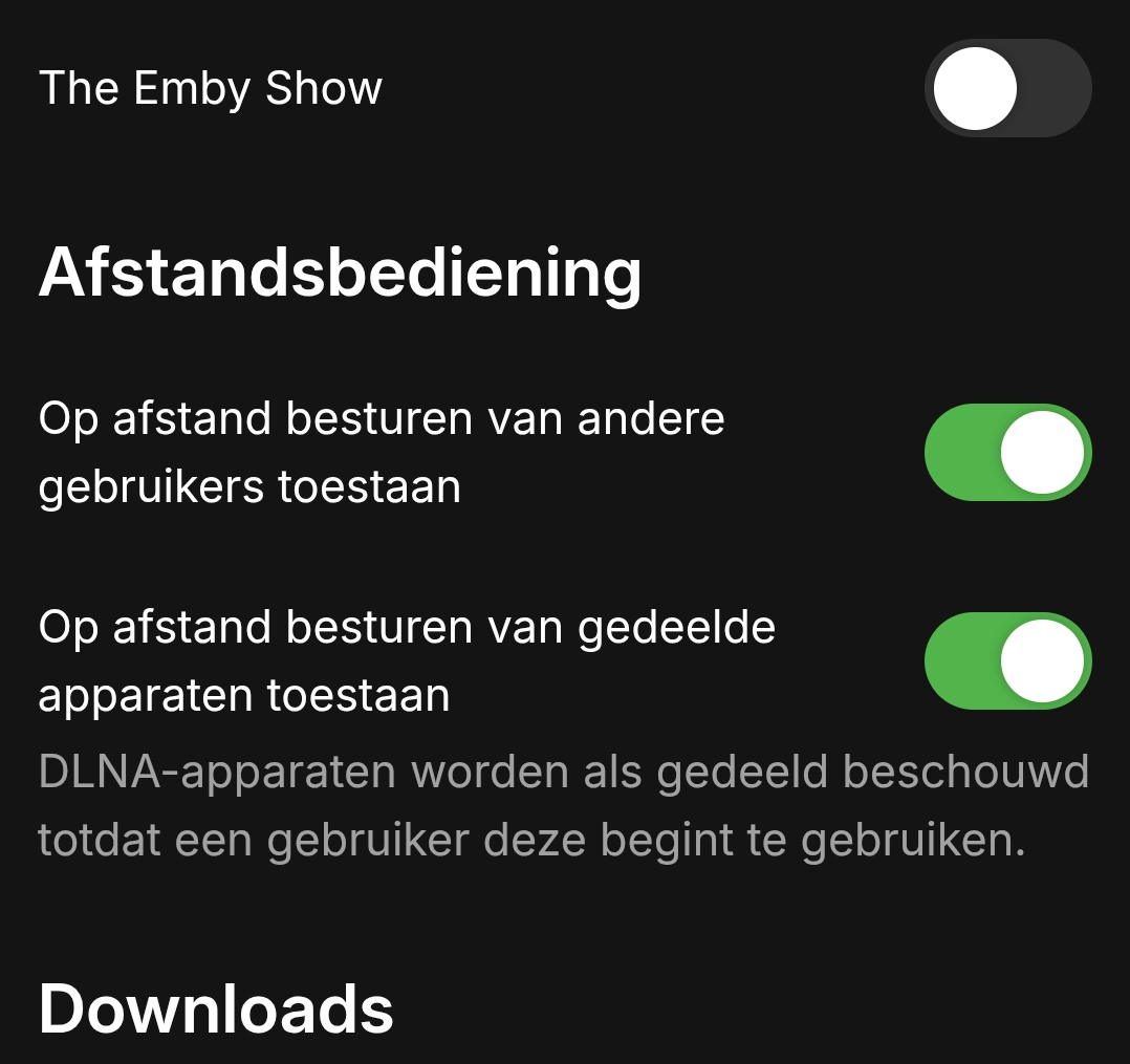

Luke 42241 Posted September 7, 2025 Posted September 7, 2025 4 hours ago, Davey's said: Under DLNA, DLNA "Play To" is enabled. I checked the remote control permissions earlier, and they were enabled. However, I want to check again now, and strangely enough, I can't find them anymore. Where can I find the options for remote control permissions? Click on a user in emby user setup, then scroll down to the Remote Control section.
Davey's 40 Posted September 7, 2025 Author Posted September 7, 2025 1 hour ago, Luke said: Click on a user in emby user setup, then scroll down to the Remote Control section. Its both enabled
