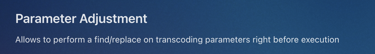

TurkeyMan 17 Posted August 23, 2025 Author Posted August 23, 2025 Here's a crazy thought; maybe add an experiment mode to the client, like right beside stats for nerds add an item which shows a text box pre-populated with the ffmpeg command line in use, and allow the user to edit it and restart the stream with the user edits? Then we can dick around it with and help fine-tune the flags for various devices? At very least, maybe add the ffmpeg command to the stats-for-nerds text? I'd be interested to know precisely what ffmpeg is doing at any given time. Might help debug or offer better bug reports from time to time.
SamES 1084 Posted August 23, 2025 Posted August 23, 2025 8 minutes ago, TurkeyMan said: Here's a crazy thought; maybe add an experiment mode to the client, like right beside stats for nerds add an item which shows a text box pre-populated with the ffmpeg command line in use, and allow the user to edit it and restart the stream with the user edits? Then we can dick around it with and help fine-tune the flags for various devices? At very least, maybe add the ffmpeg command to the stats-for-nerds text? I'd be interested to know precisely what ffmpeg is doing at any given time. Might help debug or offer better bug reports from time to time. Have you looked in the ffmpeg logs?
