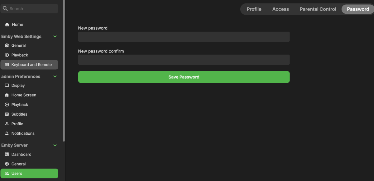

AndreiP 33 Posted August 22, 2025 Author Posted August 22, 2025 Q-Droid and Neminem, thank you very much! Could I ask you two questions, please: 1. Can I add/change the password from here using the mange Emby server? (Please check my screenshot). 2. If I add/change a password, will the user be able to connect to the server as before (with Emby Connect)? Or will they have to enter the password they connect the first time after changing the password? (or only the first time). They watch on TV and phones usually.

Neminem 1591 Posted August 22, 2025 Posted August 22, 2025 (edited) The password is for your local server. Thats how they / that got in, circumventing Emby Connect. Emby connect uses the forum credentials. Edited August 22, 2025 by Neminem 1
AndreiP 33 Posted August 22, 2025 Author Posted August 22, 2025 Quote 1. Can I add/change the password from here using the mange Emby server? (Please check my screenshot). So, it's possible to ad or change password from this page also?
Neminem 1591 Posted August 22, 2025 Posted August 22, 2025 (edited) 2 minutes ago, AndreiP said: So, it's possible to ad or change password from this page also? You need to elaborate no this page ? Emby Server : Only the local password.. Emby Forum : Emby connect password is changed via this forum. But only by the user. Edited August 22, 2025 by Neminem
AndreiP 33 Posted August 22, 2025 Author Posted August 22, 2025 (edited) Quote Only the local password.. Emby connect password is changed via this forum. Yes, I understand. In my case I mean I can add here the password for all my users to avoid this kind of situation, right? Edited August 22, 2025 by AndreiP

Solution AndreiP 33 Posted August 22, 2025 Author Solution Posted August 22, 2025 (edited) For other users who have the same problem. Q-Droid and Neminem found the solution. I will resume here in this post what to do. 1. Set a password for all users, even if they use Emby Connect. 2. Put this in your users' profile settings. And please also check the post above of Q-Droid about "General good practices for securing your Emby server". Quote I've posted this before, adding here for reference. General good practices for securing your Emby server. 1. Enable TLS/HTTPS 2. Use a reverse proxy if you can and know how to do it. If you don't know how look into Caddy and use a reverse proxy. 3. Force all users to have passwords. 4. Don't allow remote access for Admin accounts. If you do then make sure the passwords are strong. 5. Don't show users on the remote login page. 6. Don't show admin users on any login page. 7. Don't use the name Admin for your main admin user. Edited August 22, 2025 by AndreiP 1

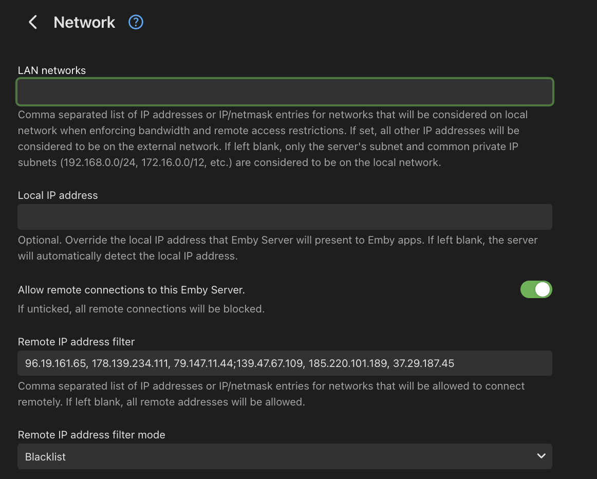

DarkStar1977 120 Posted September 20, 2025 Posted September 20, 2025 Additionally you can blacklist the IP that have been used to connect with all your users into your server, i'ts not a great solution but at least you will be sure from this IP they will never access again: In my case I've blacklisted all IP's that tried to access my server even they did not get access 1
