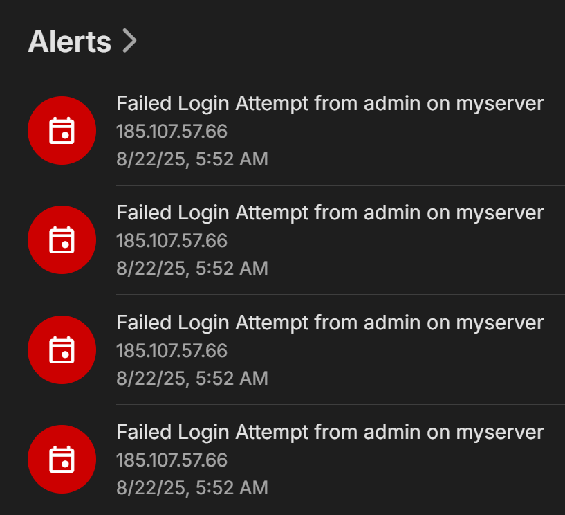

AndreiP 33 Posted August 22, 2025 Posted August 22, 2025 (edited) Hi, Please help! A very strange situation has occurred on my server: I just noticed in the activities section that ALL my users logged in to the server from the Edge browser simultaneously. There are also some failed logins in the admin account. I'm attaching screenshots. I'm very worried because I understand that this is impossible, so it seems as if some automated software has managed to hack all the passwords at once... I checked the connection IP address that appears: it's the same and from the Netherlands (?). My users are not located in this country. I attach the log files, please check. My server it's not a remote one: it's located in my apartment. Shoul I change the passwords for all my users? embyserver.txt Edited August 22, 2025 by AndreiP

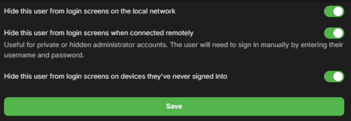

Neminem 1630 Posted August 22, 2025 Posted August 22, 2025 Also for good measure check your router and disable upnp. If that plugin is enabled in Emby, and uninstall it. Change your admin user to a new admin account without remote access enabled. The new admin account should not indicate that its an admin account. also enable all the below, since that would be shown to anyone coming across emby login page. 1

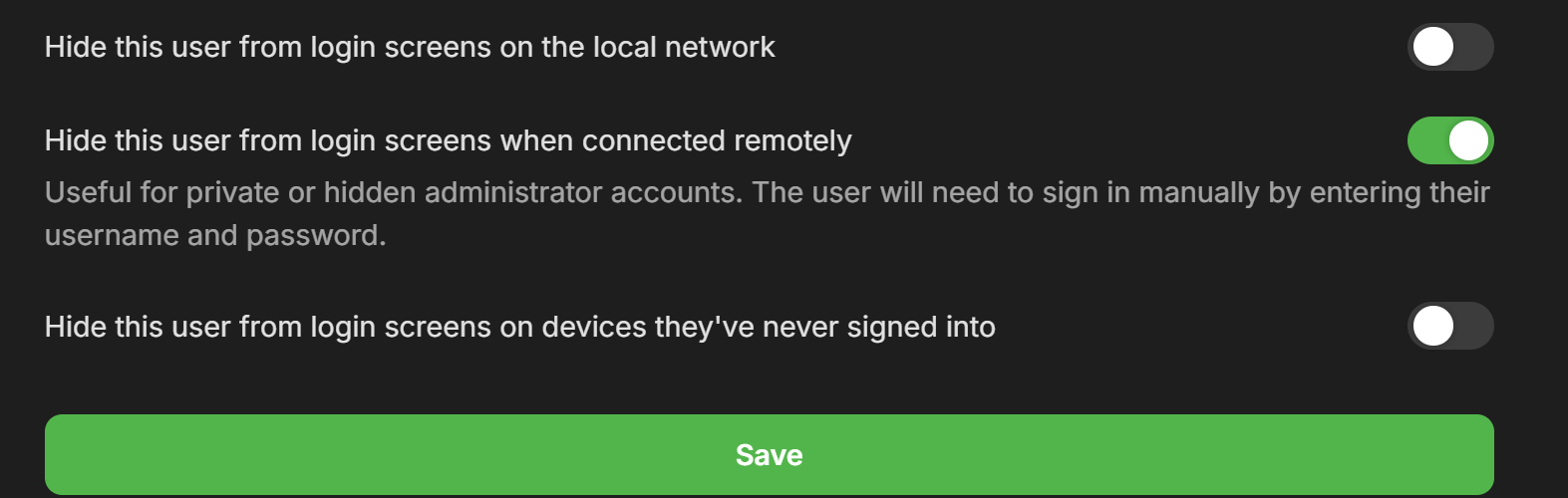

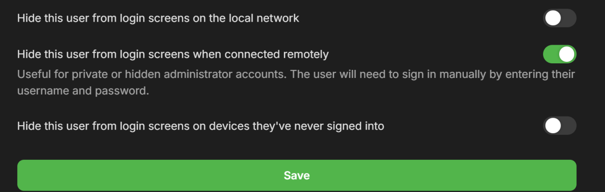

AndreiP 33 Posted August 22, 2025 Author Posted August 22, 2025 Hi Luke, All my users use Emby connect. And I have this configuration for show/hide on login screens.

AndreiP 33 Posted August 22, 2025 Author Posted August 22, 2025 Neminem, I should enable all that as the screenshot in your post for all my users and for the admin account also?

Neminem 1630 Posted August 22, 2025 Posted August 22, 2025 1 minute ago, AndreiP said: Q-Droid, my users use Emby connect. But I see no password on the user column except the admin account. It's normal? I thought using Emby connect automatically meant the user had a password. Ok so if some script kiddy found your IP and usernames from login screens, then there is no Password. Because they did not use emby connect. 1
AndreiP 33 Posted August 22, 2025 Author Posted August 22, 2025 (edited) Thank you, Neminem. If I understgand well, I should change as you post it for all my users? Edited August 22, 2025 by AndreiP 1
