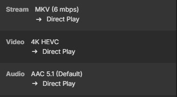

godvadr 0 Posted August 22, 2025 Author Posted August 22, 2025 8 minutes ago, brothom said: Ah no worries! That doesn't change the situation fortunately. If Direct Play is enabled and the device is still stuttering there still might be multiple reasons. Can you provide info about the item and the device you're trying to play? For example "4K HEVC Profile 10 on a Chrome Browser of HP laptop etc". Sure, ill do my best So right now i just started a movie in: Stream MKV (9 mbps) Direct play Video 1080p H264 Direct play Audio German AC3 5.1 (Standard) Direct play Watching on iOS App but excatly same happens on Apple TV App. Another example: Stream MKV (16 mbps) Direct play Video 4K HDR 10 HEVC Direct play Audio German AC3 2.1 (Standard) Direct play
