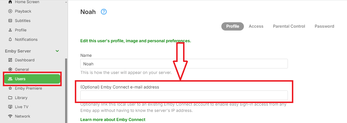

GrimReaper 4895 Posted August 20, 2025 Posted August 20, 2025 You need to create local user for her. Afterwards link that user to her connect address. Emby Connect
clarkss12 304 Posted August 20, 2025 Author Posted August 20, 2025 13 minutes ago, GrimReaper said: You need to create local user for her. Afterwards link that user to her connect address. Emby Connect I have read that over and over........... I don't know what "Afterwards link that user to her connect address" means......... How do I do that??? I go through this every year and end up using Plex......... Is there a video on how to do that???
GrimReaper 4895 Posted August 20, 2025 Posted August 20, 2025 4 minutes ago, clarkss12 said: I don't know what "Afterwards link that user to her connect address" means......... How do I do that??? Fill up this field with her Connect email address; she'll receive an email to that address to confirm link.

GrimReaper 4895 Posted August 21, 2025 Posted August 21, 2025 3 minutes ago, clarkss12 said: Where in the setup does it send an email??? 52 minutes ago, GrimReaper said: Fill up this field with her Connect email address; she'll receive an email to that address to confirm link.
clarkss12 304 Posted August 21, 2025 Author Posted August 21, 2025 I did add her email address to that box...... Don't know if she got an email. Where does it say to SEND an email??
GrimReaper 4895 Posted August 21, 2025 Posted August 21, 2025 (edited) 2 minutes ago, clarkss12 said: I did add her email address to that box...... Don't know if she got an email. Until she confirms that she did receive it and that she did confirm link within, she won't be able to connect through Connect. 2 minutes ago, clarkss12 said: Where does it say to SEND an email?? It is sent automatically once connect address is entered & saved server-side. Edited August 21, 2025 by GrimReaper

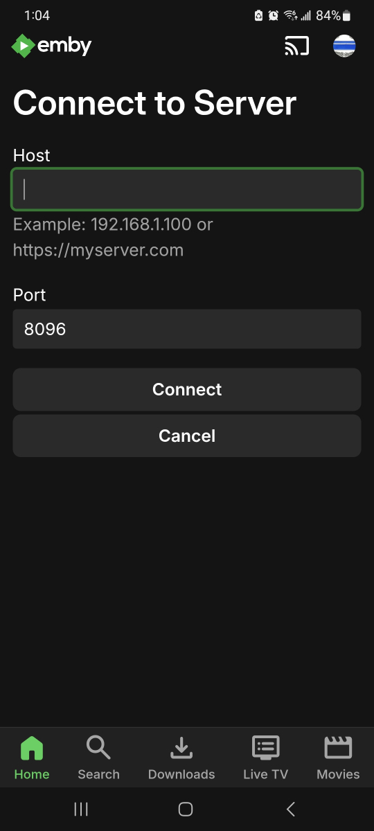

Luke 42239 Posted August 21, 2025 Posted August 21, 2025 11 minutes ago, clarkss12 said: What do I put into this box????? You really don't know your server address?
clarkss12 304 Posted August 21, 2025 Author Posted August 21, 2025 Just now, Luke said: You really don't know your server address? I am getting all confused. I guess I'm going to have to go to her house and try to set it up on her TV instead of trying to do it in my house.

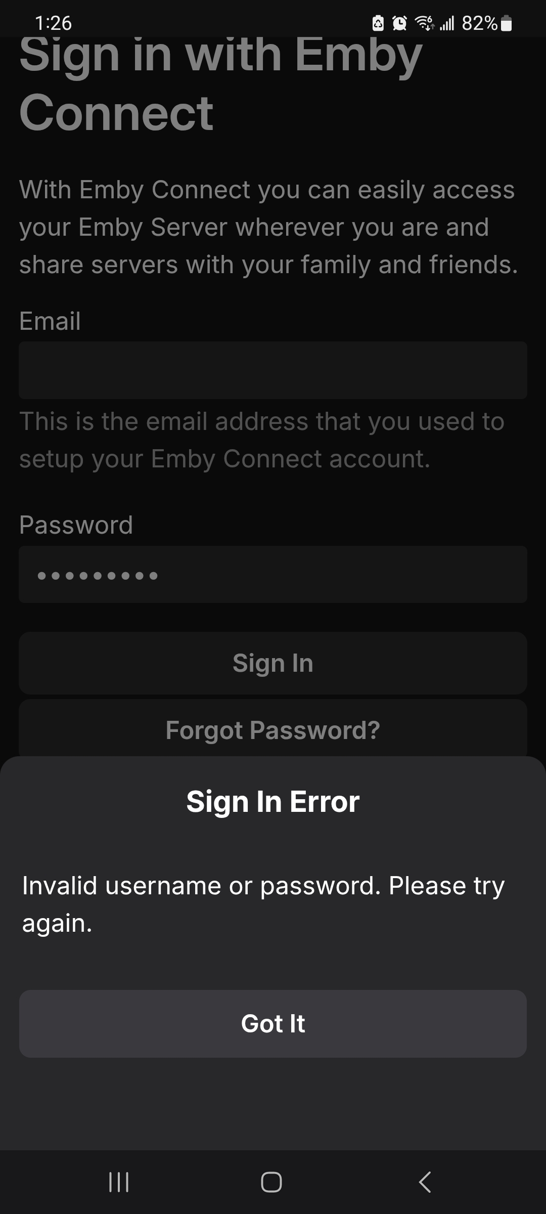

clarkss12 304 Posted August 21, 2025 Author Posted August 21, 2025 (edited) I can sign into Emby connect on my phone without any problems. I'm just not able to get her TV to connect to my server. I think she created an account but I cannot verify that. When I try to use Emby connect using her email address and password I just get an error message. The error message does not tell me anything. Edited August 21, 2025 by clarkss12
clarkss12 304 Posted August 21, 2025 Author Posted August 21, 2025 Now it's telling me invalid password or username
