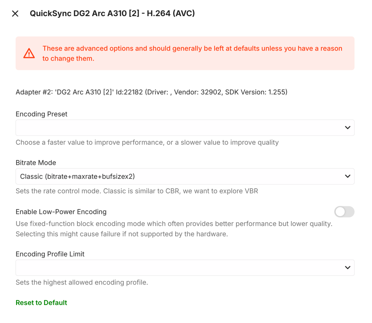

pear235 4 Posted August 20, 2025 Posted August 20, 2025 (edited) Hello, I'm having a weird issue playing 4k hdr files - namely, when i select the quality to auto (or any other above, in this case, 1080 30mbit), the file starts playing, then after 5 - 10 seconds it flashes to black, then the playback is stopped with "No compatible streams are currently available. Please try again later or contact your system administrator for details." This is on a local, wired, 1gbit connection so no network bottleneck. The same file plays completely fine on Plex and Jellyfin. Emby's running on lxc in Proxmox. Hardware - i5-14500 with 8GB ram and 6 cores, a310 used for transcoding. Same happens when using the igpu. Emby version 4.9.1.18 beta, but same happened with 4.8.10 an 4.8.11. I tried to test it using completely new installation, same behaviour. What i noticed is that when using Edge, this happens, whereas when using Firefox it doesn't - although then the tone mapping isn't working. Trying with Edge in safe mode, with all addons / plugins disabled doesn't help. With tone mapping completely disabled, the issue still remains. Any ideas? embyserver.txt ffmpeg-transcode-5a32a0ad-ab22-447a-bfc5-693c12b10f1b_1.txt ffmpeg-transcode-a102c447-9301-48ef-b7b5-77f12d1f586e_1.txt ffmpeg-transcode-ecd5ed8f-52e1-4c5a-8c02-d987e08bb33c_1.txt hardware_detection-63891271590.txt Edited August 20, 2025 by pear235

pear235 4 Posted August 20, 2025 Author Posted August 20, 2025 1 hour ago, Happy2Play said: No idea what parameter the other guys are using but Emby is taking that 26Mbps HEVC file and converting it into a almost 40Mbps H264. Also don't know how this affects it also. Yea i had it set in the H264 encoder settings : Still, after setting it back to default just now, transcoding still isn't working
