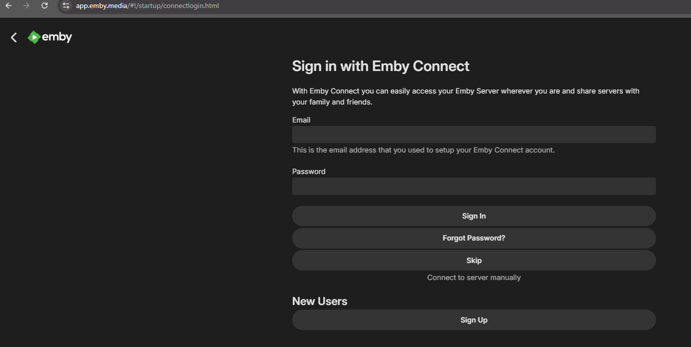

Osorus 18 Posted August 18, 2025 Posted August 18, 2025 (edited) hey all, i have new users attempting to log in with standard emby connect and getting denied saying wrong email/pw. they will use both the app and web based access to do a simple sign in. they will also change the pw and still get the same “wrong un/pw”. i had one user open a new emby connect account in front of me, verified the email, and it would not let them sign in on the app nor via web. i watched them change the pw and still no access. i have up to 4 users reporting this as the same issue. any help would be appreciated. thanks! Edited August 19, 2025 by Osorus
Luke 42239 Posted August 19, 2025 Posted August 19, 2025 HI, how exactly are they changing their password? When they sign in, what does the title of the login screen say? The most likely cause is they are confusing the difference between Emby Connect and your local server, and they are trying to use one set of credentials on the other's login screen.

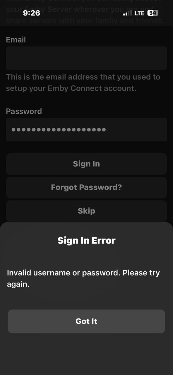

Osorus 18 Posted August 19, 2025 Author Posted August 19, 2025 (edited) I would love for it to be that simple. I troubleshot with one of the users in front of me. I specifically had them go to the correct login. They logged in, after I showed them how to look up the saved pw in Chrome. I then had them change the pw in front of me. They used said pw (confirmed correct), which resulted again with the second screenshot. Keep in mind that when the email and pw is applied, the error pops up, removing the email from the email field. Edited August 19, 2025 by Osorus

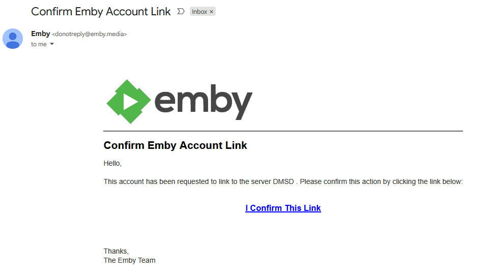

Osorus 18 Posted August 25, 2025 Author Posted August 25, 2025 So for one user, there is no validation email. If i add them to my server, they will get an email confirming access to the server. But a validation email is still missing from this and I was given access to the user's email so I can trust and verify the steps taken. I have checked everywhere, waited over 2 hours, and even did a search for "emby". There is only the email below sent. Is there a way to force send a validation email so this user can be whitelisted? Until that step happens, we cannot get them logged into Emby Connect.
